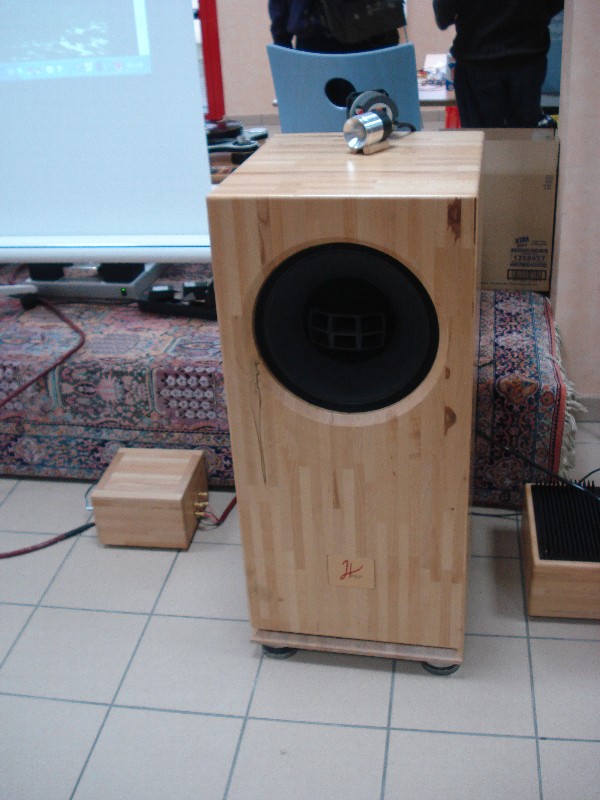

To illustrate MLTL cabinet size and shape......
Legendary Jean Hiraga displaying his Altec 604 MLTL speaker. Port air exits out of bottom slots.
Typo in my original note .... The ferrite magnet GPA Altec 604-8H III T/S parameters best match a transmission line with a 405sqin cross section. Jean Hiraga uses Alnico motor 604 speakers which have slightly different T/S matching a 419sqin line.
