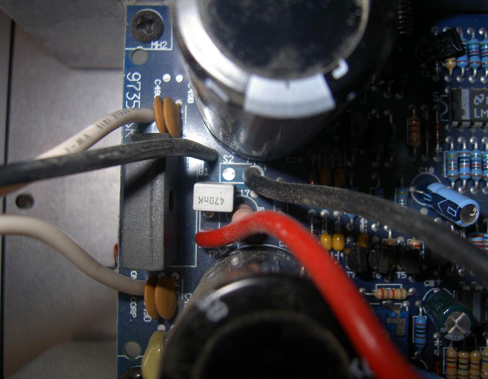

This is a 150 watt amp for an Energy powered tower speaker from about 8 years ago. I used to do all the Home Theater installs for the Good Guys in my area until they closed down, so they gave me all their remaining stock of replacement Energy, Polk, Klipsch and Monitor Audio drivers (about 400 total, let me know if you need something 🙂 ), as well as this replacement amp. I am not a person that has the kind of knowledge needed to know how to hook up this amp without frying it. I took it to a few places that sold electronics parts and they only gave me a few guesses that could still leave this thing smoking. I attatched a picture. I don't know how to put them in the actual post.
There are two white wires and a black wire together that go in near the two large caps. The two white wires have two tiny caps at each location where they meet the circuit board. The black wire goes in near the large caps. There is also a black and red pair that go in inbetween the two large caps. I am used to the black and red being for speaker cnnection, but some of the people I talked to said that isn't necessarily the case here. Any suggestions?

Your second picture is actually the same as the picture in the first post... you might want to retry posting it, or maybe edit it if you still have time.
I would say your instincts are correct and that the white and black are power wires and the red/black are speaker wires, although to make sure we'd need to see the whole board.

This is my suggestion:
The two white wires: AC from toroid
The black component between the white wires are the diodebridge.
The Black wire nearest the diodebridge: Ground for aux circuits
The red and black wire farest away from the bridge:
+ and - DC out for aux circuits
Hope this may be right 😉

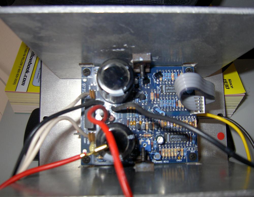

Sorry about that. Here is the whole board picture. Just to be clear, the red wire at bottom left is actually the connector end of the wire you see coming out of the board, so just ignore it.
I have to admit, it might be better if i ask how I should wire this amp to one of those female outlets you usually have on sub amps. The descriptions I read there don't tell me much, unfortunately, as they are not my language. If you could tell my which to connect where, that would be much better.
