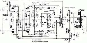

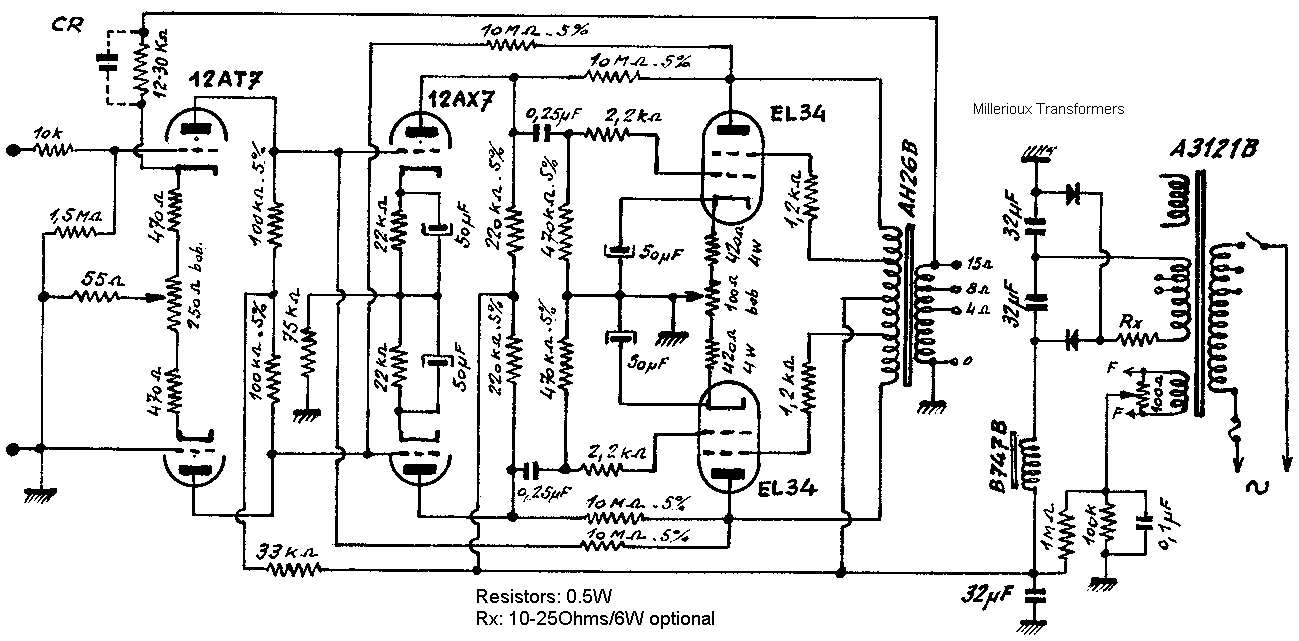

In AC terms it's not that great, I used a very similar circuit in the 1980s and 1990s except that the feedback was connected to the grid of the other tube in the LTP.
This isn't really an LTP give the very short tail resistance.
The basic topology when correctly implemented works extremely well and achieves good balance.
The Loyez phase inverter is a very interesting circuit from a historical perspective, these day, we would just slap on some solid-state CCS to force the balance and call it a day... but where is the fun in that? 🙂

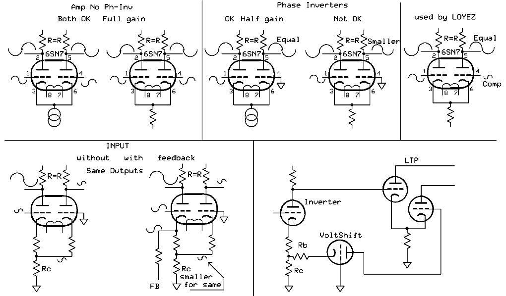

Let me explain how i see it works.With illustations ! 😎These equations are about the Loyez phase inverter.
Obviously, you don't understand how it works. <snip>
An out of balance concertina driving an out of balance LTP, compensating eachother.
You can adjust the balance with the feedback resistor but that changes the input level too.Adjustement are best made with Rc.

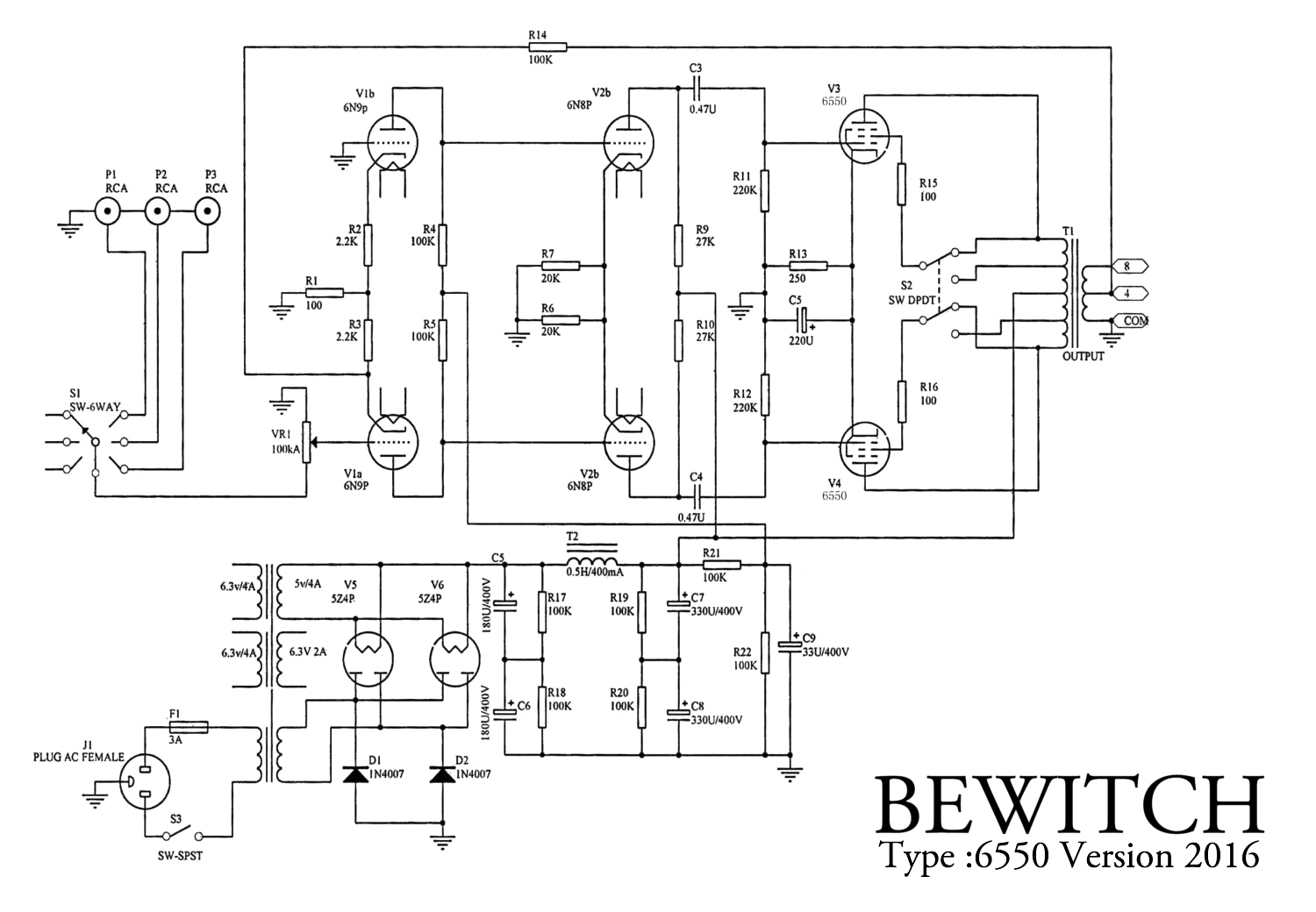

The bewitch amp can function with one triode less and an R-C coupling.
Mona
Mona
In the Loyez phase inverter, you have to consider that the return of the feedback is on the cathode of V1a (the lower triode).
Triode V1b is in grill commun mode, the input is the cathode.
It makes a negative feedback on V1a and a positive feedback on V1b.
So amplitude at the output of V1a at the plate is reduced and output amplitude of V1b at the plate is increased.
Level of feedback is correct when both amplitudes are balanced.
As already said (not by me but by Loyez) V2 triodes are not involved in the process.

No, the feedback comes inverted by V1a on one side of the LTP and via V1b, not inverted, on the other side of the LTP.Making it NFB in both cases.Mona

The feedback to the cathodes appears uninverted at both anodes of V1. However, as the two anodes have opposite signal polarities this is negative feedback for V1a and positive feedback for V1b.
Another way of looking at it is that the feedback has the same polarity as the signal already present at V1a cathode. It thus reduces the signal voltage across V1a g-k - so is negative feedback. It boost the signal voltage at V1a cathode, and so boosts the signal voltage at V1b cathode, thus boosting the signal voltage across V1b g-k - so is positive feedback. The net effect is negative feedback, because the reduction in V1A signal is greater than the boost in V1b signal.
Like most cathode feedback arrangements, this relies on common-mode distortion in V1 being small as the feedback cannot remove C-M distortion.

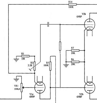

I think the grid signals to the second stage have to be equal or those outputs won't be equal. (180 deg. phase inputs. And equal value plate R's on the second stage)
V1a has very little effective input signal left after the neg. Fdbk at its cathode. So not much signal needed at V1b cathode to get the same (180 deg.) result.
"Like most cathode feedback arrangements, this relies on common-mode distortion in V1 being small as the feedback cannot remove C-M distortion."
I assume the CM dist. is just from the inherent tube dist. (and its loading) So a differential front end would be better in that respect.
Needing a DC balance pot on the input cathodes (as posted earlier by jfetter, from the patent I think), that needs adjusting every month, does not put this circuit into favorable status.
