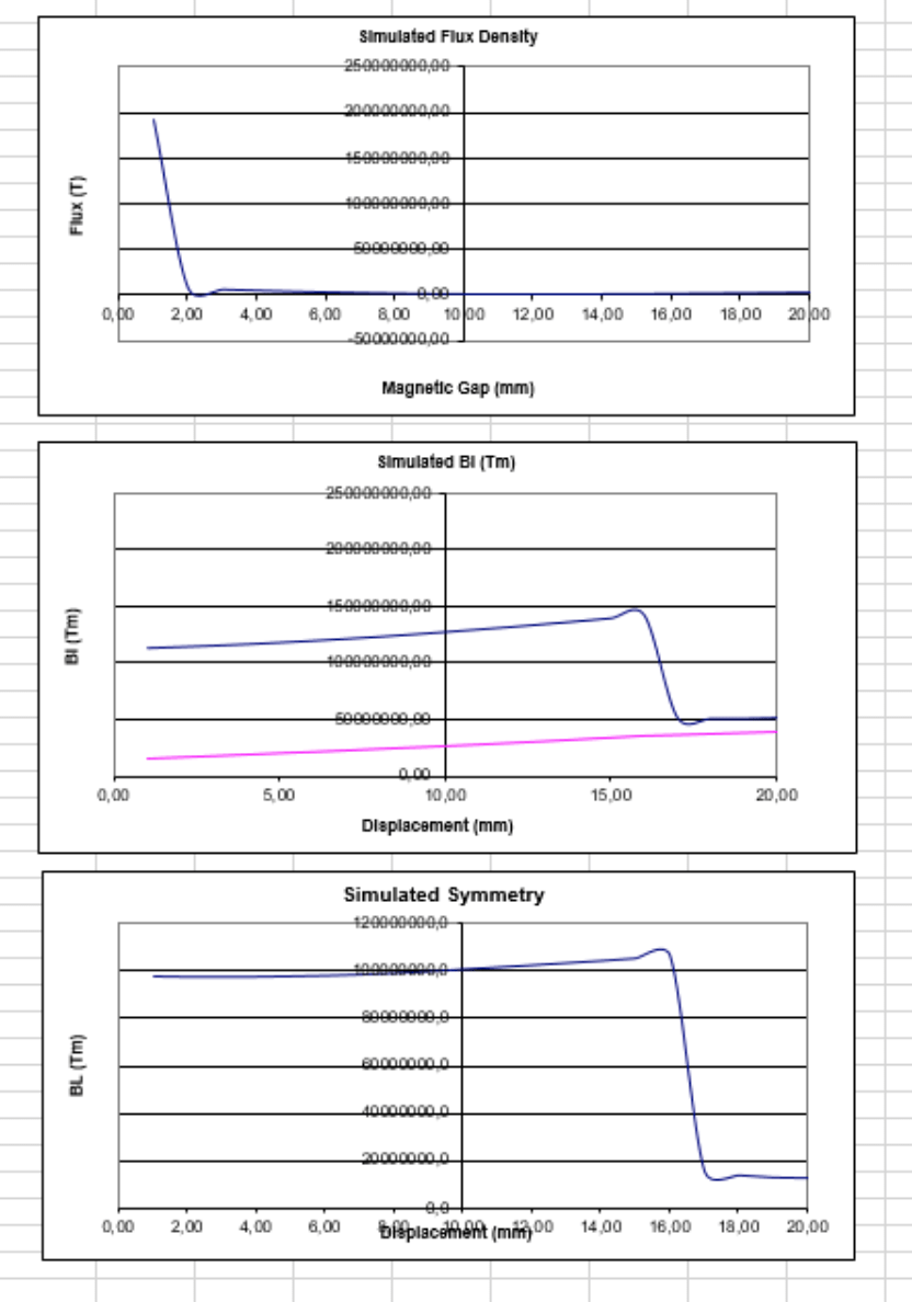

Does anyone understand why I get such strange graphs as the result? It's one thing that I don't get the desired result, but the numerical values still seem quite strange to me.
I saved and pasted the measured values from - to + in the Backward file. And from + to - in the file Forward. It would be great if you could take a quick look at it

Yes, I measured the values. The measured values are in the Forward and Backward.txt files, which I also posted. I made a femme model and measured the line from -44 to +44. This corresponds to the length of the gap in the model. That would be the values in Backward.txt and then from +44 to -44 again in Forward.txt.
I'm doing something wrong because if I build the same model as I described at the very beginning of the post, I also get strange graphs.
First of all, I try to get useful values out and then change my model according to my wishes. The graphs seem completely wrong to me now.

and it's still not clear for me: did you measure physically or take values from a simulation?
Not sure what you call "strange" .... WHAT did you expect?
I look at them and find them perfectly normal and descriptive of what´s happening.
First one exactly shows flux density along the speaker axis: strong and uniform for about 6mm, so that is the gap height/top plate thickness, and then dropping like a stone outside it.
It doesn´t instantly drop to zero only because there is always some fringe field outside the gap proper.
The second one shows BL on a coil as it moves along.
For geometrical reasons it drops slower, since in a long coil, I mean a coil with winding way longer than gap thickness which was simulated here, part of it is already outside i the fringe field area while another is in the strong steady one, so net result averages both areas, high and low flux, and blurs "frontiers" but again, it´s a "geometry" problem.
Not even "a problem", but a description of what´s happening.
I already suggested, in this thread or in another showing same graphs, to use a narrow test voice coil, a single turn one, and then BL curve closely follows B density one, no blurring.
In a nutshell, both curves on the original post accurately describe what´s happening, with that particular coil, in that particular gap.
I answered based on post#1 and those two graphs, , which I called "first" and "second" for obvious reasons.
Numbers are fine, very reasonable.
Gap flux inside the gap hover around 1.2/1.3T which is highish as in "very good", and very possible.
Not sure what you show and ask on post #11, values if taken at face value look absolutely out of scale by orders of magnitude, physically impossible
I've never used Femm but agree that the numbers are too high and the curve shape doesn't make sense. Maybe you can show your model here and see if others can catch a mistake. +-44mm seems like large structure. Is that right? Its not what your graphs sugest (20 mm total).
What I noticed is that with the model that I recreated at the very beginning, to which the very first entry in the post referred, I also got strange values or values that were much too high. Since I use that as a basis, it is probably wise to stay with this model for the overview and to analyze where the error is because it is probably also the reason why I get strange numbers with my very own model.
The graphs I posted at the very beginning of this post are screenshots from a book and not my own. I myself don't get the same graphs with exactly the same model. So somewhere there has to be the mistake.
