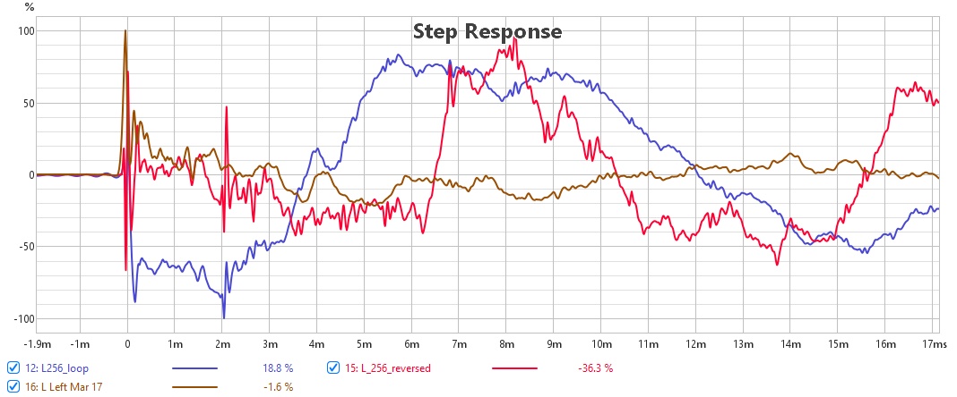

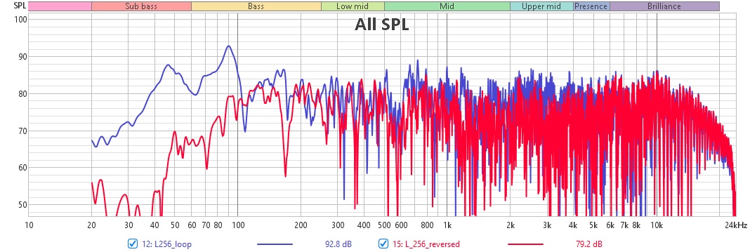

I implemented Linkwitz transform circuit after active crossover circuit,
I did some new measurement, and I've realized that the step response curve is inverted, it going down first (Blue color). I did some ltspice simulation, and same result. I guess the opamp inverting it. Then I tried to flip the polarity on speaker side. Then the step response measurement looked even more strange, and the frequency response also changed a lot.
Coud somebody explain why is it happeing, and how to avoid it? Need an inverting buffer stage between the active crossover, and the Linkwitz transform circuit? Why flipping speaker cable polarity didin't work?
Frequency response:

- Blue color is the active crossover with Linkwitz transform
- Red color, active crossover, Linkwitz transform reversed speaker cable polarity
- Brown, driver response without crossover, and Linkwitz transform
Frequency response:
I measured only the pure driver’s Q and Fs before I started to do the crossover and the Linkwitz circuit.
