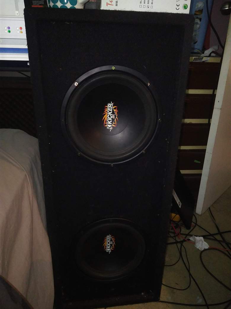

Its a dual 10" subwoofer with a dividing wall inside, I've sealed it all up as tight as a drum with tons of silicone and then I added some weather stripping around the drivers to make it even more sealed, it could literally hold water.
I'm going to resize the holes to fit in two Focal RSB-300 drivers so please do the math for those drivers and not the existing two 10" drivers: FOCAL RSB-300 AUDITOR 12" / 30cm SUBWOOFER DUAL 4 OHM 300W RMS 30Hz-500Hz | eBay

Hi VenusFly,
It depends on what the characteristics of the woofers are. Some simply don't work well as ported drivers. As a rule of thumb, a ported box will generally be larger than the sealed one by 1.6x to 2x for a woofer that would work in either box type. Don't forget that the volume of the port subtracts from the total box volume as well.
So, to start you need to get the Thiel & Small parameters for the actual drivers and plug them into a speaker design program. It will spit out the volume and from there you add the volume of the speaker that will be in the box, the port(s) volume, bracing and for the acoustic damping material. Pink fiberglass is 10% by volume uncompressed. So add these volumes to the volume the program gave you and it will come out right almost every time. Note that some woofers really don't "like" a ported box, just as some woofers that work great in a ported box are unsuitable for a sealed enclosure.
This isn't a case where you drill two holes and stick a pair of premade plastic port tubes in those holes!

Might be best to simply leave it as a sealed unit and put in the two 12" drivers then.
I removed the cotton wool that I put in there and it got louder and I didn't hear any resonance going on so I'm going to leave it as that. I had enough cotton wool in there (pulled out of a pillow) that it filled up the entire cavity inside. So not suprised it was quieter.
I also had it setup before where I stapled some flattened cotton wool to the walls inside the sub and it didn't remove anything of consequence. I certainly didn't hear any resonances in the wood once it was removed. So now its just got no foam inside of it at all, bare wood.
The loudest sound I heard was the air coming from the drivers.

Hi VenusFly,
I would put the padding back in.
If you have a look at 8" drivers, or some 10" drivers you will find that the box size will fit for one, and they will have much lower bass than 12" woofers will have. 12" woofers generally need a much larger box than a car can fit.
I think you would learn a lot by getting a box design program and play with existing drivers that you can find the specs on. Try different woofers in the program and have a look at the size of the box, and also the low frequency cut-off point. You might see a trend that supports what I just told you, but it's much better to learn this yourself.
I think that starting with new drivers in a new box is exactly what you should do, and I applaud your willingness to do so. What you end up with will outperform "canned" speaker systems.

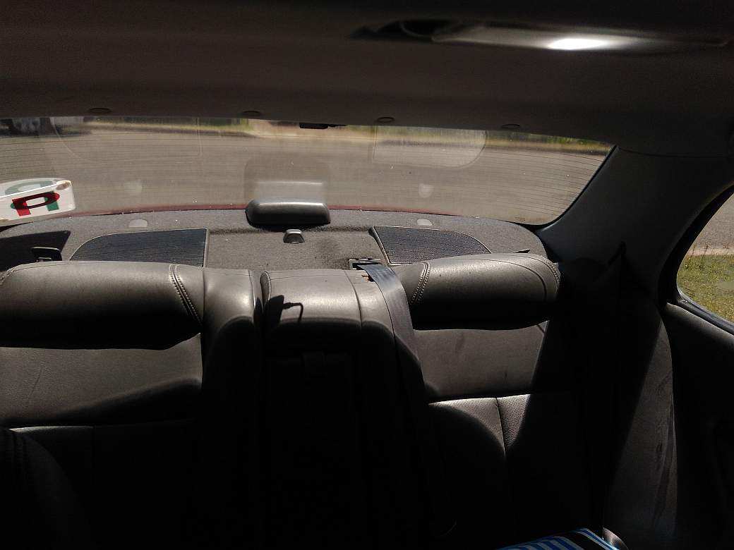

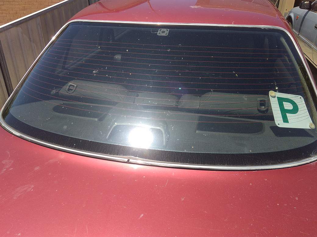

I might give away the dual 10" sub and put in two 6x9 subwoofers on the rear parcel shelf to keep down weight in my car. This dual 10" is pretty heavy and I don't want weight over the rear springs, if anything I want nothing in the boot.
If I get some high powered deep excursion woofers it should produce an adequate amount of bass from the rear parcel shelf and work out cheaper in the end because I won't have to put in the subwoofer, I can just put them on the shelf.

The woofers in the parcel shelf will not give you deep bass because the "box" they are in is leaky. Tried and went back to a sub box. In a sedan without fold down seats, it works a little better. Still, a real box with woofers works better.
You could consider using a pair of 8" woofers in the dual 10" box. Given the right woofers for that size, you might get down into the 35 Hz region (-3 dB), which is extremely low compared to what you have. Note that most manufacturers quote speaker response at the - 10 dB points.

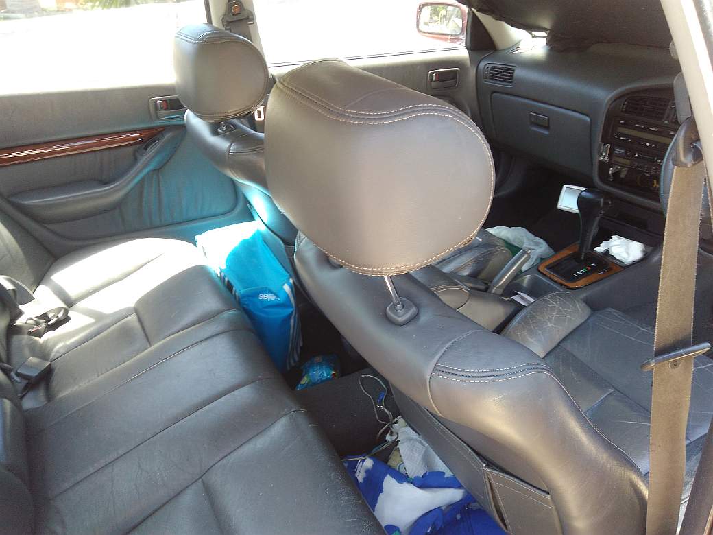

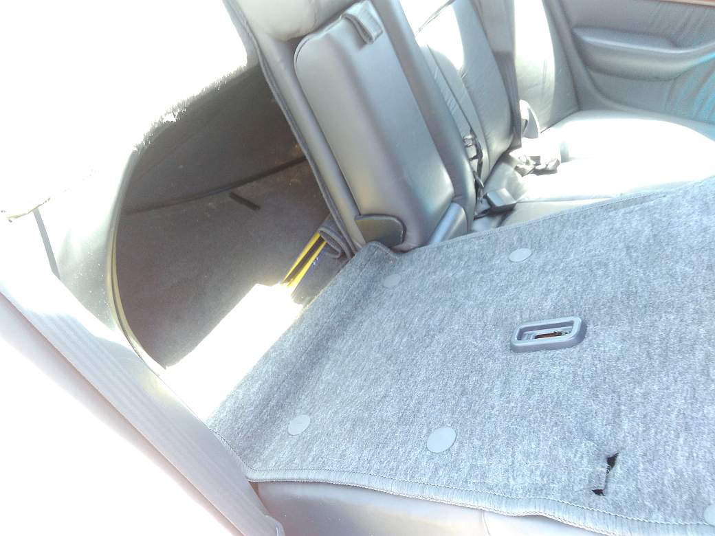

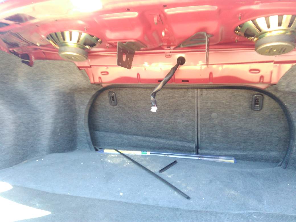

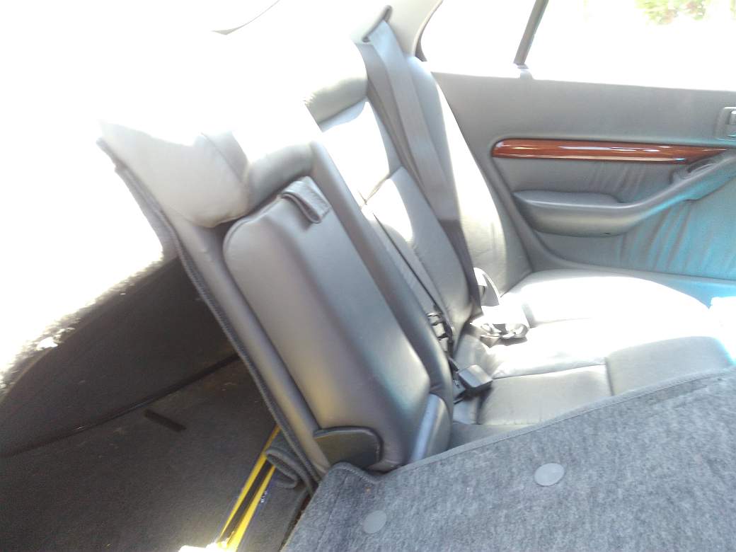

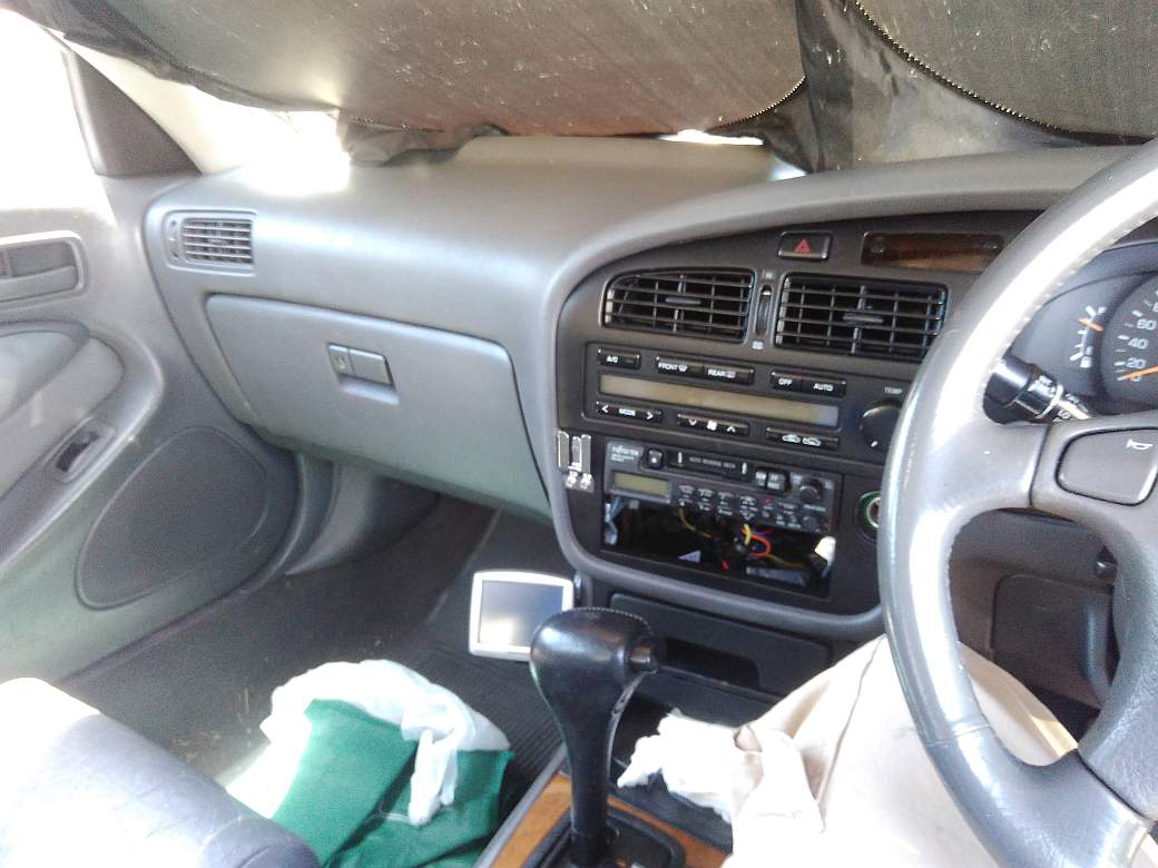

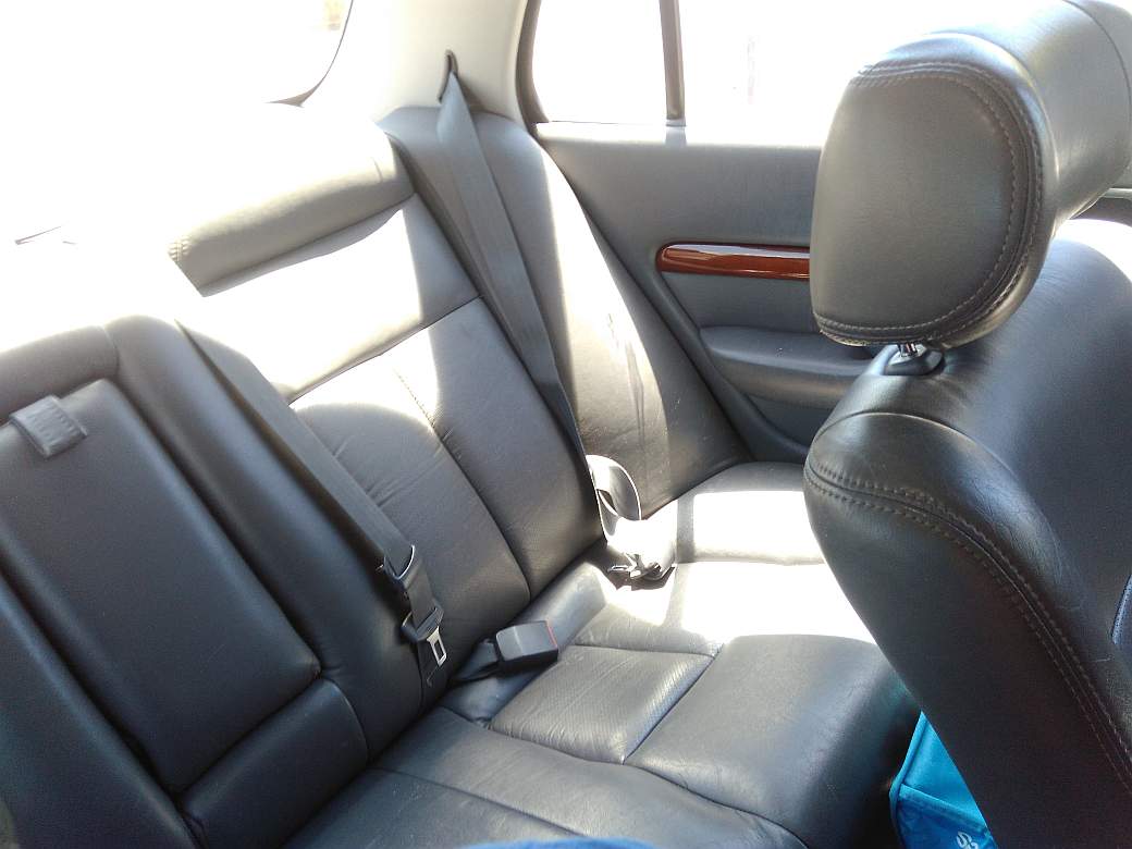

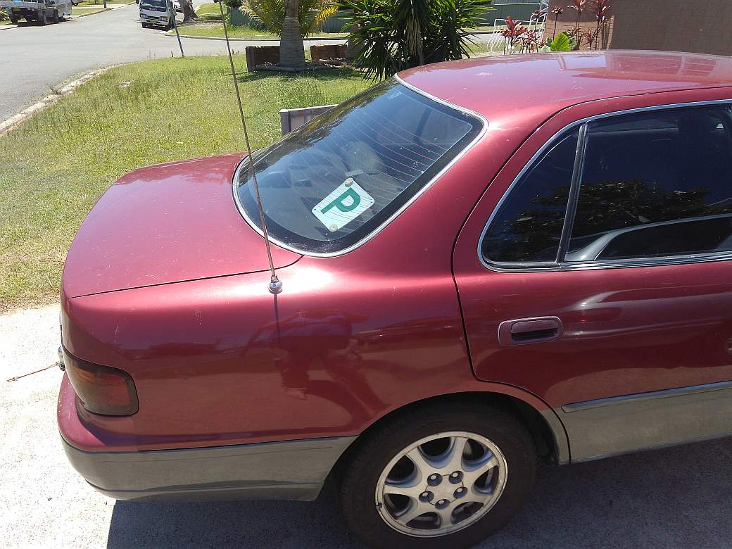

Here is what I have to work with: (in the last pic notice the metal brackets, I can put a piece of MDF on there and mount my amp up underneath the rear parcel shelf.) The dual 10" sub can then fit right underneath it. I want to remove all of the carpet first though and add sound deadening material to the entire boot.

You're in 8" territory with that size. By that, I mean that using the optimal box size for the drivers, you have enough room for a pair of 8" drivers. Before groaning that they are too small, understand that some will in fact get you down to around 35 Hz -3dB without cabin gain. They will be more efficient meaning you need less power to feel the tunes.
The best car I ever did used Peerless 8" woofers. It had the highest sound quality and went louder than most other speaker systems within range, like the 10" and 12" drivers. Using the same drivers I had a B2200 truck that took sound quality and SPL contests for at least 1/2 the summer without changes. The owner then tried the same thing with 10" drivers and basically it all fell apart. Not too bad for a home speaker that wasn't known for it's efficiency.
If you get a chance, use some speaker box programs and play before building anything. Prove what I am telling you. They may have special drivers these days that change the tables, but at least you will be picking the correct drivers and getting the best bang for your dollar - with no regrets. Speakers can be wildly different as to what box they need. You need to choose with knowledge instead of what someone wants to sell you.

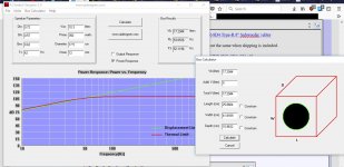

Ok.
I'm going to tackle two 8" drivers with this program: Sonosub - Free Speaker Design Software
It only does ported subs tho. So the search continues.
AJ Audio Subwoofer Box Enclosure Design Software - Sub Speaker Cabinet Building Program Downloads
Going to try ajsealed.exe

Here is the info for the box size diameter from the AJ Sealed designer: (I have no idea what I'm looking at)
