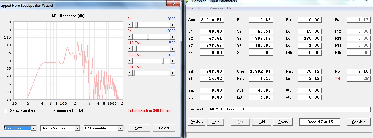

Can someone comment on my hornresp simulations on the MCM8?
You can't easily use a passive crossover with a tapped horn. I've gone around and around with this using Akabak software. Unlike Hornresponse, Akabak has a means to simulate passive crossover components. The passive components mess up the electro-mechanical tuning of the tapped horn. The best route is to use an active crossover in front of the amplifier.

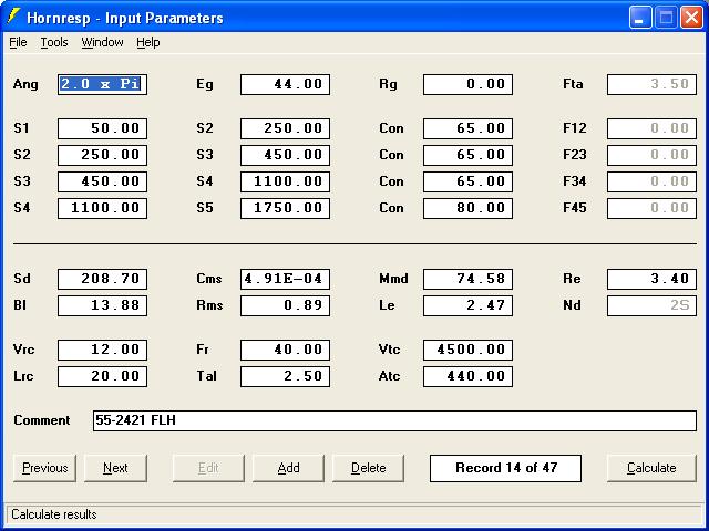

I second that motion... been there, done that. The best place for a MCM is a small sealed in car, or in a front loaded horn for PA with a very small sealed rear chamber. The small rear chamber helps control excursion, and consequently helps preserve the spider.
You want something that can hit 120db in car, you kinda need a 'car pa' style for your mcm's. In other words -- a PA FLH style cab with a sloping response, so in car it's flat.
my 2c.
ok cool, so eq works just the same way as with sealed boxes. And when I add a coil, I'd also have to add the resistance.
Now that brings me to wonder, if I was to use a passive high pass filter - as with most of these bass horns a HP is needed - at say, 30Hz, would the caps and coils do anything unexpected to the response? Or would it just apply the designed high pass effect just the same way as it would if used on a sealed box?
That might be a stupid question with a simple answer, but I have to ask, since horns are sooooo different than a sealed box, and I have never used a horn before.
I have measured the effect of a series inductor on a Tang Band W6-1139 tapped horn. It does not behave exactly like a passive crossover per se.
The effect was nearly exactly what the model shows us, the peaks in the passband that correspond to the excursion minimas were damped somewhat, the saddle (excursion maxima) remained unchanged, except for the attenuation due to the additional series resistance.
You only need a single inductor, wire it in series with the drivers. As far as a high-pass, active is a much better idea, the coils and caps involved get rather unwieldy and extremely expensive if you want to have a slope that might actually protect your driver at the end of the day.
