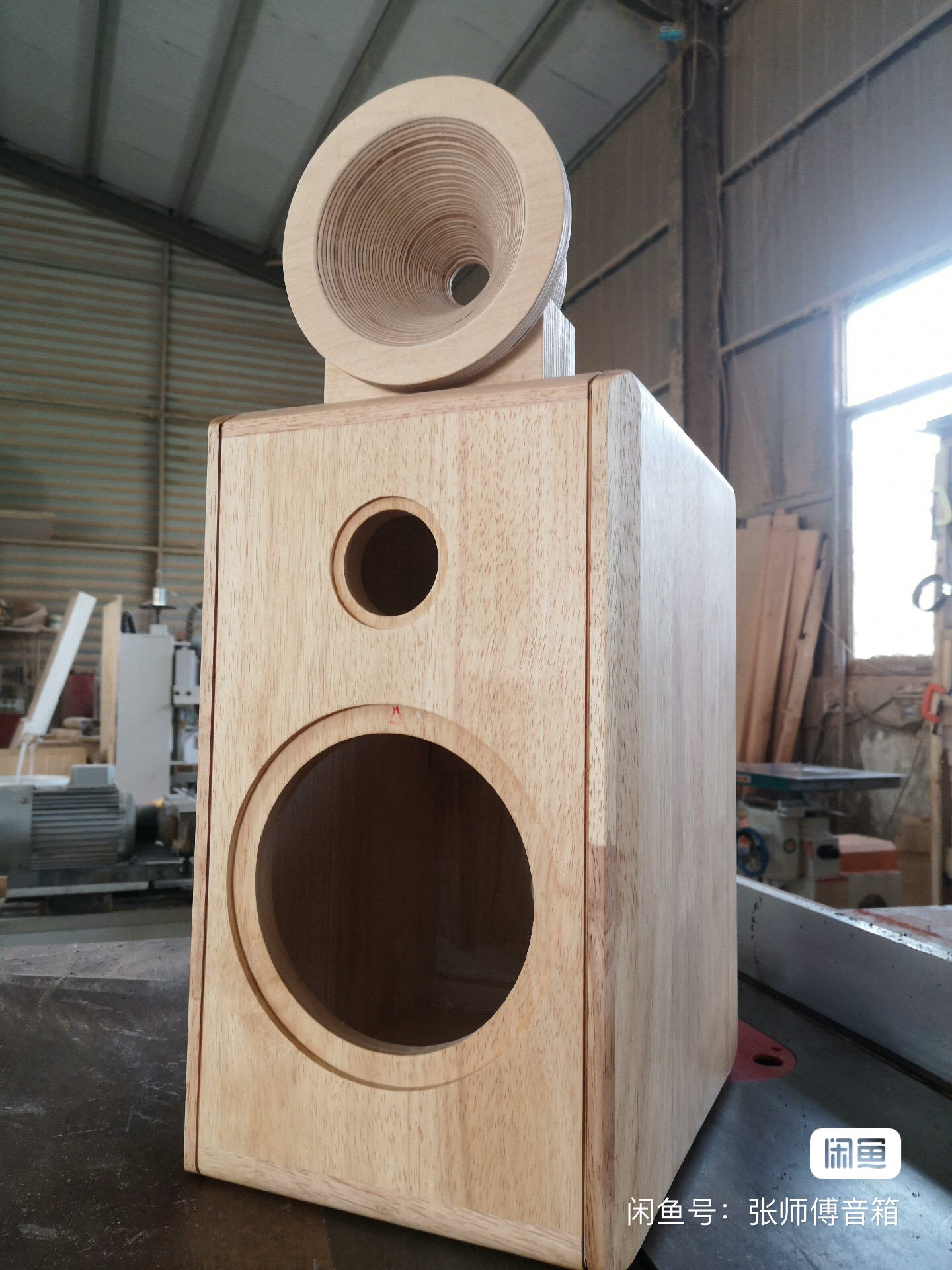

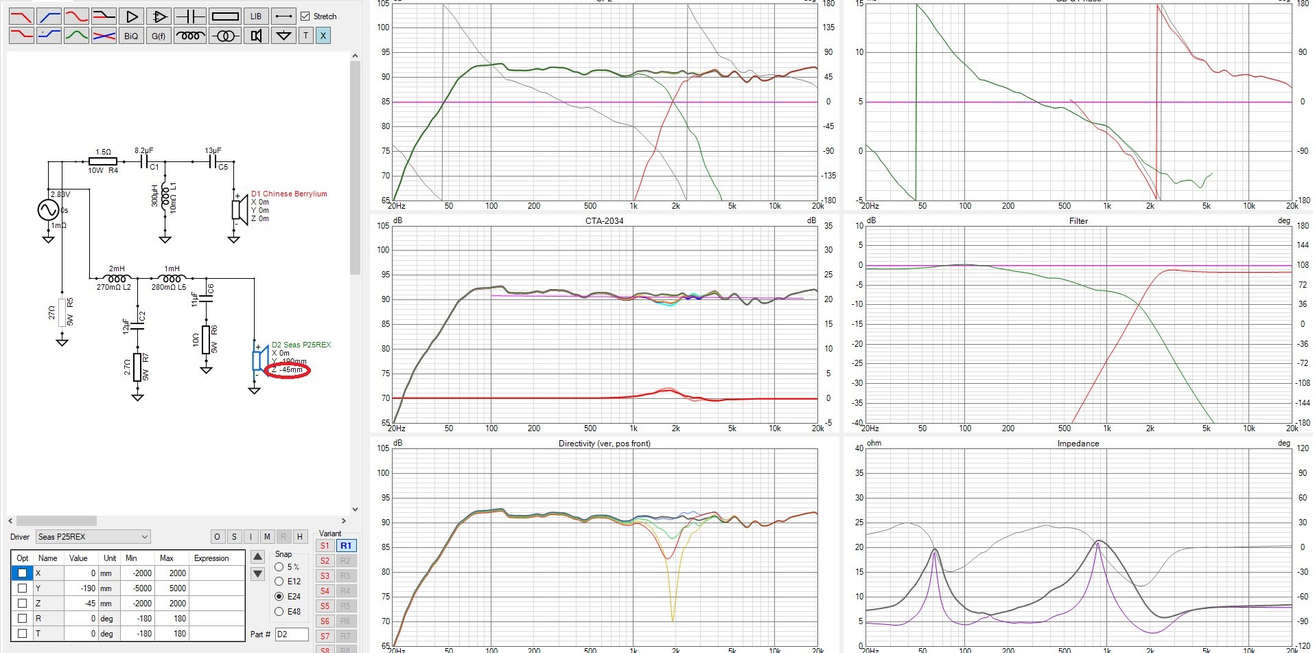

Can SEAS P25REX design in 2 way seal box?

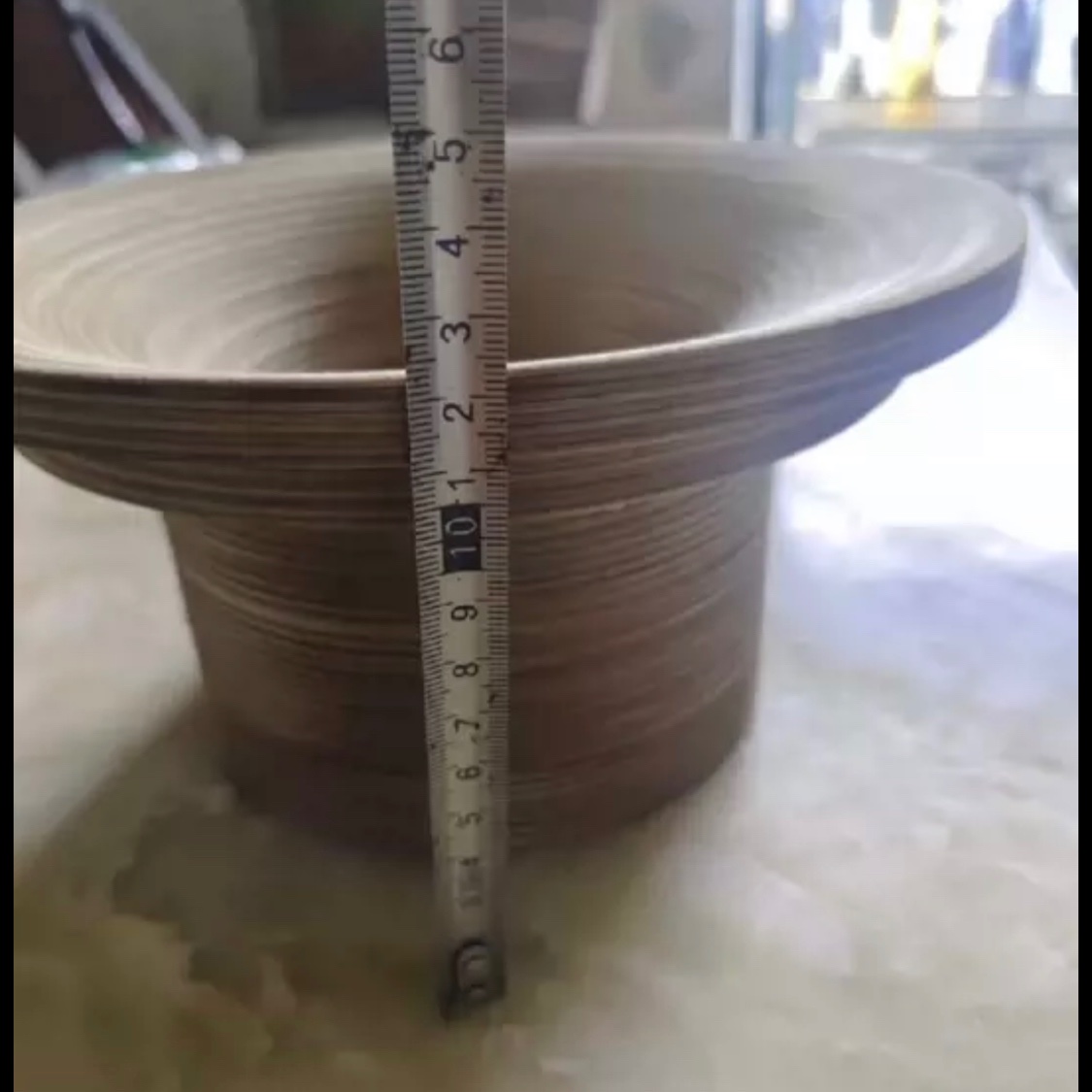

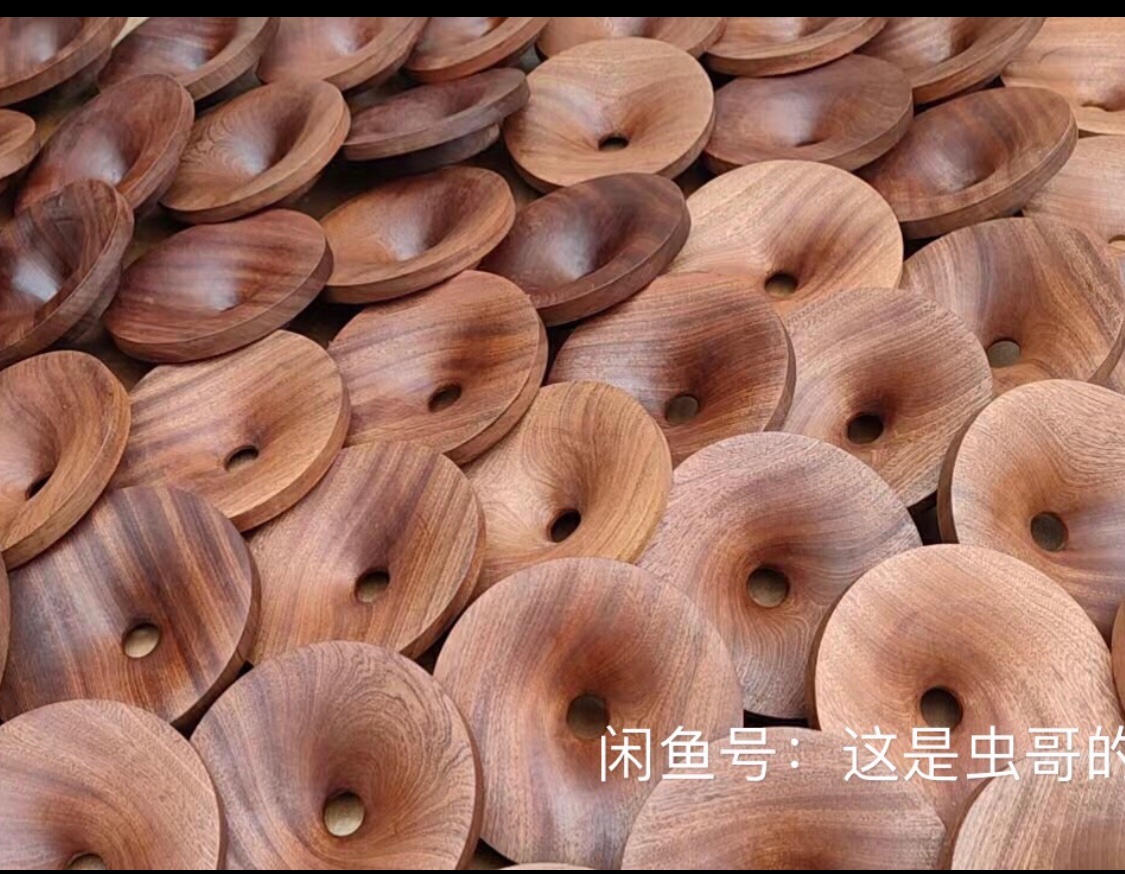

Most waveguide a lot deeper than 45mm. Then Z offset need to be value not 0.
Which waveguide contour best for tweeter that match seas p25REX?

Why many designers input - XX millimeter in Z value of woofer?
There are some reasons behind???
But i input Positive (opposite but same distance in mm.)
For X and Y i am not confused of + or -
But z is what i am confused??

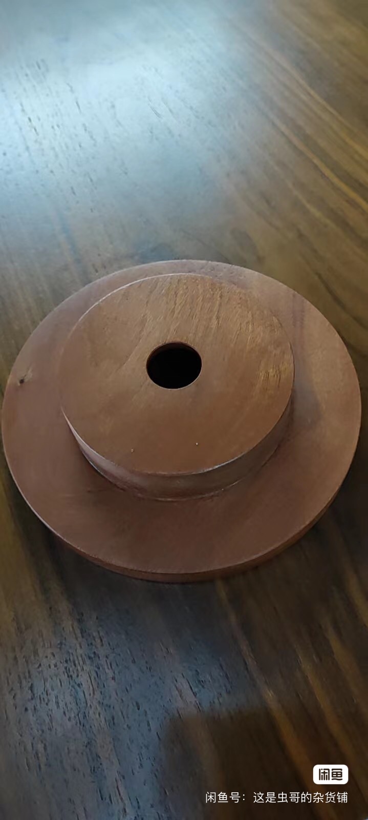

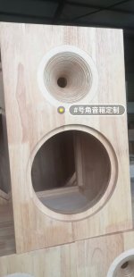

I think that for such combinations (big mid bass - small tweeter) it is better to use a tweeter with a waveguide. Cutting the tweeter starts much earlier and it gets less energy at lower frequencies, and there is also a correction of the polar characteristic in that zone, so it fits better with the bass. Moving the tweeter back is also better for phase matching with mid bass on a flat front plate.
https://heissmann-acoustics.de/en/test-vifa-xt-300-xt25tg-waveguide-wg-3
If no waveguide Z is 45mm. But most waveguide deep around 12cm -18 cm then it is opposite 75 -135 mm Z value.

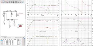

How to input z value to tweeter?

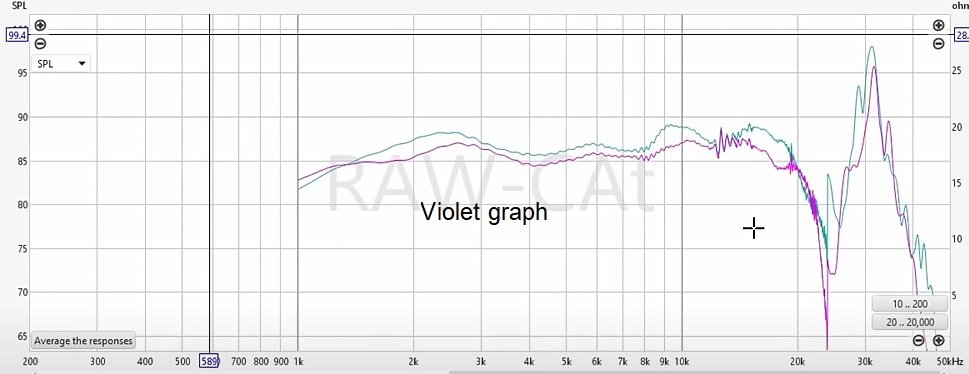

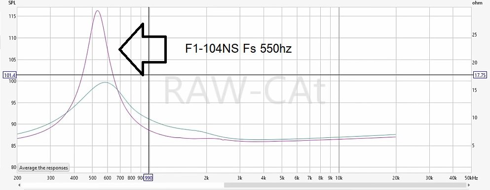

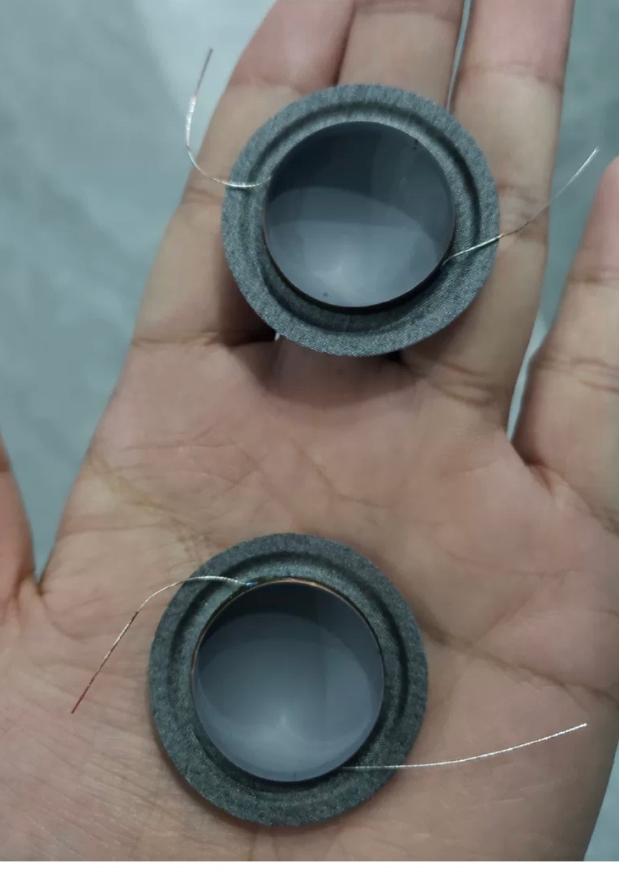

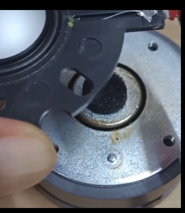

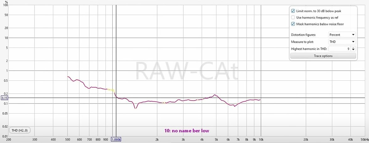

This is a distortion of tweeter F1-104NS from China. Which is beat my old SB26ADC from hificompass test.
It can cross very low even same Fs as SB26ADC
I think F1-104NS is quite suitable for using 2-way with big woofer. Cone brake up is >30Khz
Fs is around 550hz
ignore line 85db, actually it is 90db line and this tweeter senn is 92db.

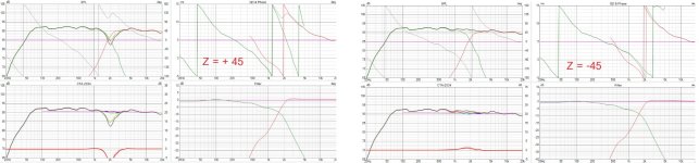

Yes indeed was confusing for me too at first.
Z is for the driver if set back or set more forward.
Forgot to mention and put in parenthesis around the info in the Virtuix CAD instructions or help manual
from the manual=
Z [mm] is horizontal distance coordinate; negative closer to mic and positive further from mic.
Reactions: supernut

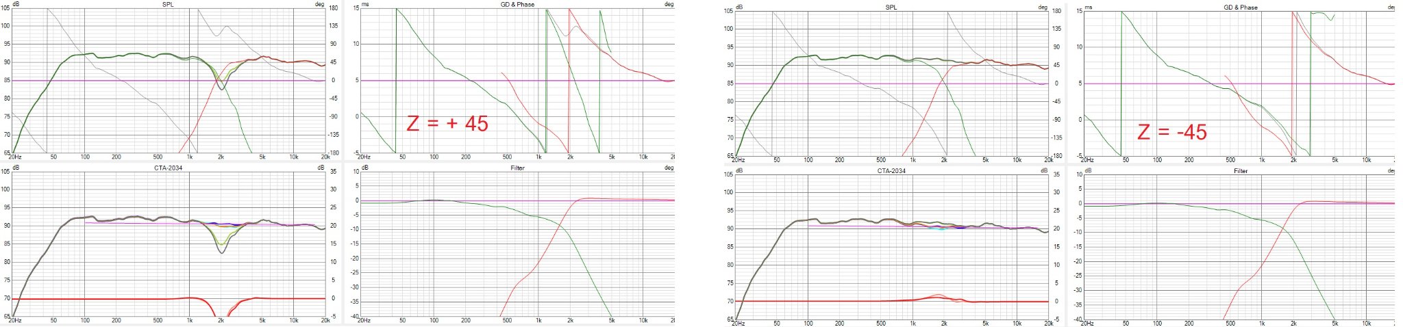

Pardon, can I conclude that Z sign will be cantrary to manual?
Then to make easier for newbie as me, if voice coil of woofer is 45 mm deeper than tweeter voicecoil then -45mm ( suppose 45mm different distance) am I correct?
Then i have to modify all of my complete speakers XO.
Due to I always use + Z to woofer
Sad
That is what I thought too, seems logical
If driver set back deeper seems it would be negative. But when I tried for time alignment or was trying to get phase more linear.
The phase behavior did not make sense.
So yes pulling my hair out after reading the help guide is completely opposite.
= negative closer to mic and positive further from mic.
Im with you, after many hours doing a more linear phase design with hair pulling time designing a all pass filter
the sim was completely wrong.
To make more sense at 1 meter or 1000mm if the driver was farther back 45mm, we add =+45 to Z
Now the driver is 1045mm or farther from the microphone.

Can you conclude Z sign? Sorry my English is not good.
If woofer is deeper towards front wall than tweeter (normal front flat panel of cabinet woofer will deeper) then + Z to woofer parameter as the distance different between tweeter voice coil and woofer voice coil?
This is the same as VirtuixCAD's guide.
Then many designers were wrong. I always see -Z value from every designers. Then they are incorrect? Seem impossible to me if all designers were wrong about sign of Z.
That made me have to rethink again +Z of me wrong or - Z of all designers were wrong.
But to my commonsense i am only 1 use + Z, then mine might be wrong even I follow VirtuixCAD guide
