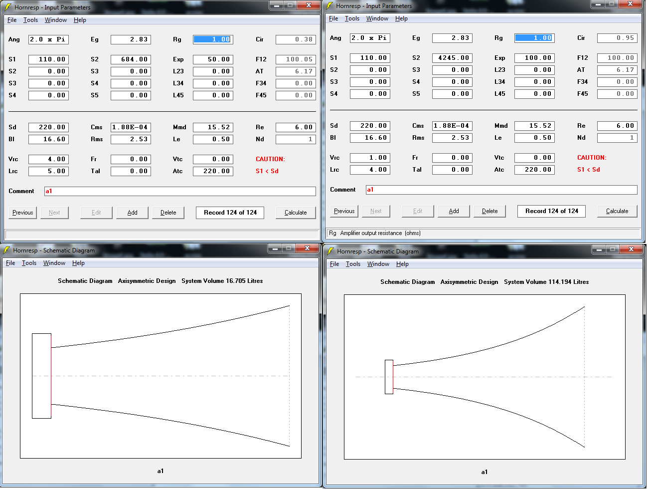

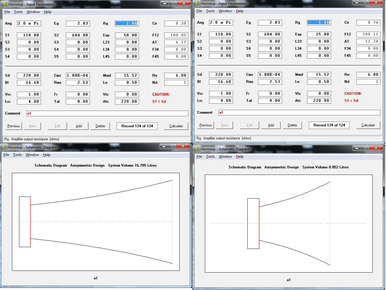

If you take a plain conical waveguide and you replace it with a round baffle, same size as the waveguide mouth, same convex shape as the wavefront, and cover this baffle with lots of small drivers.. the primary operation is going to be the same (save for a few small details I haven't mentioned).we'd have no need for the first 90% of a bass horn.
For a horn example, some builders might shorten their exponential by changing to two drivers instead of one, then moving them down the throat to where it is larger.
