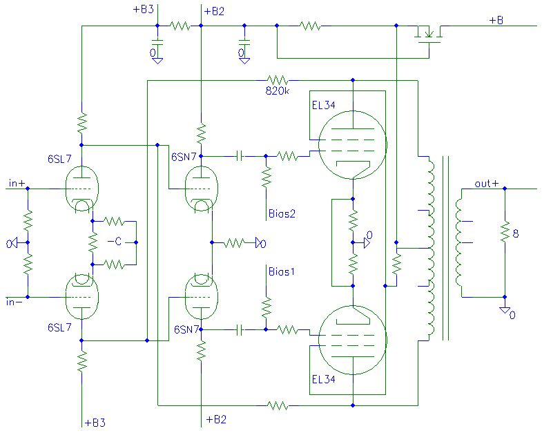

It seems to me that it's no a good idea to releive entierly on global
NFB, since, as you point, this single loop has to cancel all acumulated
errors in the whole amp.
It's a funny experience to look at the shape of the signal on the grid(s)
of the output stage with such a design. It can look very assymetric and
causes output tubes bias shift, link caps being charged by the grid current
even if the outout stage was not intended to do so !!!
Thus the driver already has to supply this kind of "predistorded" level.
The output stage MUST include some local NFB, specially if uses penthodes or tetrodes.
A global loop may be added to reduce Zo if needed.
Yves.

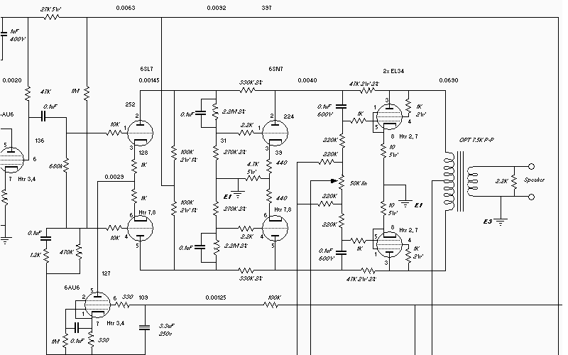

KYW, I am not that surprised that you consider 90% of all designs old and new ones to be crap but I think you are a bit inconsistent.
First you say
Then you refer to a lot of designs where it has been considered beneficial to use local feedback and global feedback including the OT can you clarify what you mean? are these designs also crap? Are only designs where the OT are not at all included in the feedback chain good designs?
Although local feedback can compensate for unlinearities and reduce output impedance it is not as effective as using global feedback including the OT. Distortion from the transformer, (mostly 3rd and 5th order) and output impedance is not directly dependant on source impedance.
If source impedance is reduced to 1/4 the distortion is reduced to roughly 1/3 and if the source impedance is reduced to 1/10 the distortion is reduced to roughly 1/7, these figures are valid for a case where the transformer is optimised for the new source impedance. If only the source impedance is lowered but the transformer is not changed, the reduction in distortion is even less, for 1/4 source impedance distortion will be lowered to 0.4 of what it was. However global feedback would reduce the distortion as much as the amount of feedback.
For reduction of output impedance, (improving DF) changing source impedance make no difference if the OT is optimised for the new source impedance, if the same OT is used the output impedance is reduced, if source impedance is reduced to 1/4 output impedance is reduced to 0.46 of what it was. Also in this case global feedback is more effective and 4 times global feedback will lower the output impedance to 1/4 of what it was.
(All calculations based on a case where primary impedance is 4000 ohm, secondary load 8 0hm and DCR 0.05 of primary resp secondary impedance)
I am well aware of that there are other benefits of lowering source impedance as it will be easier to make a transformer with wider bandwidth but this together with the above results indicate that a mix of local and global feedback is the optimum way to go, maybe not a surprise as this is what many designers both old and new have used / are using, (for instance Knapp and Kiebert that I referred to and many others).
For the original question on how to improve DF in an existing amplifier without changing OT clearly the most effective way is to use global feedback including the OT in the loop. As your output transformers are designed for 3500 primary impedance it is probably adviceable to first lower the source impedance to 1/2 by local feedback and then apply global feedback, using the transformer to reflect a load of 7kohm when it is designed for 3.5kohm is not optimum as the primary inductance will be too low for the higher impedance, result being loss of low frequencies. I dont think you have to worry about instability if you keep the amount of global feedback reasonable, try to increase feedback until you get oscillations or instability and then back of required amount, you can also introduce phase compensating networks in the amplifier if you want to apply higher amount of global feedback but that requires a bit more of measurements and calculations.
Regards Hans

Konnichiwa,
It shall be better say that circuits that use only one long feedback loop are rather not so good. Designs using multiple inner feedback loops and only a "notional" outer loop tend to be quite good. The more the NFB is shifted from inner loops to outer loop the worse.
Hmmm. It is actually very effective.
Hmmm. Measurements I have done have shown a pretty direct relation between source impedance and distortion in transformers. At any extent, most transformers will show any material distortion only at low frequencies and high levels.
I am not sure I follow your reasoning. Have you actually taken a simple Output transformer and made the measurements?
While that is true, as noted before, the transformer distortion becomes significant only at low frequencies and even there it will remain fairly low if you ensure to avoid going too close to saturation.
That is so obviously incorrect, that it makes me question your sources.
Let's take a real example. We have a conventional 3K5:8 Output Transformer with 120 ohm primary DCR and 0.2 ohm secondary DCR. The net resistance introduced by the OPT is around 0.5R.
Now we take a Triode EL-34 PP Stage with around 2K output impedance driving this. Without NFB we have around 5 Ohm output impedance in Class A operation. If we apply 12db feedback in a loop including the OPT we get 1.25 Ohm effective output impedance, if we take feedback from the anodes of the EL-34 PP Stage our output impedance we get 1.65 Ohm.
So, applying 12db NFB in the inner loop reduces our output impedance to 0.33 times of that present open loop WITHOUT ANY changes to the OPT, applying 12db NFB in the Outer loop gets the nominal 0.25 times of the output impedance under open loop conditions.
Yes, there is a difference, if the DCR is lower than my suggestions (which are based on a real transformer) it will be even less.
I disagree. The long outer NFB loop will invariably be subject to drastic changes of feedback factor with frequency which indicates phase margin problems and thus transient problems absent if that feedback loop is avoided.
All in all I retain, a given amount of feedback is placed best in an inner loop excluding the output transformer if subjective sound quality, load tolerance and stability are of concern MORE than meaningless testbench numbers.
Especially when weighted distortion measurements are applied (as suggested ages ago by Crowhurst, Shorter et al and recently revived) the superiority of that approach becomes readily aparent. The only price paid is a modest increase in output impedance from the DCR losses of the output transformer, which in reality is nothing to worry about.
As you mention Kiebert, you are no doubt aware that he used on outer loop for his own most critical (in terms of sound quality - like his cutting head amplifiers) Designs?
Not neccesarily. The OPT may introduce enough stability problems to force you to reduce the NFB applied to avoid instability. Then you are left at that (or you have to start adding inner loops).
I found that I can apply a lot more NFB in the inner loop from the Output stages anodes than when including the output transformer, both in terms of stability AND of avoiding some of the obvious sonic problems introduced by using a system that attempts to fix errors after they have already happened (Negative feedback).
The result is IN REALITY that the resulting Amplifier has LOWER DISTORTION and LOWER OUTPUT IMPEDANCE as one using the same Output Transformer and a global loop in the traditional application.
And that was my point in the first place.

KYW,
I think what you are writing i still inconsistent, it is not clear for me, (and can't be for anyone else either) if you approve of designs using a mix of local and global feedback including the OT in the global loop or if you disapprove completely of including the OT in the loop.
First you write,
Then you say regarding amplifiers where the OT are not included in the loop,
Can you care to explain? Do you approve of designs using local and global loops including the OT as seems to be the choice of most designers or do you say that only your way excluding the OT is the way to go, and subsequently that most other designers are wrong?
Some comments to what you wrote regarding some points in my reply
Re effeciency of global versus local feedback I wrote
I haven't questioned the efficency of local feedback, I have only said that it is less efficient than global in some ways, (which you actually confirm)
Regarding my calculations of effect on source impedance on distortion in output transformers you have some comments, let me reply to all of these here.
Distortion in an OT is not directly related to the source impedance but for any given transformer directly related to the parallell combination of (the sum of primary impedance and primary DCR) and (the sum of the secondary load and secondary resistance reflected to the primary).
This means that when the source impedance is lowered distortion is lowered but not as much as the source impedance is lowered. If this was not the case a transformer would be distortion free when fed from a 0 source impedance which it is not. The formulas for how to calculate distortion can be found here http://www2.gol.com/users/tube/papersindex.html on pages 12 and 13, I have copied this from a text found in "Radio engineering handbook" by ITT but the original source is from another book, as I don't have access to the ITT book right now, (it is in my office) I can't give information about the original source until sometime later, however the basic formula for how to calculate distortion in a transformer can be found in many other texts.
I have access to measurements on real output transformers confirming that the formula give a correct result with respect to sensitivity to source impedance as to be expected.
Regarding your comments regarding output impedance and relation to source impedance you are actually confirming my results by your own example, the figures I have given are correct given the transformer data I also gave which by the way is based on a real transformer, agreed the quality of that one is lower than the one in your example but it is not unusually bad.
What could be interesting to notice is that the efficiency of lowering the source impedance is less when the transformer quality is lower, i.e. when DCR is high, this would indicate that including the transformer in the global feedback loop is more of value when the transformer is of dubious quality.
Interesting comment, do you really believe that any amount of feedback including a transformer in the loop will always introduce phase margin problems? Is it not dependant on the transformer quality, the number of poles and their values at other points in the amplifier and of course the amount of feedback?
I think you with this refer to the Kiebert amplifier for cutting heads that doesn't contain an outer loop? as described here http://www.clarisonus.com/Archives/Amp_Design/Kiebert.pdf in fig 19 on page 40, yes I see that this amplifier doesn't include the OT in the loop but I also notice that in all other described amplifiers the OT is included in the loop, (but according to you these designs are bad).
I wrote earlier
And your comment is:
Ah! Now I see, you believe that I argue for using only outer loops including the OT and not use any internal loops at all? Where did you got that from? I have only said that including the OT in a global feedback loop is more efficient with respect to lowering the output impedance and to lower transformer introduced distortion than to use the same amount of feedback for lowering the source impedance but I never argued for that this should be the only applied feedback, on the contrary I have given references to several amplifier designers that have used multiple loops as I also believe is the optimum way.
I didn't think that you where an advocate for large amount of feedback? Is it not enough with the minimum amount of feedback that gives you the desired result? And is it not then the optimum way to apply feedback in the most efficient way which is to use several feedback loops where one include the OT? At least this is what most designers current and past have found.
Regards Hans

Konnnichiwa,
I approve of using as short feedback loops as possible and if neccesary using multiple neted loops.
However, I take SEVERE issue with the statement that "most designers choose designs using local and global loops including the OT". Most designers (solid state and valve) choose just one outer loop, in Valve circuits including the Output transformers.
I suggest using only one outer NFB loop as commonly done is monumentally stupid. Other applications have to stand on their own merit.
I find that if the inner loop is optimised to be the main loop it usually results in better subjective and objective performance than using outer and inner loop, but that position is admittedly debatable, as is what "good objective performance" consists of.
For example, to me reducing as much as possible high order harmonics is part of "good objective performance". Due to the distortion multiplying effect of multiple stages and of inverse feedback (distortion of distortion of distortion send back to the input stage where it is distorted.....ad infinitvm) it would seem that the more stages are inlcuded in a feedback loop the worse the objective performance as I see it.
In our amplifier we have a given load and a given set of copper losses.
If we now reduce the Source Impedance feeding the transformer the distortion is reduced at high source impedance values directly proportionatly to the source impedance, at source impedances approaching the copper losses (DCR) of the transformer the distortion approaches asymtotically a given minimimum determined by the copper losses (DCR) of the transformer.

Re: BREAKING THE LOOP...TRYING ANYWAY.
Konnichiwa,
As much or as little as you consider neccesary.
If you like, you can wrap each and every stage into a local NFB loop, depending upon the circuit and output device you may wish to use two stages inside the NFB loop.
Ones combining global and local loops. One with great merit is the Mac Circuit (also often used by EAR).
Everything. Hans war refering to scaling the primary impedance in the context of his observation of OPT Distortion, I was refering to using one and the same transformer. Please read more carefully.
Nope. Please read the whole post....
Well, let's see what I have ACTUALLY written.
Yes, but power will be reduced, for triode circuits and in Pentode circuits things really go awry if there is too high a load.
Nope. I fail to see what particular lack of logic and sense leads you to conclude this from my writings. Have you actually bothered to READ what I have written?
I propose that using an outer (Long) loop is "stupid" and that if you use the same amplifer circuit and components (including OPT) and you apply a suitably designed inner loop (either across anode to grid of the output valve or anode of the output valve to opposite polarity driver valve grid - I prefer to limit myself to shunt feedback) the resulting performance is better (as more NFB can be applied withoiut stability and/or sonic penalties) as using the outer feedback loop.
Don't know what it sounds like to you. Have you tried a suitable implementation?
Are you so sure that load is "out of the loop" any more by taking NFB from the transformer primary than it is taking NFB from a seperate feedback winding or the transformer secondary?
Interesting logic you have.
Hmm, do as you like.
I did say it in short and to the point. The result was that Hans took me to task about how wrong my view was and offered several unrealistic numbers to back his claims. I started to deconstruct them wherever I had enough hard data to do so.
Sayonara

Sure it's us needing to learn how to read or maybe you needing to learn how to write??
Other than moving the goalposts as it suits you, you don't have much to say that could not be said in a few lines already and without insult.
My conclusion from all this is that instead of resorting to all the trickery feedback and the invention of a whole new glossary sending people in an endless loop is that:
If you'd use more linear devices in the first place you would not have to resort to that much feedback in the first place and would by the same token already achieve sufficiently low output impedance.
Then there are distortion cancellation techniques in cascading stages as well....
Duh....Power wouldn't be reduced if you'd put feedback around a penthode output stage?
Go on tell us we all misread you once more.
Go on, take that EL34 again.
Put feedback around it turning it into a triode (as you admitted) and tell us that you won't have lost output power in the process.
Within the confines of an amplifier, yes, shunt feedback would have advantages. But just like negative voltage feedback it has disadvantages as well.
There are, after all, various kinds of feedback to choose from.
Where does it say "separate feedback winding"?
Either way I'm not saying the load is entirely out of the loop when taking feedback from the primary side.
It certainly won't act the same way though.
The numbers you presented so far haven't convinced me either...
Cheers,😉

My current amp schematic, using the EL34s as triodes, is in the attachment. Voltages and currents are annotated at various points on the diagram. NFB is applied at two points:
(1) between splitter and driver - simple shunt fb, mainly to help stabilize the DC coupling via the step network;
(2) between driver and output stage - so-called "partial feedback" where the fb resistor is also the driver's plate load.
I think I may have under-engineered the second feedback loop, because I don't think the driver is capable of driving the OP stage to full power based on simple measurements with a volt-meter across the load. Maybe I should use simple shunt feedback there instead, i.e. give the 6SN7 its own plate load and use a much higher value of fb resitor as per the first fb loop?
My original question was whether this approach to NFB (assuming I get the design right) is good enough for pentode output or do I need to introduce global NFB as well? If I do, I hope the combined effects of the step network coupling the 6SL7 to the 6SN7, together with the shunt feedback between these two stages, will prevent the kind of LF instability that can arise from having two coupling capacitors inside the loop (a la Williamson).
Comments are very welcome.

Re: Thanks, everyone, I'm overwhelmed!
Konnichiwa,
Hmmm. The Feedback between Anode and Grid of the Output Valve is sub-iea IMHO as it leads to the driver stage having to swing more voltage and thus increases non-linearity.
I have attached below the principle circuit I use. Please note that omiting the Values and some crucial details which stabilise the ircuit are omitted on purpose. But it should show the principle quite well.
You can do well without global loops around all stages and the output transformer. The amplifier as shown has a very credible technical performance (THD, Damping Factor etc.)

Thanks for that, KYW. I understood, from your initial description of your mods to the Shanling amp, the kind of FB loop you were using - as you said, similar to the Citation II arrangement.
I should try it, in place of the short NFB loop I currently have from the OP stage plate to the driver plate. I am inclined, though, to keep also the NFB from the 6SN7 plate to the 6SL7 plate, as I think this helps both DC and AC balance - what do you think?
Konnichiwa,
I tried this additional loop and in the end feltusing local degeneration in the 6SL7 Cathode to be preferable. Matter of taste I guess.
In my circuit the input valves in effect operate as strongly degenerated (and linearised) voltage to current converters which operate into a balanced "virtual AC ground" at the 6SN7 stage where the feedback loops are completed. This is very linear and has a good DC stability.
Sayonara

I tried this additional loop and in the end felt using local degeneration in the 6SL7 Cathode to be preferable.
I've got both types in my current circuit (1k in each cathode of the 6SL7, plus the plate-to-plate NFB from 6SN7). Maybe that's belt-and-braces?
My thinking was that:
(1) The unbypassed 1k in each 6SL7 cathode would help both to make the gain less device-age-dependant and to allow the currents in the two halves of the splitter to equalize.
(2) The plate-to-plate NFB from the 6SN7 would give both AC and DC feedback, the latter helping to compensate for any DC imbalance in the 6SN7.
However, if DC stability its not llikely to be a problem, then I'll try it without the plate-plate NFB from the 6SN7.
I like the idea of DC coupling between the 6SL7 and 6SN7 because it eliminates a coupling capacitor from the feedback loop as per your schematic example (and as you have already mentioned). The only problem is the voltages! I can't have the 6SL7 plates sitting at +250v like they are at present (that's why I've got a step network in there now). However, I think I can get around this by creating a -100v supply for the 6AU6 LTP tail, which should allow me to drop the 6SL7 plates to about +100v, with a bit of adjustment in a few places (just have to be careful not to exceed cathode-heater voltage limit of the 6SL7 and 6AU7, which is about +-100v).
