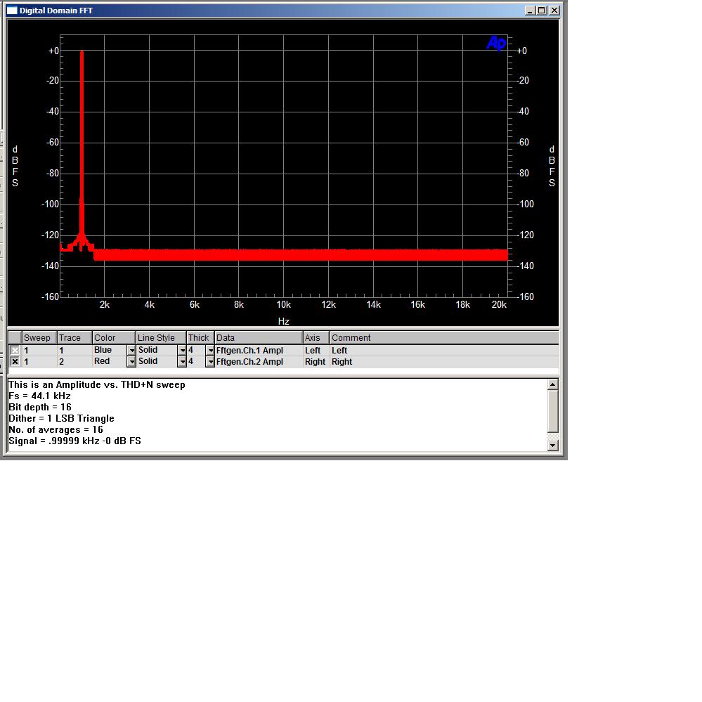

Hi George, I made some plots. I made these on an old Ap (System One). It's not very fancy as far as it's digital capabilities, yet it shows excellent performance at -0 dB FS. This makes the mystery deeper for me. When you made those scope shots (the great looking ones), did you monitor what the Quad's and the headphones were "seeing". In other words, were you right at the speaker teriminals?? I'm just wondering if there could have been some kind of input overload issue. I can't see the earlier posts from this page and I'm too lazy to re-type everything, but I remember something about 22V or so rails?? If those potentially large output levels aren't padded down, they might cause some input overload.

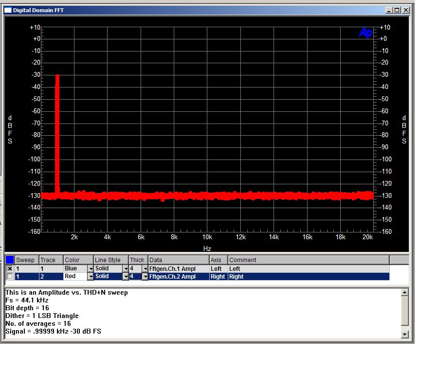

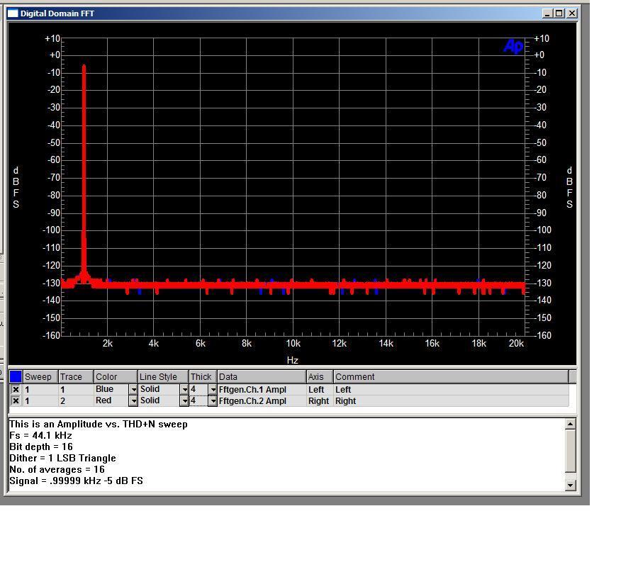

Okay so I made some plots. The first plot is a digital amplitude vs. distortion sweep. I saw an interesting little bump at -30 dB FS but it looked really good at -5 ~ -0 dB FS.

....and -30 dB FS

That's an artefact of the sampling process and the windowing used to truncate the signal for FFT'ing purpose.
The noise floors are similar in both plots, and more importantly, no other spikes show up in the whole band above 1KHz, up to 20KHz. This means essentially there isn't any distortion that the AP1 can pick up - at least nothing above -130dbfs...
That AP1 is a nice machine... :)
Cheers!
Hi George, any differences at the base of the fundamental's spike is not likeley wht your hearing. It's in the basement -120 -130 dB FS. I don't know what kind of DAC Audio Precision is using. It's 24 bit capable, but it's old too. The plots are old DAC performance. I think stuff available on consumer gear these days should be as good if not better than the Ap's DAC performance. I'm going to check to see if I have the Pierre Varney disc. I may, I have a couple of Sony and Philips test discs around. I don't think I have the Denon one though.
