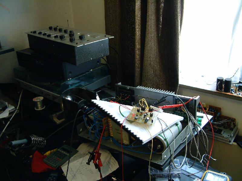

Hi all,
I've just modified my amp, and until now it has been running fine.
Like I said before I've put a resistor of 150 ohm between the two emitters of both drivers. Although I didn't pushed the amp to its limits, the problem seems to be solved.
Here's a pic of my amp (under test conditions):
as you can see I used the lightbulb trick to limit the current
best regards,
HB.
to be continued....
