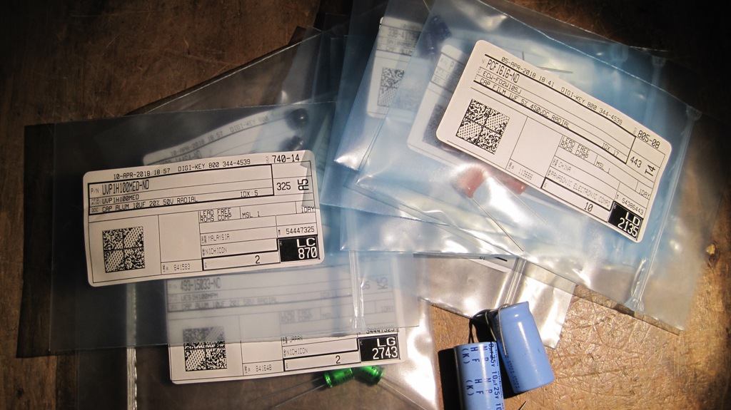

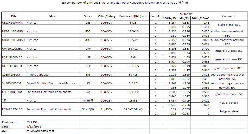

Here are actual measured ESR values of 10uF/50V bi-polar capacitors available right now from DigiKey including the MUSE ES. I've also included a 1uF/450V Panasonic ECW-F polypropylene film capacitor and a N.O.S. 10uF/25V Nichicon NP HF in the mix.
These are not absolute values and I'm not making any claims of accuracy but one can make relative comparison between products with the data provided. All capacitors were measured under the same test frequency and voltage.
As shown on the table, it is not safe to make assumptions of the high frequency performance of any capacitor especially when the manufacturer provided only 120Hz and 1kHz test data.
One interesting tidbit is that Illinois Capacitor and CDE/Mallory mentions on their datasheets about the suitability of their products for use on speaker crossover. The ESR for both shows that might not be the case.
Thank you so much for sharing. I am just sitting here with some Nichicon UVP bipolars and was wondering if I can use them for my vintage IMF TLS80, but obviously not optimum caps at all. This really helped me out.
