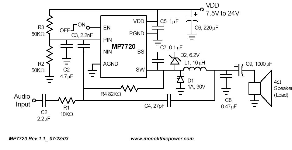

can mp7720 btl?????
how to build a AMP use two MP7720??I want buile a 2.1CH poweramp use 4 MP7720,please help me!!
thz, the schematics in the datasheets are the MPS recommended configurations. I think you can be sure that they all work...
If you want even more details check out the evaluation board PDFs posted on the MPS website. They give you schematics, part lists, etc.
