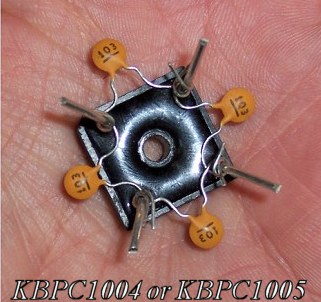

Well, if that's complicated, there's certainly a problem. See photo below that illustrates the components. This does hinder the efficiency of the diodes by several volts in this application. However, it doesn't hinder any "useful" efficiency, in my opinion. There's just less voltage peaks.
PHOTO: A snubbed rectifier.

I would say that selection of power supply components affects the sound of the gainclone. All components affects the sound of the gainclone. I had different results with standard bridges, MUR860, U860 and SB560 diodes.
The catch is not in ''golden ears''; it's just about hearing the difference. If not...then you are blessed. You can build the amp with ''what gets in your hands''.
Igla said:
Daniel; would you explain to me why are you pushing this thing with small caps? Have you some good results with that? And I mean by listening not measuring.
OH yes, by listening indeed! For audio variances, the power supply has the greatest effect.
The LM3886 presents a very light load to the power supply when it is doing only midrange and treble; however, during bass, the voltage may drop. This makes for less bass--in proportion. The effect is seen mostly in higher power applications, such as using inefficient speakers to reproduce dance music, for example. I've also had results with cooler heatsink temperatures. Its really saved me a lot of money. And, I do like good bass and an amplifier without the peakish "blare." The effect is minor, but, to me, its incredibly inexpensive for how much good it does me. 😉
I did, recently, also have some luck with a parallel amplifier, because each chip spots only half the load (8 ohm speakers, but the chips see 16 ohm). A lighter load has less power supply requirements. This effect is also minor. EDIT: The parallel amplifier sounds different (more laid back) even when used on the exact same power supply board and transfo as the (previously employed) single chip.
I think that a lot of minor effects retains fidelity better than one or more large effects. Its especially nice when you don't have to eq your solid state equipment. 😉

Daniel; I did try snubbers on rectifiers and I didn't like the result. But I have efficient and easy to drive full range loudspeakers (if this matter). By the way; the best results I get with MUR860 and SB560 diodes.
Ordinary rectifiers (KBPC and similar) gave me very different results - one was shouting with no bass; the other was bassy with moulded mids.

OH yes, that latter is close. It just needs a bit of a tuneup. Go with the bassy, sink the mids option if your amp needs to push 85db or lesser speakers, and then. . . reduce the size of and increase the quality of the pair of caps at the amplifier board in order to "clarify" (not boost) the midrange. Range = 150uF to 600uF. This way, most of the capacitance is at the (seperate) power supply board. For the last step, choose one capacitor for V+ to V- at the amplifier board (CarlosFM2005 footnotes) in the range of 2uF to 4.7uF. When its working in harmony, the heatsink temp will drop considerably. We're after a "tube taper" to the audio, which can be described as euphonic and clear. An amplifier with this nature will retain fidelity even when used to its power output limits.
IMO, don't snub "soft switch," MUR860, MUR756, MR, etc. . .

Did you try larger ceramic caps? Other types have a high internal resistance, frequently resulting in an unintentional RC network.
I have tried ceramic caps (can't remember exact value), then MKT and MKS caps (Wima and Epcos) - small values in the range of 0.01uF to 0.33uF. The result was too bright top end; somehow shouting character I couldn't stand and listen. The same thing happened not just with gainclones but also with my Pass Zen amp. Have also tried snubbers on my TDA1543 DAC power supply and didn't like the sound. I had standard KBPC rectifiers on ZEN, U860 on DAC and MUR860 and SB560 on gainclones.

Cool! That finding is a "signpost." When adding 1 cap per diode as a filter and you get a shout, the cap value is too large. Try 10x smaller capacitor value or 100x smaller capacitor value. The "shouting" indicates that you "hit" the audio band. . . so "dodge" it instead. 😉
