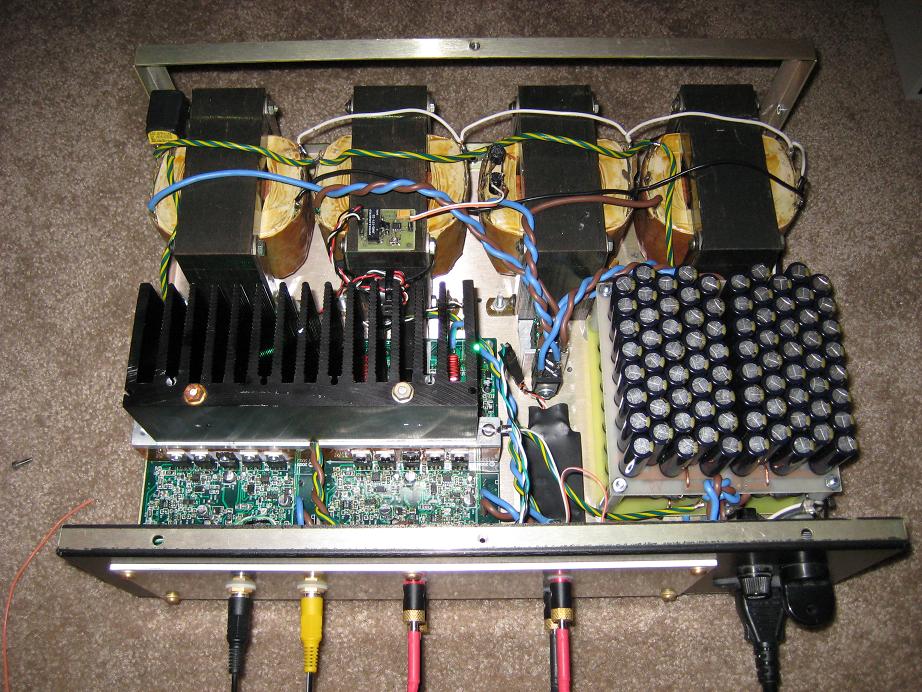

Wow, can't believe I completely forgot I have an amp I built with two IRAUDAMP1 ref boards connected to a single heatsink. That's 4 channels self oscillating with no problems.
Hey theAnonymous1,
How much does that sucker weigh? With those 4, fairly large trafos, it must tip the scale! 🙂
