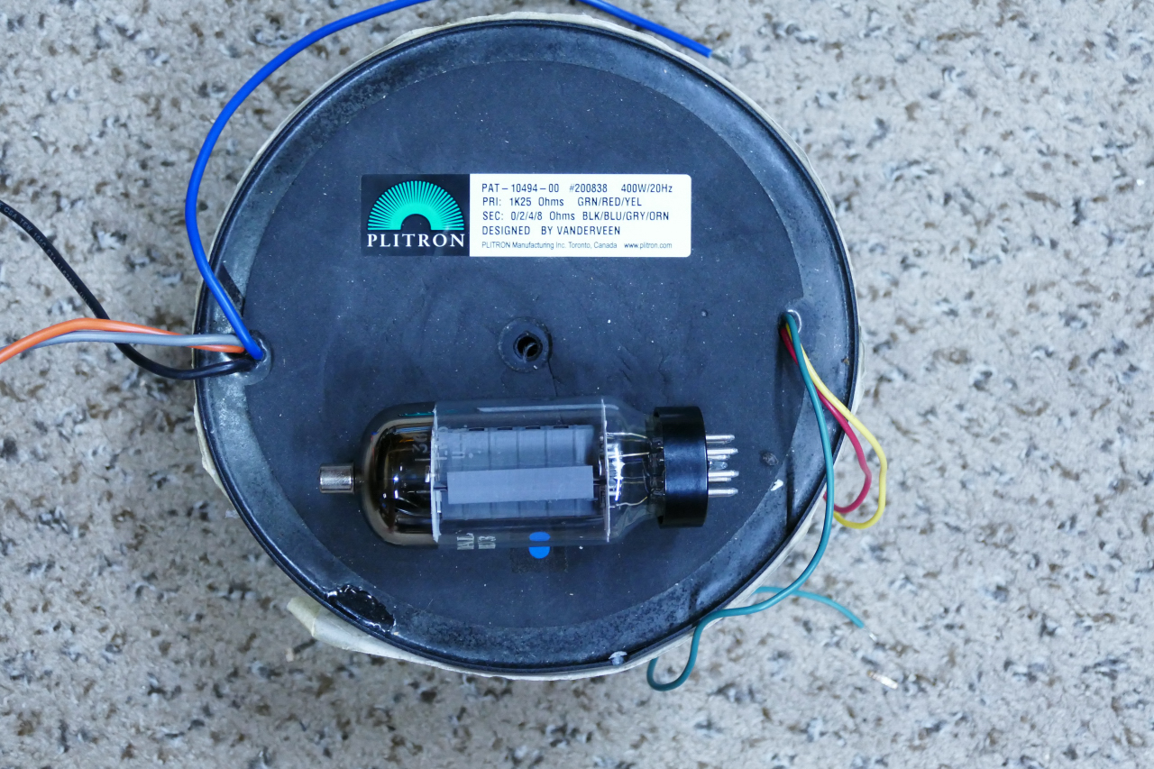

Now when you have OPT's (marked 400W @ 20 Hz) and tubes (36LW6...6 per CH) like these.........
I'll settle for 500 WPC at 30 Hz. There are two RC poles in the audio path. Each is set at 10 Hz (.1uF - 1 megohm) for now. Breadboard level testing is underway.
