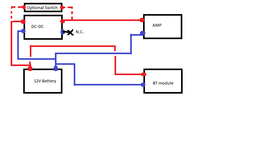

Should I run 1 large 12v battery with a dc-dc 24v converter for the amp, or 2 smaller 12v batteries in series for 24 volts and dc-dc step down converter to 12 volts for the bluetooth (and phone charger)?
Basically, what would use less energy, a step up converter or a step down converter?
If a step down would use less energy (and give me longer radio playing time), is there any draw backs to using a step down converter?

Charge your 12V batteries in parallel and operate in series.
Use a 4PDT switch.
Use a stepdown dc-dc for the BT...V7812-500
V7812-500 Digi-Key
Use a 4PDT switch.
V7812-500 Digi-Key

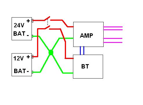

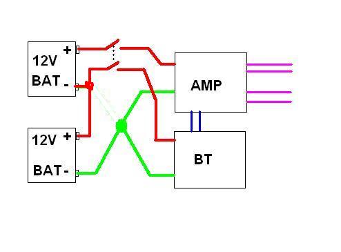

How are you going to charge your batteries if you use two 12V in series for 24V?
If you use two separate chargers then you are good to go.

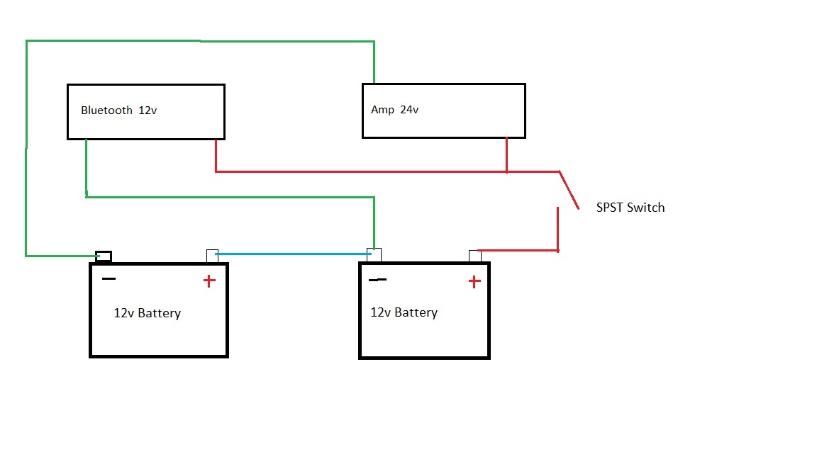

ok, so here is the new diagram of how i am thinking of wiring my set up. How does this look to everyone?
Will a simple single-throw single-pole switch work with this layout?

Looks OK to me.
