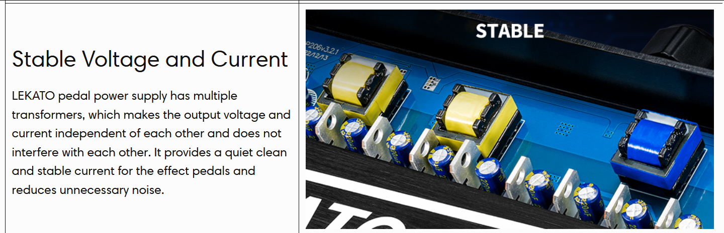

Their "CP-206" isolated pedal board power supply has two 300 and two 500 mA outputs, among other 100 mA outs. That uses a similar voltage DC wall wart input of 18V. I wonder what they're doing; DC in and multiple little transformers inside?
And, I wonder if it's the same idea in the board you're considering?

I'll see if I can learn the answers to some of your power supply questions now that I got that pedalboard (still have not connectd it - it was a Christmas gift to me. 🙂
The most likely answer is maybe. I wonder if these 9 V outputs are all individually current protected at 200 mA, or that perhaps the total current from these outputs shouldn't go over the number of 9 V outputs x 200 mA. In case of the latter, no issue. In case of the first, you should install resistors at each output for proper current sharing.
