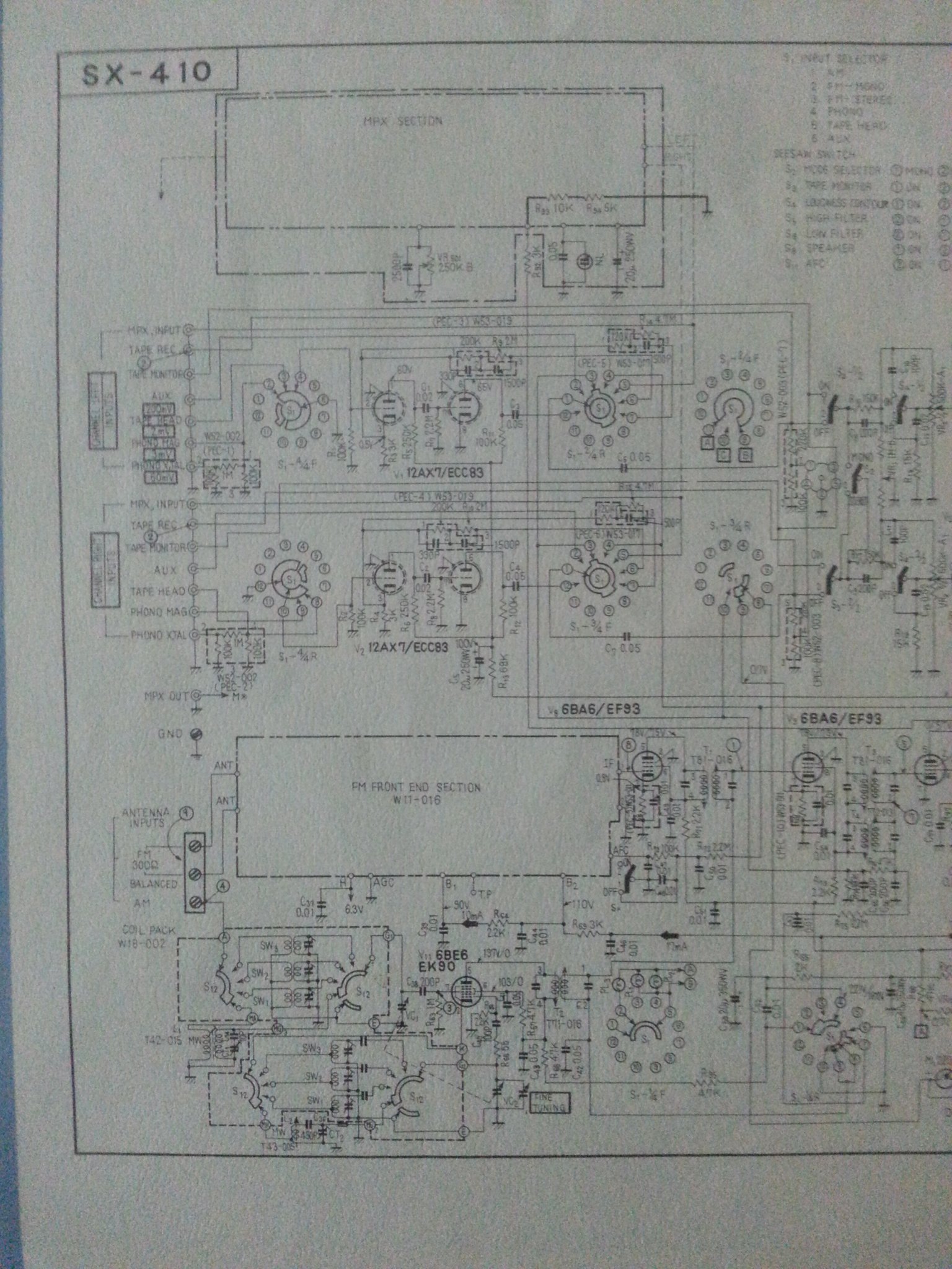

I have a problem. My pioneer sx410 valve amp does not have pre out option. Can I use the tape rec out as a pre out into an amplifier that has the option

You can, but the Pioneer tube phono stage will be loaded down too much, if the amplifier has a low input impedance,
say under 100k. If you won't use the Pioneer phono stage, then it does not matter.

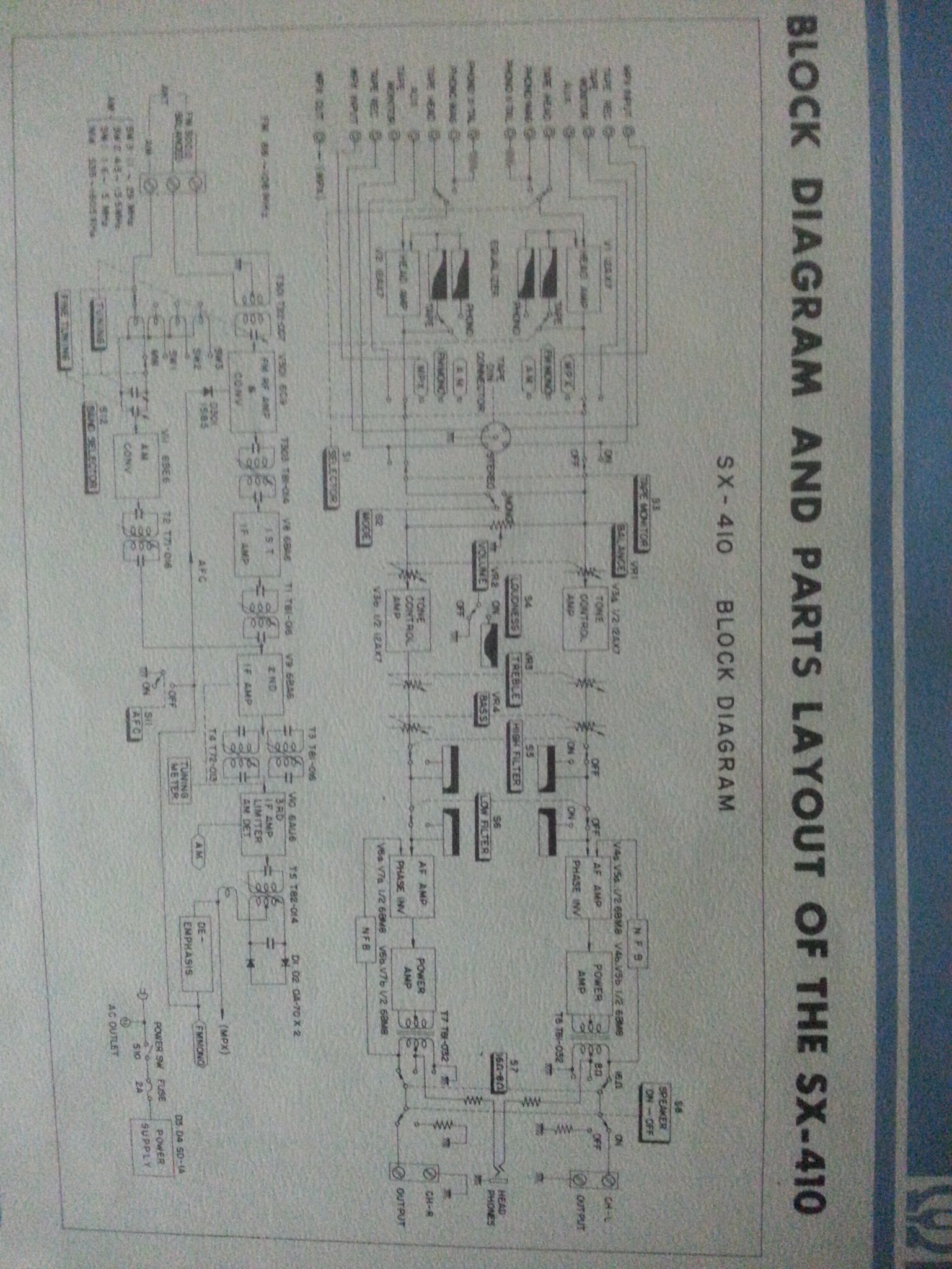

There is no active tube circuitry in the Pioneer before the volume control (other than the phono stage).
The tape out jacks are connected just before the volume control.
What is it about the Pioneer that you need, the phono stage? If not, then you don't need the Pioneer at all.
So if you just want it for switching between different inputs, that's exactly what it can do.
But it cannot control the volume. You don't have to turn on the Pioneer's power for that.

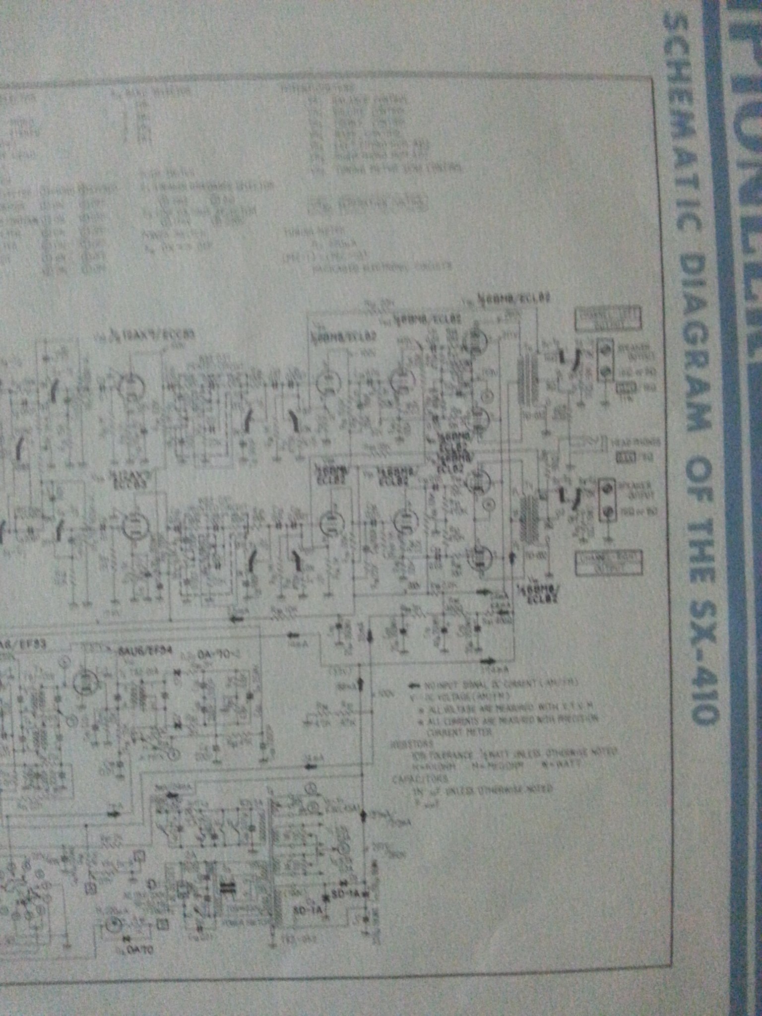

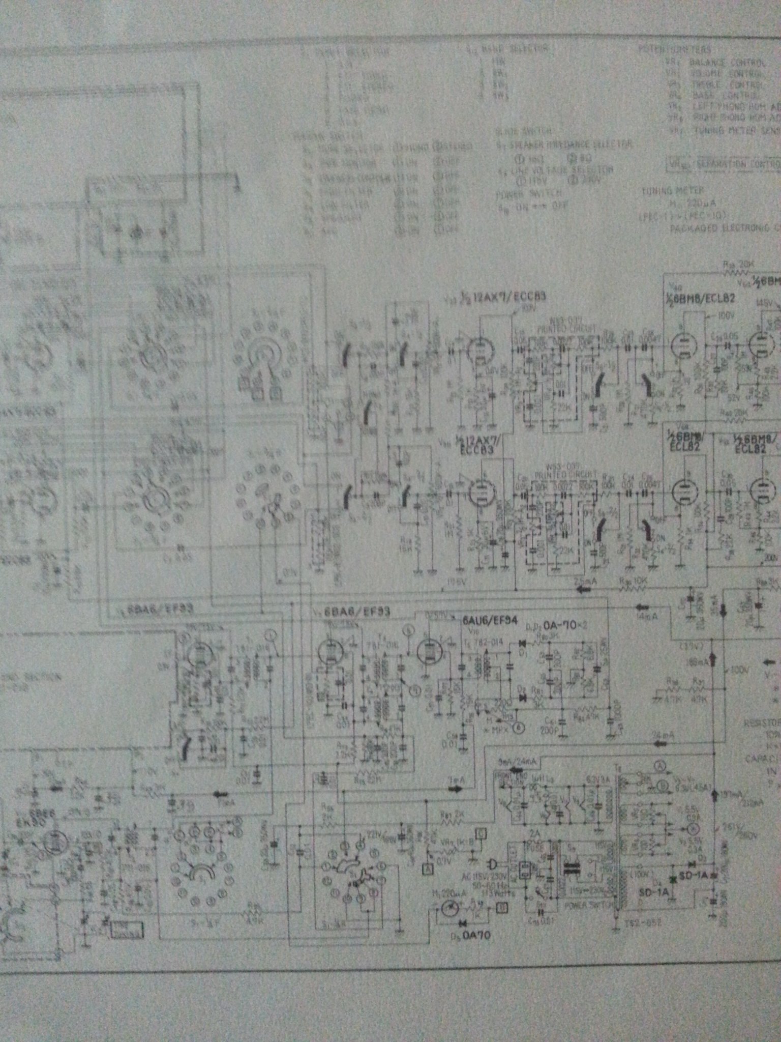

I think there's a misunderstanding here. If you don't use the phono stage of the Pioneer,
then at its tape out jacks the input signals only go through some switches. There is no valve sound.
The Sony duplicates the switching, so you gain nothing at all from using the Pioneer.
It is typical for a line stage to be after the volume control, so taking the signal before the volume control
at the tape out jacks usually does not involve any tubes or transistors, just switches.

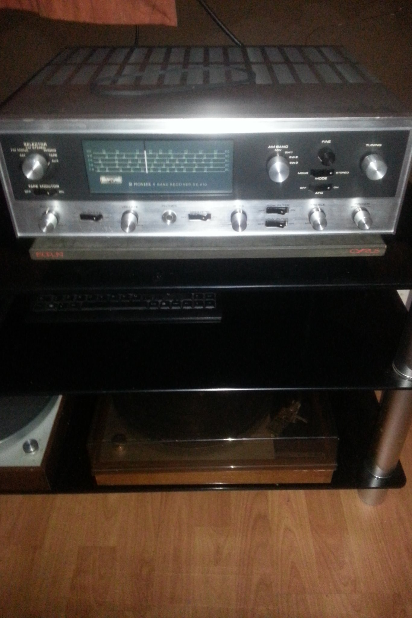

Thanks for all your help friends. .you see the pioneer sx410 gives audible sound when the volume is at 12o'clock onwards, that's why I wanted to amplify with my Sony ta1144. Do you think the pioneer sx410 needs a once over? It's valve and from I think the late 60's to early 70's. I gotta say when I got it, it was like new old stock. The original box without a dent the pioneer inside was like new mint...I should have a professional look at it?
