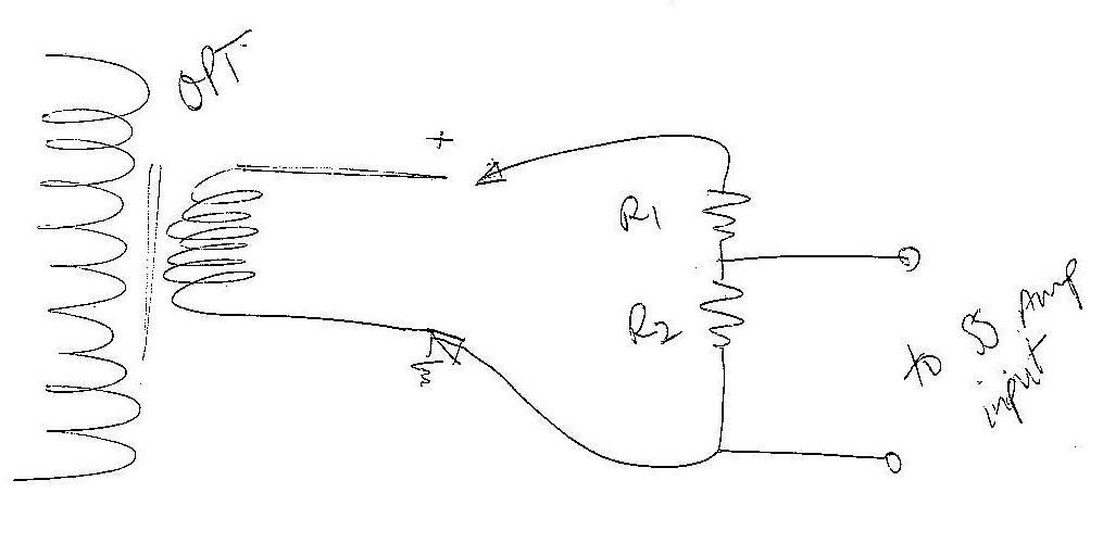

Best bet if you are still inclined to go ahead is to build a small voltage divider network with 10w resistors such that you pick up a 2Vp-p signal to take to your power amp. Connect it across your speaker outputs of the Compact and take the 2V signal to your power amp... This will ensure your OPTs in the Compact are sufficiently loaded and will also ensure you don't overdrive the power amp.

You can actually overcome this issue through the use of an attenuator/load across the output of the amplifier you wish to use as a pre-amplifier, the output noise will decrease in lock step with the signal level, the added attenuation forces you to drive the amplifier harder which results in a higher output level relative to the fixed noise sources in the amplifier, and this in fact results in an improved snr prior to your attenuator. Applying a load protects the opt, and the attenuation both improves effective snr and protects the SS power amplifier.
Before proceeding please check to see that the secondaries of your output transformers are grounded to chassis - this is mainly for safety. Should you experience a ground loop issue connecting the two amplifiers you should be able to use a single output ground as the ground connection point for both channels going to the SS amplifier. Hopefully one but not both of the amplifiers have AC safety grounds as this reduces the likelihood of ground loops. (Subject of another discussion..)
In this case a simple two resistor network combines both the required load to keep your output transformer(s) happy and provides the required attenuation. Using commonly available resistors you could attenuate by 6dB with two 4 ohm resistors in series (5W resistors should suffice) or for closer to 19 dB of attenuation try an 8 ohm resistor in series with a 1 ohm resistor. 5.6 and 2 ohms will give you about 11dB or so and might be a good choice. (Just the classic voltage attenuator realized with decent quality power resistors.) Use a good non-inductive wire wound for best results - the sand filled types IMO do not sound as good.
I would guess you probably don't need a whole lot of gain here, but might be looking for the ability to drive the input of the SS amplifier more effectively than your passive attenuator allows?
As long as you load the tube amplifier properly and attenuate the signals to the solid state amplifier so that you do not drive it into extremely hard clipping accidentally this should work fine. How it sounds depends heavily on the performance of the tube amplifier.

"In this case a simple two resistor network combines both the required load to keep your output transformer(s) happy and provides the required attenuation. Using commonly available resistors you could attenuate by 6dB with two 4 ohm resistors in series (5W resistors should suffice) or for closer to 19 dB of attenuation try an 8 ohm resistor in series with a 1 ohm resistor. 5.6 and 2 ohms will give you about 11dB or so and might be a good choice. (Just the classic voltage attenuator realized with decent quality power resistors.) Use a good non-inductive wire wound for best results - the sand filled types IMO do not sound as good. "
Forgive my ignorance, but why wouldn't I just use a single 8 ohm resistor ? Am I supposed to attach the series junction point to the input of the SS amp ?

like this Blake - you are building a voltage divider to feed the signal to the SS amp

Basically I did what was mentioned above with the voltage divider. You do want your tube amp to have a low impedance load, so choose 8 or 16 ohms. The input to the SS amp is going to be 10K or more.
Then figure out the voltage it takes to get your solid state amp to max power - or whatever point under that you wish to achieve. Let's say it's 2V RMS. Now you know how far you need to push the tube "preamp". With your 6V max output, you probably don't need to divide more than 1/2, maybe less.
The reason to do the dividing is to lower the noise floor coming out of your power preamp. Kevin has explained this well earlier. With your 6V max output, that means about 5 watts across 8 ohms. So 10 watt resistors will be just fine as your divider load (as mentioned earlier).

I just wired up the voltage dividing network today , with some 25W 8 ohm resistors I happened to have .
As was mentioned , noise floor was somewhat apparent (hum as soon as tube amp was turned on) when you were close to the speakers, but not really noticeable when in listening position.
