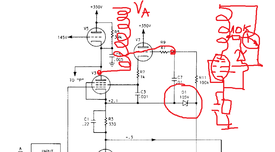

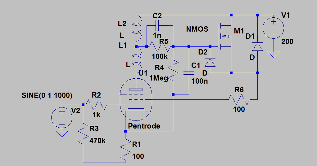

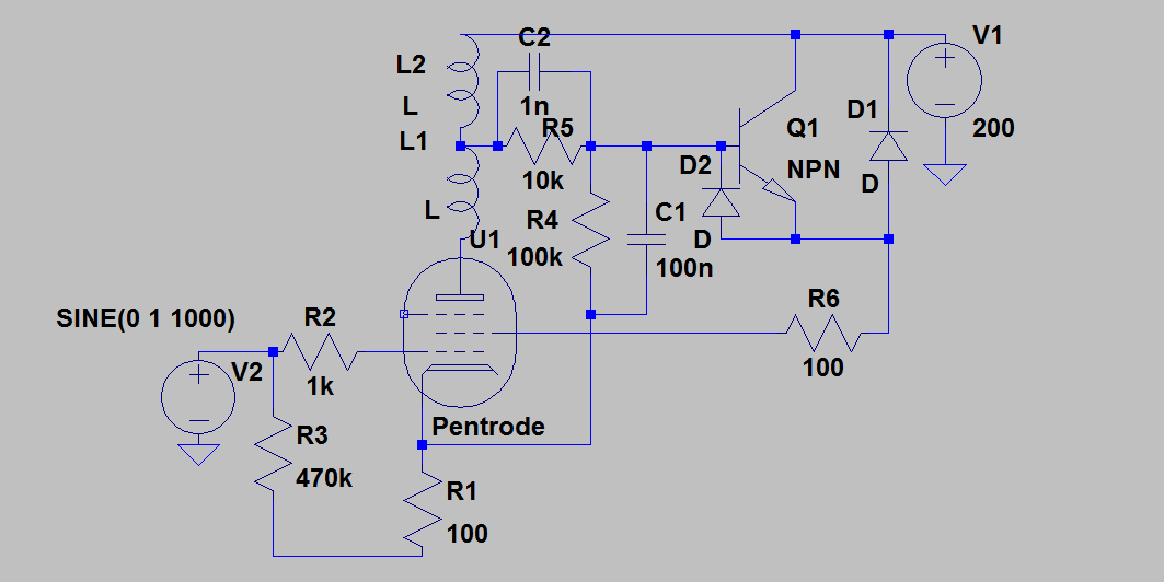

here's an ultralinear tektronix scope stage modified for your needs, but this way you loose the linearity itself so something better would be to use a resistor divider in the base of a transistor.l2dc resistance is much lower than R5 so the resistor divider will set the real dc level while ac levels should be the same.it's just that now the screen tap impedance is much higher and you might need a different tap ratio for the best UL THD.
thanks

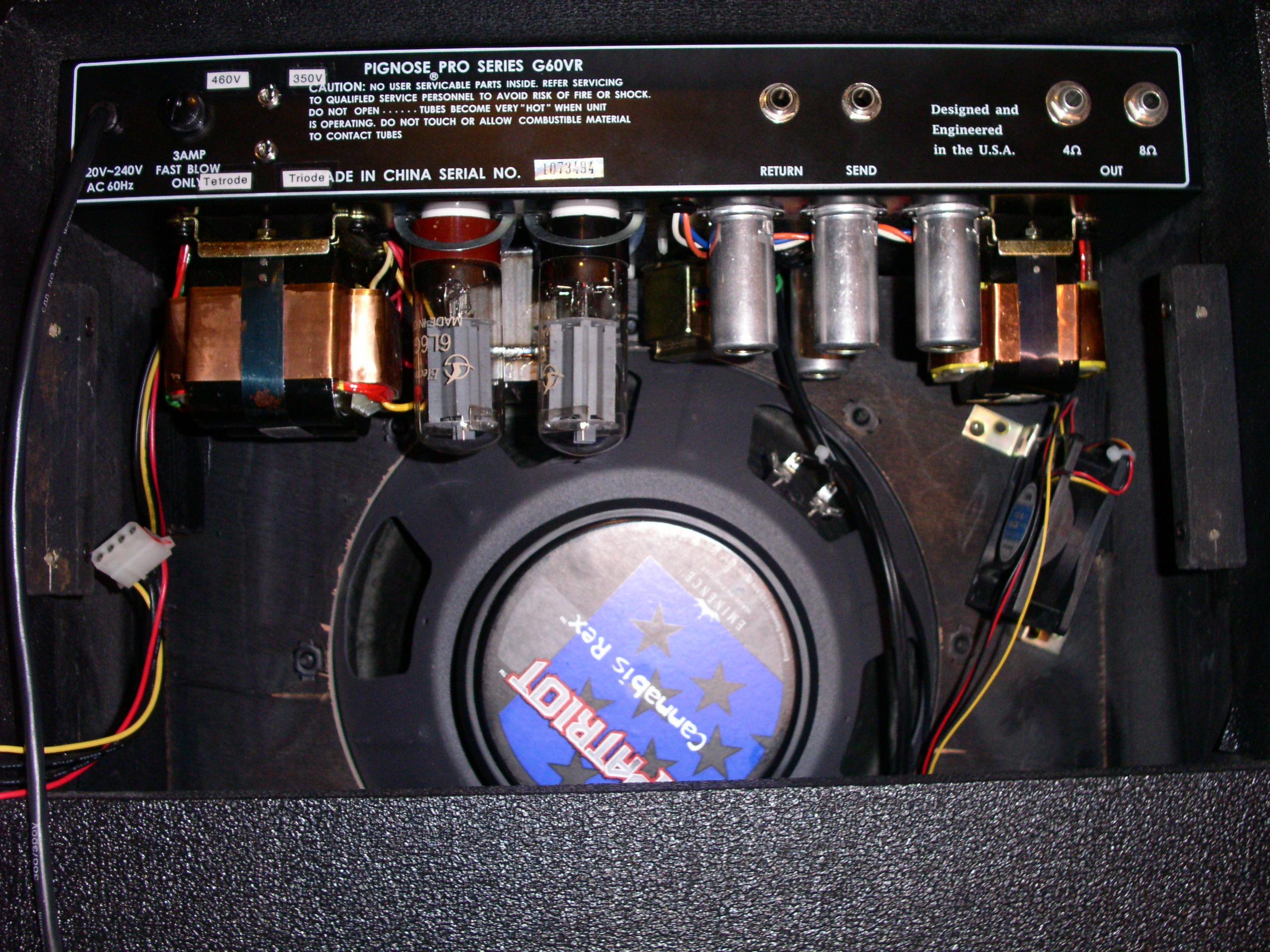

I have this Pignose G60 guitar amp for 17 years now, still with its original tubes. My initial plan was to replace them with some American NOS, but the Chinese tubes have been holding up so far, with a nice tone too; they have 450V on the plates and 436V on the screen grid (non-UL).
