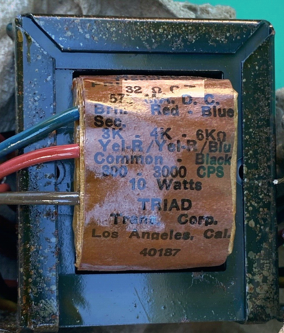

With apologies for the "revival", the reading/research suggests that reverse driving a modulation-transformer (e.g. Hi-Z secondary made the primary, and Lo-Z side then matching the speakers) would work in a p-p... with minimal saturation concerns, lacking persistent DC current. My question is; what-about S-E operation?
That is, does an informed member of the forum happen to know if these modulation xformers are typically a gapped xformer design that could withstand a small amount of DC? I've been specificially researching a 10W TRIAD TY-65Z, but can find no reference to its laminations being gapped or not. I'm confident of its use in push-pull, but might just have to measure inductance with the introduction of DC current - once I get one - ...unless someone knows for sure! THX
If there is a DC current spec, it should be clear if it is gapped.

I would also like a link
Link to your own post #7, Jan. The box picture clearly says 32 Ohms. Another image from eBay also says 32 Ohms.
And 8 Ohms is conveniently half of a 32r winding.
If you do math, you see that 10 Watts in 32 Ohms Center Tapped is 12.5 Volts Peak. Which tells you when and where. A car (small truck, boat, etc) in days when power audio transistors were practical, but RF had to be kept in tubes. That may cover much of a decade; I did not keep in touch with RF those days. Bottles probably lingered in civilian work after military apps moved to transistors for small and rugged. Clearly the 2nd image above is post-1963, and possibly several years later (Triad probably did not run a batch very often, would sell from inventory even without a ZIP code.)
