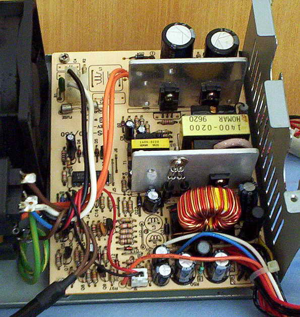

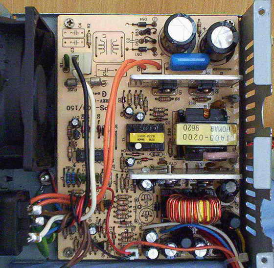

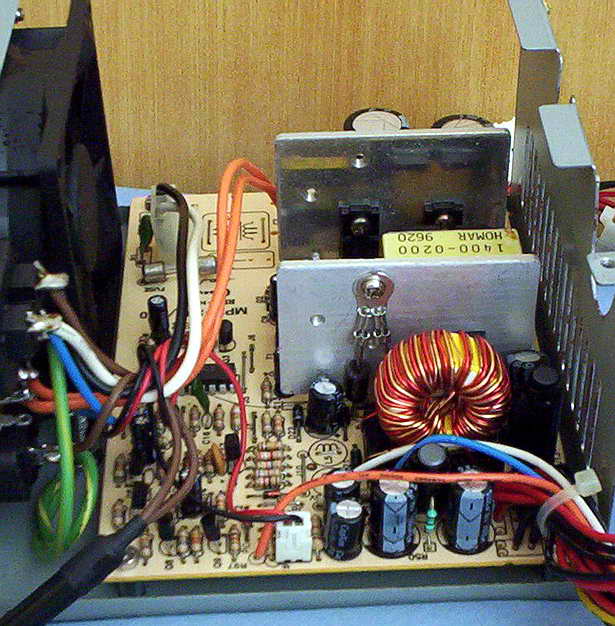

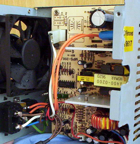

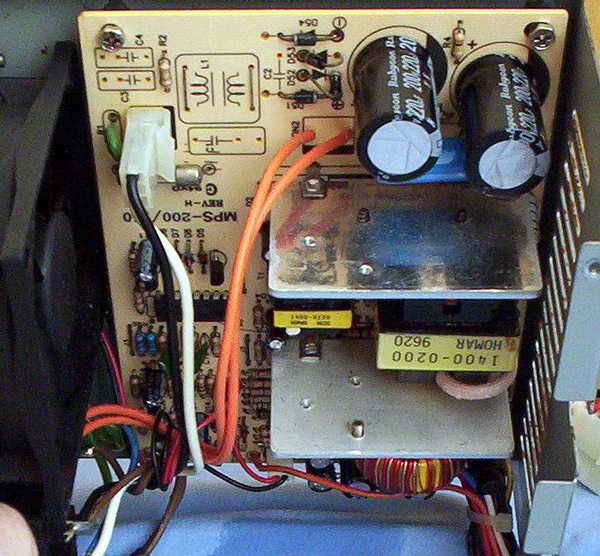

I have already made some modification to use as a Radio Amateur, 13.8 Volts - 16 amps
But i made it using an sketch...was not my idea, i do not understand those switching supplies very well.
I remember that i gave it to a friend, as it produces some carrier beating with my receptions...alike a frequency marker.....do not remember exactly, but i think was 30 or 40 Kilohertz the carrier generated by that supply.
regards,
Carlos

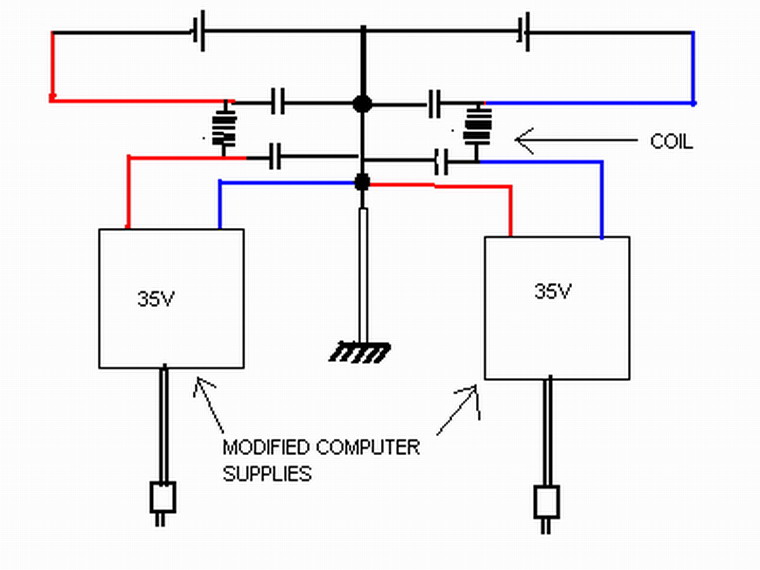

Worst than that, i suppose that 2 supplies will create two signals to beat .
those signals beating one with the other will produce a big mess....well, i do not know...reason i am asking you guys.
I am sure, even with small knowledge, you may be better than i am related those supplies...i do not understand nothing about them...i have an idea of the operational work only.
regards,
Carlos

LC filters in the output of a SMPS are fine as long as they are damped. Only filters with considerable resonance peaks will cause trouble.
By the way, those PSUs may be modified for 35V or even +-35V output, but that will require to rewind the transformer, new output rectifiers and to redraw the secondary side of the PCB.
I have been tempted sometimes to develop some easy to build SMPS with symmetrical outputs in the 500W range (where computer PSU parts and cases could be employed), and publish the schematic, board layouts and all the data for DIY. But I don't know if it's worth the effort, and these circuits have to be built and tested with great care due to the mains isolation requirements, so it won't be suitable for everybody.
You are correct, but I have seen both Buck/Boost and standard buck converters misbehave when a damped output LC filter was Deployed. I had to redesign the loop to compensate for this problem. The loop work is not always needed, but it is possible that it can be necessary when modding something.
You also have to carefully design the filter so that it infact works in the freq area where the noise is present, something that can be difficult without a scope/spectrum analyzer.
I think a modded PC supply could be a nice idea, but I would rather construct something from scratch...
Maybe next year ;)
\Jens
