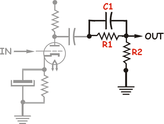

I found this circuit, and I would like to know if it would work for me in an PV 60/60, or somebody could point me or help in some-way.
"Hi-Fi tube amplifiers often have no tone controls, and carefully design the stages to have a flat frequency response."
Tone controls are typically next in the circuit, and probably yield the most options for tweaking. The early Fender amplifiers used a simple, crude treble 'cut' control (still labeled 'Tone'), like so;
Crude 'Tone' control is actually 'Treble Cut'.
The Treble Cut control may not necessarily be in the preamplifier stages. Vox put a similar control across the output tubes. Typically, the 'Treble Cut' control is a 500K/1Meg potentiometer, with a .005uF capacitor. The capacitor value is wide open for experimentation. It can be used for a very subtle treble cut, or a 'Deep Rhythm' tone,

You can always hang EQ things on circuits, but this is a power amp, its whole job is just to amplify your signal. What would the purpose of adding tone controls there be? IS there not enough tone control in the signal source?
