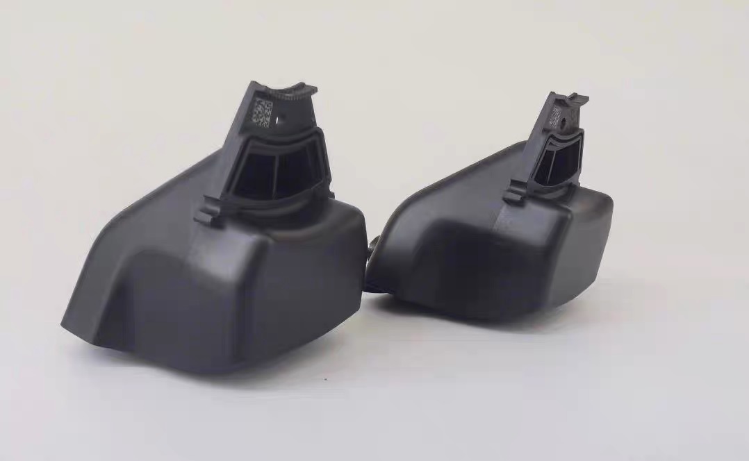

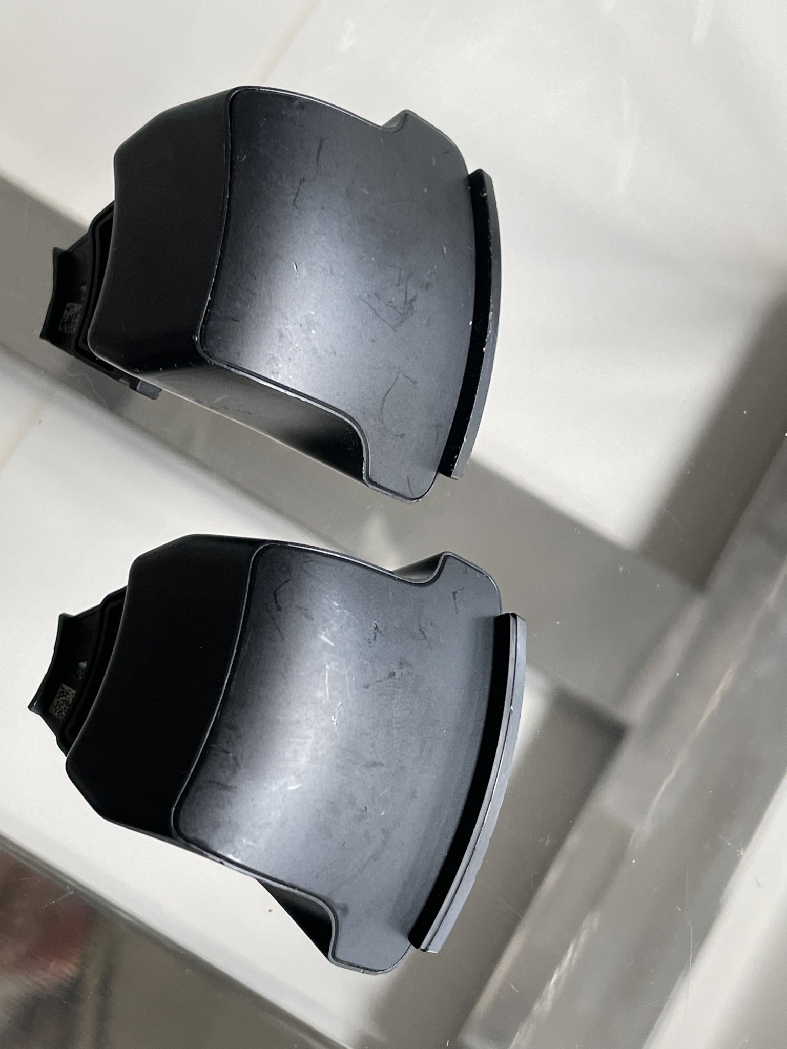

I wasn't able to find any information about these tweeters on eBay so I am not sure what you are dealing with here. On the face of it they look a bit unusual, can you share a few more detailed pictures? (I admit I am really curious)

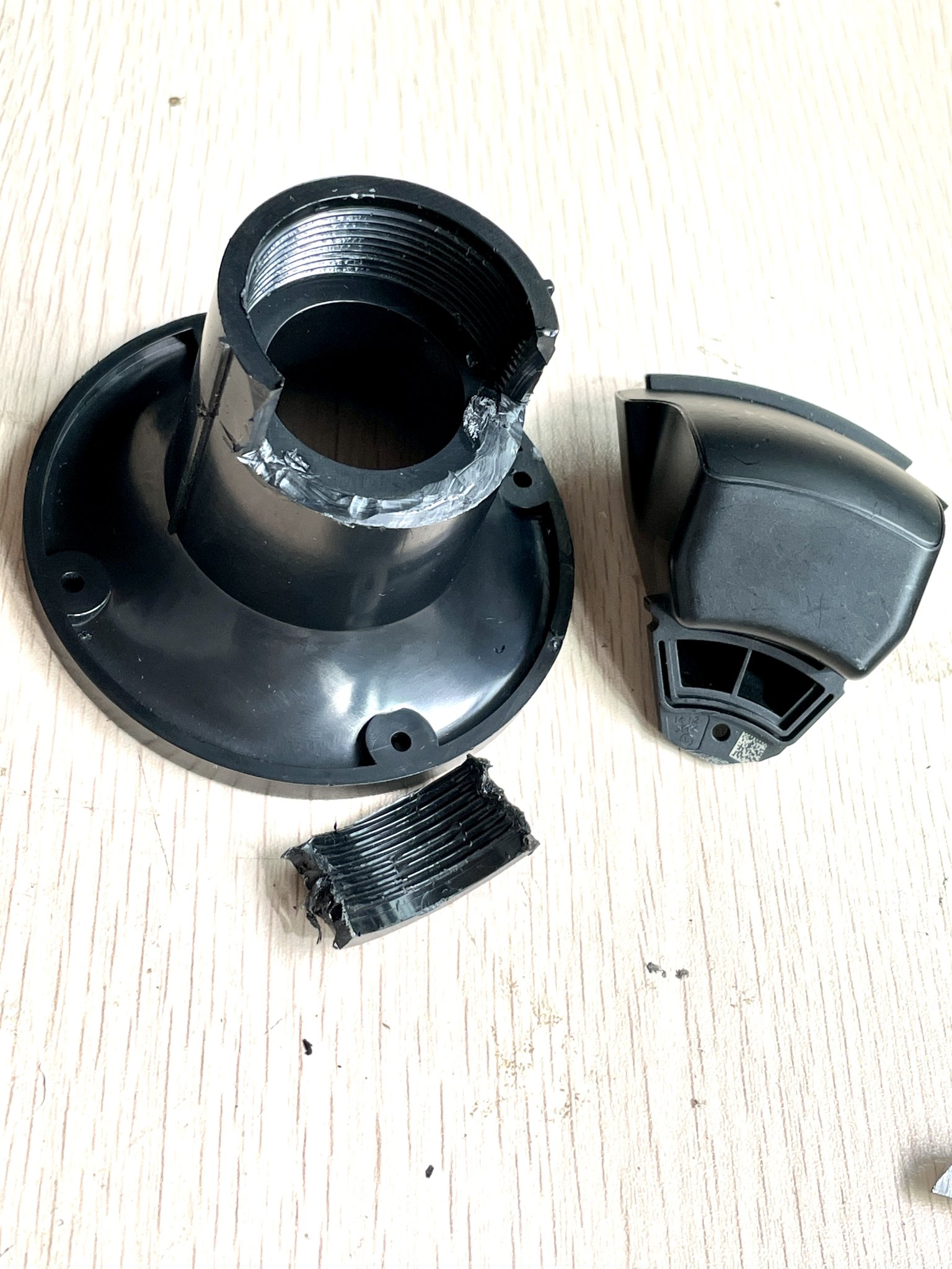

This is dismantled from homepod 1,very difficult to fix into DIY casing, so I modified the fitted into another horn.
