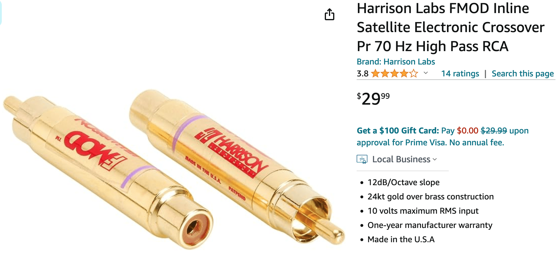

I am using an Audio Research LS25 MKII. It has switchable gain settings for 0, 6, or 12 db. I typically use the middle,(6db) gain setting.
I need the volume set at 3 O'clock to get a nice, satisfying, sound in my listening room. It is right on the edge. Any louder and I have to run for the volume control due to the little 5" mid/woofers on the sattelites being overdriven. The Infinity Modulus,(original 1990's model), are rated at 125 watts with minimum suggested at 25 watts. I estimate I have maybe 40 watts at 5 ohms of clean power from the F6. Not much headroom for my classic rock LP's, although biampling helps.
