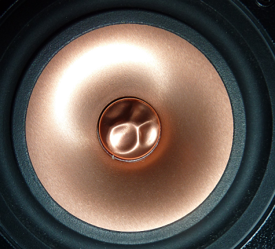

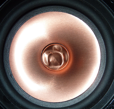

Hi there, here comes some pictures and I just want to show my A7.3 with pushed in dustcaps. My grindchild 3 years old watched TV and suddenly the music stopped, so she pushed the "Button" several times on both drivers.....
I have tried Daves tips but the center cap is so stiff, escpecially when it´s already wrinkled. I think that it will cause more damage to fix it. Paper may work but metal is not easy to model in the way you want. Anyway I have a pair of Daves A7.3eN for my FH3s. Soundwise the old drivers are not so bad, but it will take a while for me to fix speaker covers.

Anders,
If that trick did not work, then time for them to come off. Then build some phase plugs for them… even if just a felt plug.
dave
Thanks Dave, great idea. I´ll make som surgery and add a pair of black phase plugs.
Anders

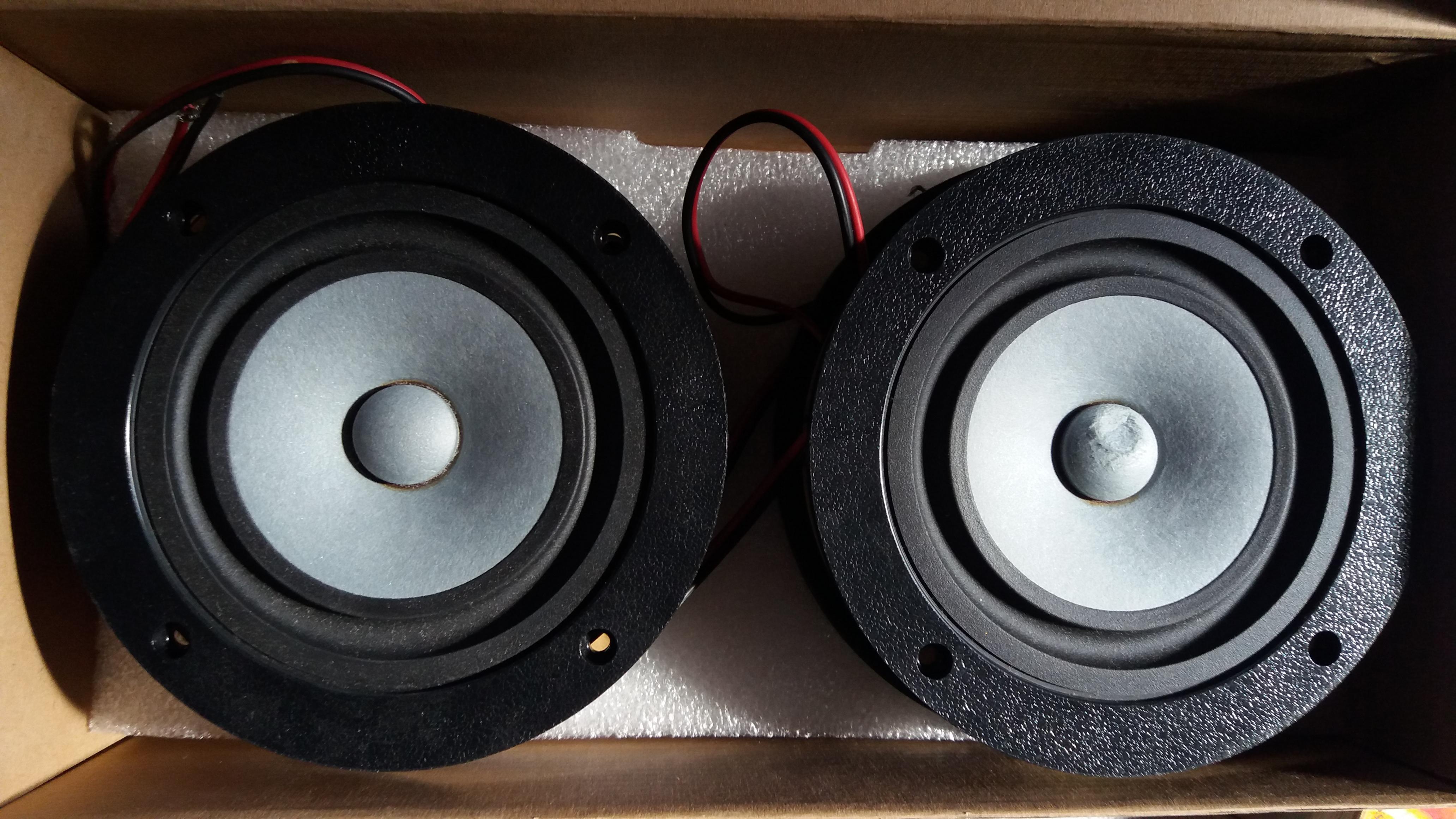

Hi .. Attached is a pair of Alpair 7P speakers, where one of them got a dent when a kid poked his finger on it.
I tried to restore is by sticking a tape and pulling it out but it was not working and instead it was causing bad effect on the speaker paper.
Could you please suggest how to restore it.
Is a dent like this, a cosmetic issue or does it impacts its sound also?

That one is bad enuff that you have to try making it concave or removing it. It may be possible to get a new dustcap from MA but i suspect that you won’t be able to get the glue off, making the fixed driver a different mass. I wil probably sound different.
Most drastic step, and possibly needed is a dustcapectomy. Then adding a phase plug or something to fill the hole will be needed. The top end will change.

The dust caps on those pictured MA drivers look like they're metal or some kind of composite based on the way they dented. I highly doubt they'll sound the same even after fully pushing out the dents. In the case of metal, it will never be as rigid as before and you would have annealed the material. Most of tge time that sort of cone will be glued with a UV cured adhesive, so its not going to come off without hurting the cone itself.
I understand accidents happen, but those dents are more than a curious slip of the finger. Those things are mutilated. At least I taught my son to never touch the guts of a speaker and he has never been tempted even though i always play mine with the grilles removed. I dont get it how parents can't teach their kids not to touch expensive stuff especially from a stranger. Hopefully that kid never comes into contact with a beryllium tweeter...
