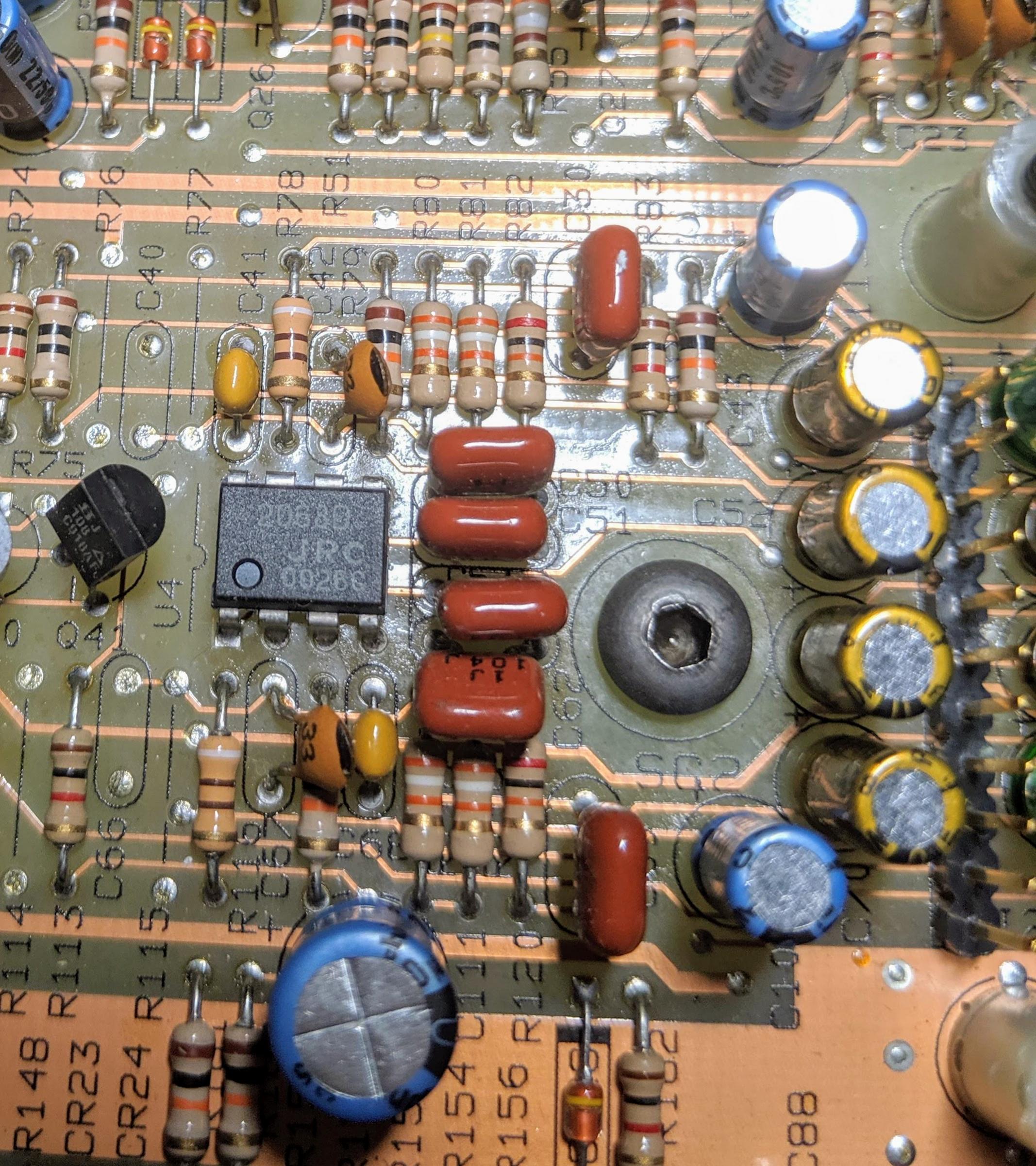

At this point the amp sounds great but I was curious if I could tailor the sound a bit more by swapping the OP amp. It uses a JRC2068D for what I believe is the input stage and I was thinking of replacing it with a LME49723. I have a good quality socket to install and plug it in (via SOIC to DIP adapter) but wasn't sure if it was also a BJT, which as far as I can tell from the research I've done, the 2068 is.

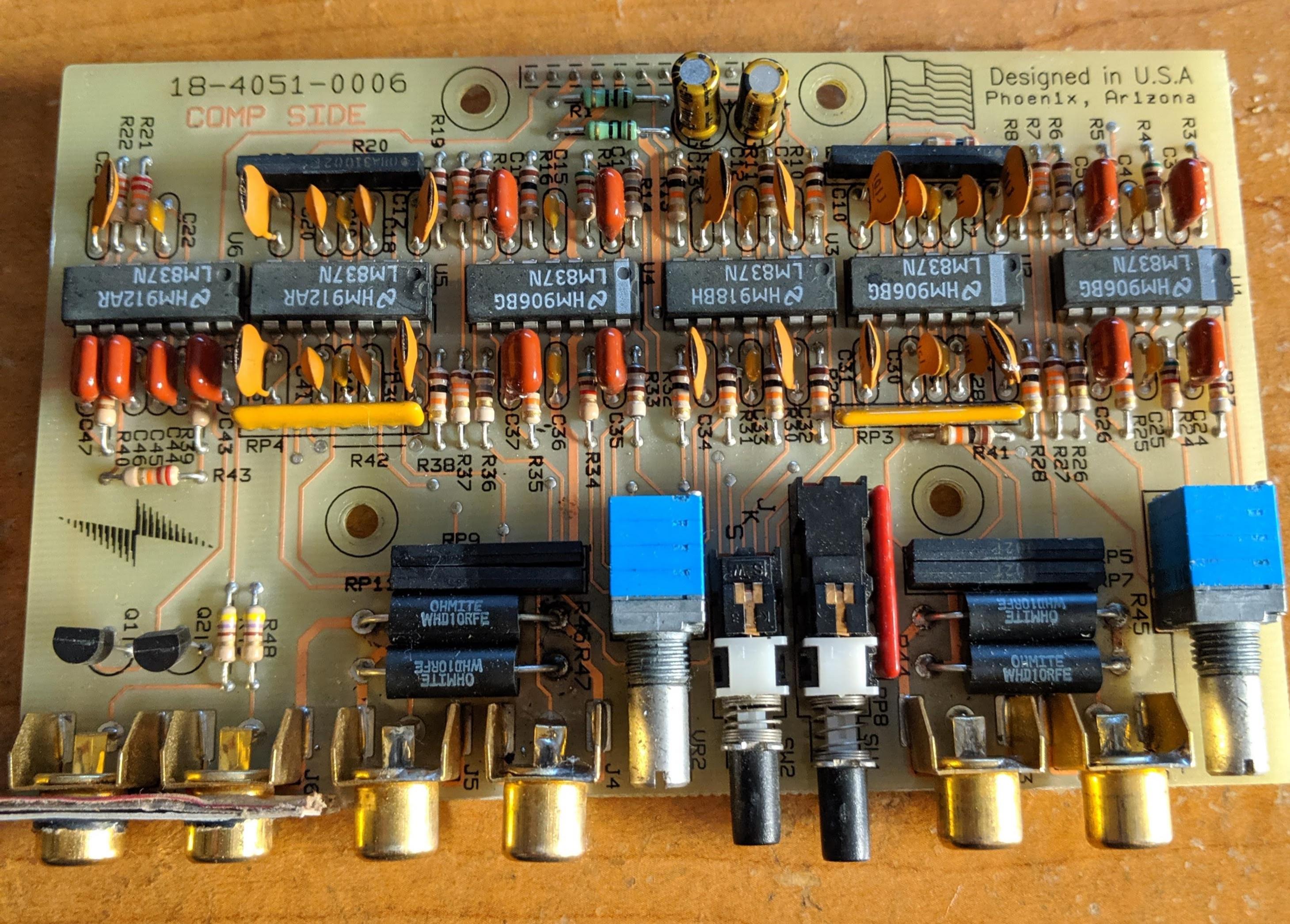

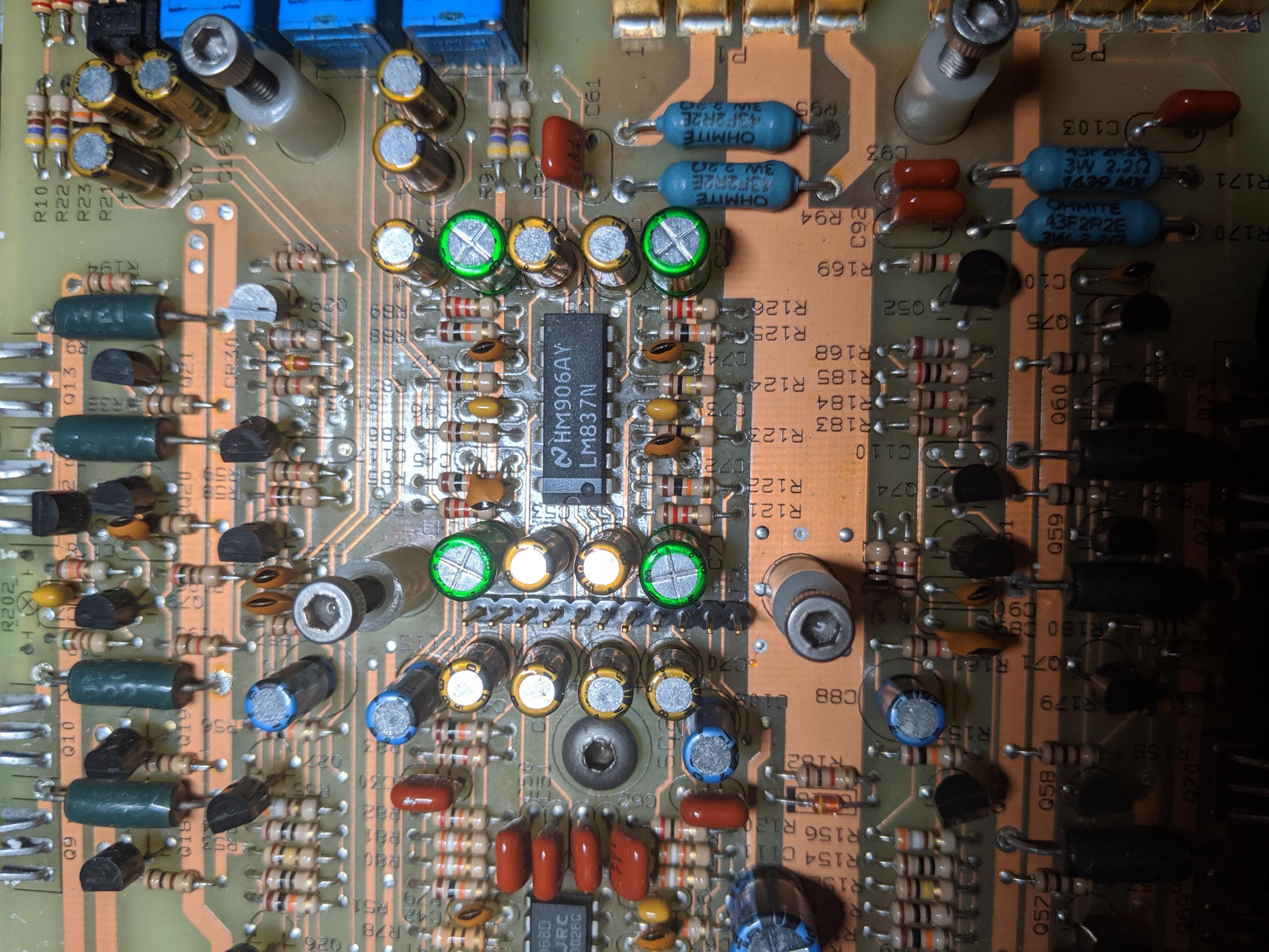

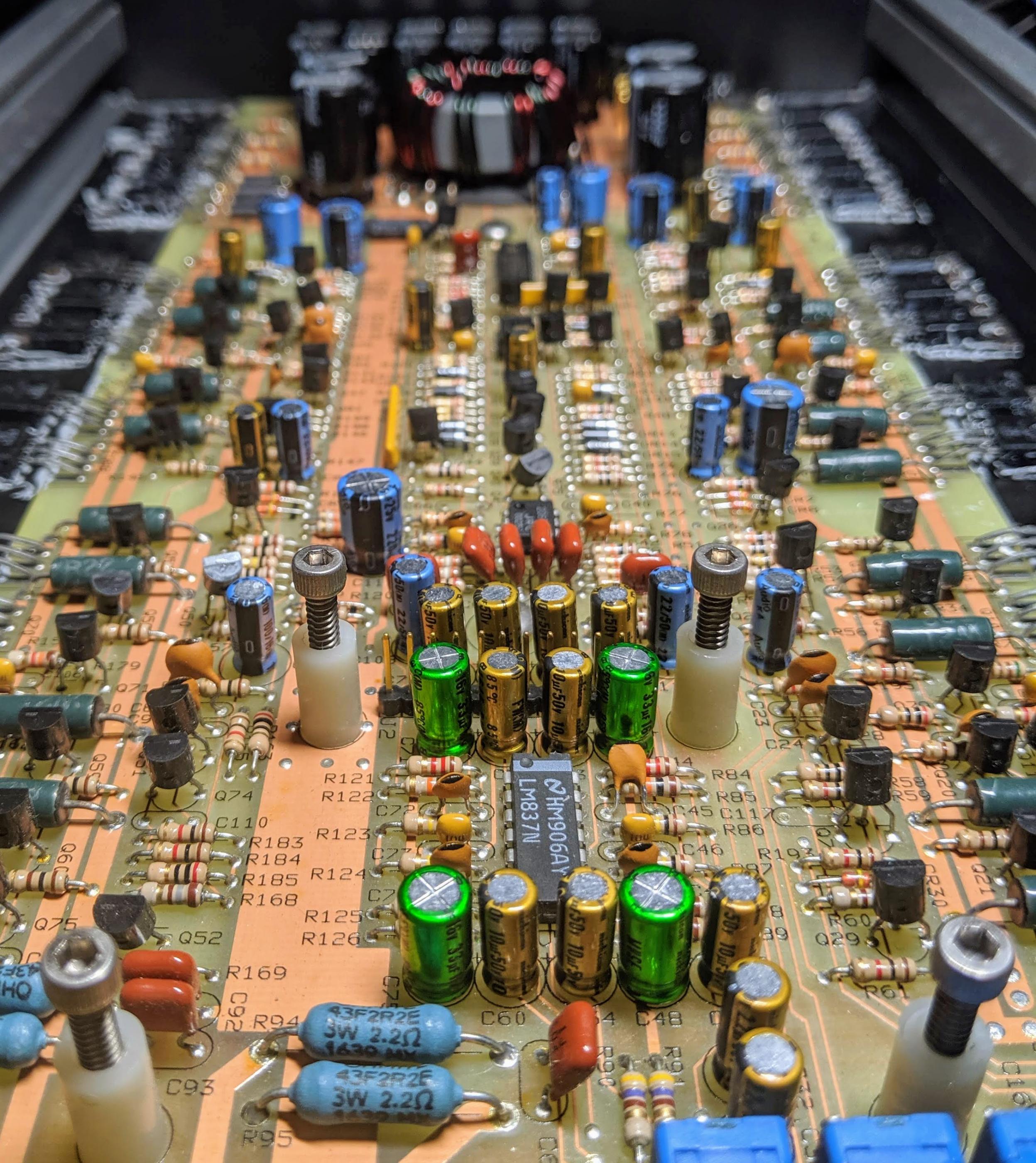

I'm now realizing I'm completely wrong, a 2-channel op amp can't possibly be the input for a 4-channel amplifier that has a separate input for each channel. So the LM837 on the board I'm guessing is the output and the 6 other LM837's on the actual pre-amp board are the inputs. Would a OPA1664 be a suitable replacement for the LM837?

Just thinking aloud: non Designers often think that a better design is the same old one but with "better parts"
It ain´t so.
Best case, nothing will audibly change (although sometimes a delicate Lab test might find some minute difference) , worst case you can degrade performance, even make amp unstable.
You are right, I'm nothing close to a circuit designer/engineer, I just like to learn by trying different experiments. Comparing the LM387 to the OPA1664 on paper shows that it is compatible, so shouldn't degrade performance then, right? The differences that appeal to me are
  1. Higher slew rate: 17 vs 10
  2. Higher gain band width: 22 vs 10
  3. Lower noise voltage: 3.3 vs 4.5
  4. Lower THD .00006 vs .0015 - although I'm sure inaudible anyway
Otherwise, output current is the same at 40mA per channel for both. I understand that I may never hear the difference but that's part of the reason I'm wanting to try it in the first place, to see what happens.
The 1664 has a higher bandwidth as well, I’d say it’s worth a try, but still no guarantees as to how much the better part will be realized, or how much the rest of the amp will be a dominant factor.

5. Higher current noise, 1pA/√Hz v. 0.7pA/√Hz
So the overall noise may well be higher, not lower. You'd need to check the flicker-noise knee freqs too.
The decoupling requirements for the two chips might be different. Also the need for stabilizing capacitors in feedback networks may differ between the chips.
