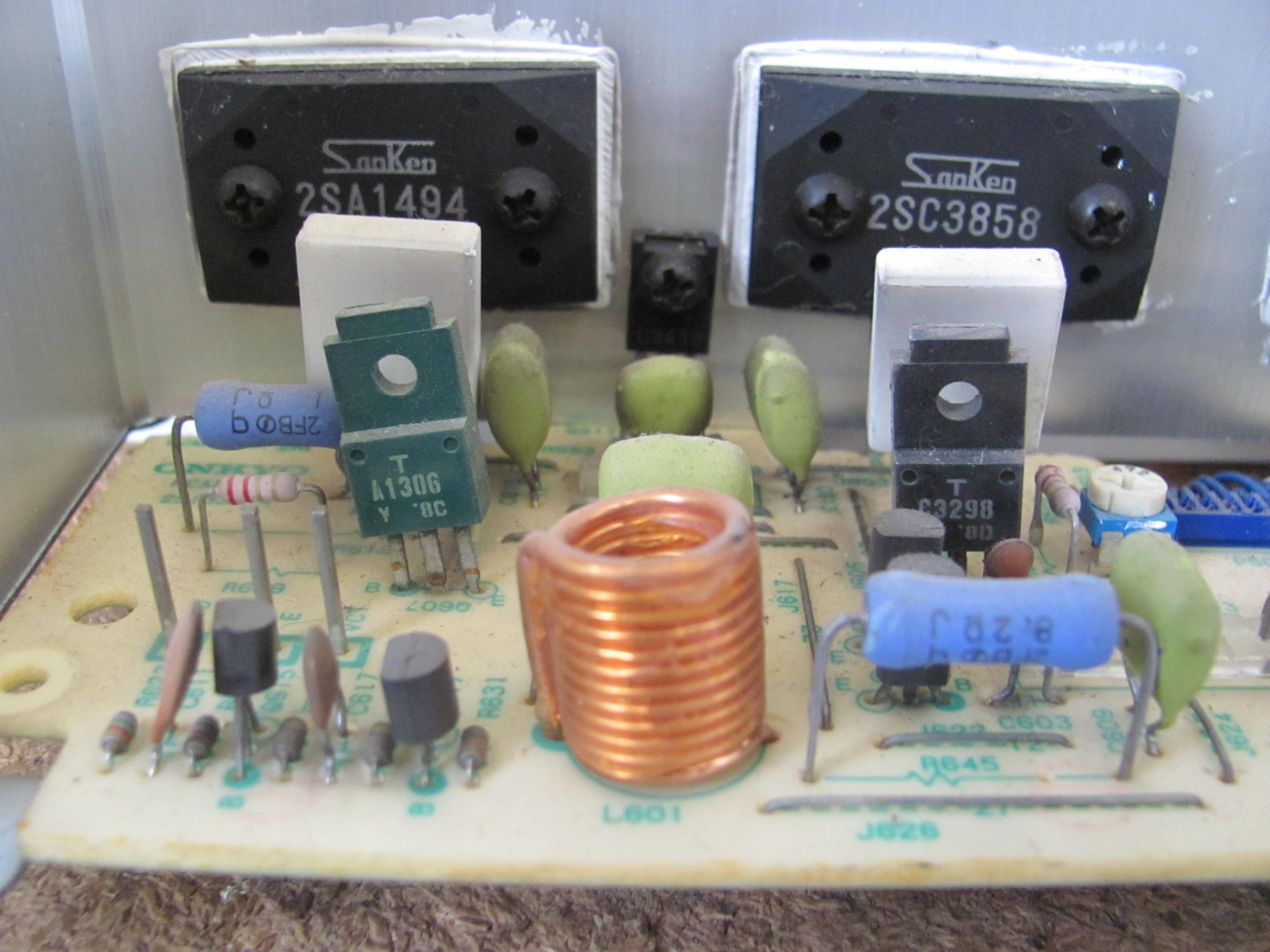

Well Sakis, i have this board to pull this transistors and use them in my amp, but maybe i can find some new originals still around here in my country...
Those and many more ...now days we repair about 1000 audio devices per year mostly amplifiers
before i got this stock most of the times we had to modify amplifiers similar way like you are trying and go as close is possible but we consumed time and we had to long run and evaluate changes from any aspect like stability oscillations and /or others ...
Now i am offering my customers original replacements at a very expensive cost but they get to keep amplifier very very original in case they like to ...So i make money with this and also i save time since the original you only have to solder them inside measure offset and bias and you are sure and done within minutes ...
I have about 30pcs of 2SK150 another 20 of 2SK34 ( very rare ) and about of 100 pcs from 2SC 1000 or 2sc1313 all of them extremely rear to get in original condition ...
I think in the near feature i am going to have so much fun with those and money also .
I showed the parts in my every day semiconductor supplier here in Greece and the guy actually started to cry !!!!! ( i offered also to sell to him at 10 euro a piece )😛😛😛😛
