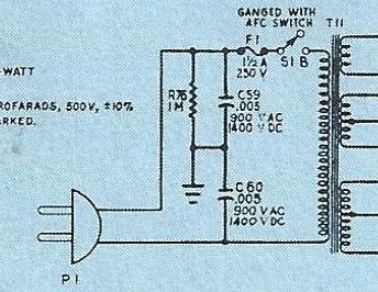

Below is the line filter of an Ampex tuner I'm working through:
During recap I'll be replacing the two .005uf caps between the line and ground with type Y .0047uf safety caps. Can I clip out the 1meg resistor or should I leave it? Why is it there to begin with? Thanks

It looks to be a safety feature to discharge the caps and stop the user getting a little shock from the mains plug... which is very common actually. Those caps are tiddlers, its more of a problem with 0.22uF or 0.47uF caps which have been used in the past in some equipment. Those can give a nip to the unwary.

In the UK those two caps have to be small otherwise leakage to earth breaks EMC regs.

I was beginning to think that was the case. Looks like it wouldn't discharge if the tuner was plugged in backwards though. My concern is that the resistor is going to put some potential on the chassis, and while I know it's not lethal I just don't want it if I can avoid it. The tuner is part of a console system and will always be plugged in through a preamp/control center so I'm inclined to remove it.
As shown I see the resistor as a safety issue. I assume the unit has a 2 wire plug here and no Earth.
If the mains 'Live' is connected to the conductor going to F1, then when the unit is switched off, the 1 meg resistor connects the mains live to the un-earthed chassis...
Surely better to remove the resistor and move the cap C59 from the 'plug' side of the switch to point B on the diagram. Then the caps are only used when power is on (not all the time the unit is plugged in) and there is no need to bleed them via a resistor, as the transformer will do that.

Yes I was planning on also moving the cap to the other side of the switch. Having components in front of the switch (or fuse especially) gives me the heebie jeebies.
The console's preamp/control center only has provisions for 2 pronged plugs but I will look into other ways to earth the system as a whole. I will be putting a grounded plug on the control center for sure.

The only thing I would do is move the components across the AC line to the transformer side of the fuse...if one of those caps shorts out, the most damage will be a blown fuse. Unfused components across the wall plug should be a matter of concern....
A lot of not very helpful responses to a reasonable question.
The resistor is likely not a UL recognized component and if it fails mains AC could appear on the chassis, not a very desirable state of affairs. (UL would fail such a design today if there was any conductive external surface connected to it.)
I would also ask where the 120uA of current injected into the chassis is actually going, I have had old tuners using this scheme that injected hum and noise into an audio system, sometimes even when tuner was not selected.
If it were me I would remove it, and install a polarized AC cord set and determine the connection that resulted in minimum leakage current, fuse and switch on the hot side of mains. Two Y cap in series from neutral to chassis.
