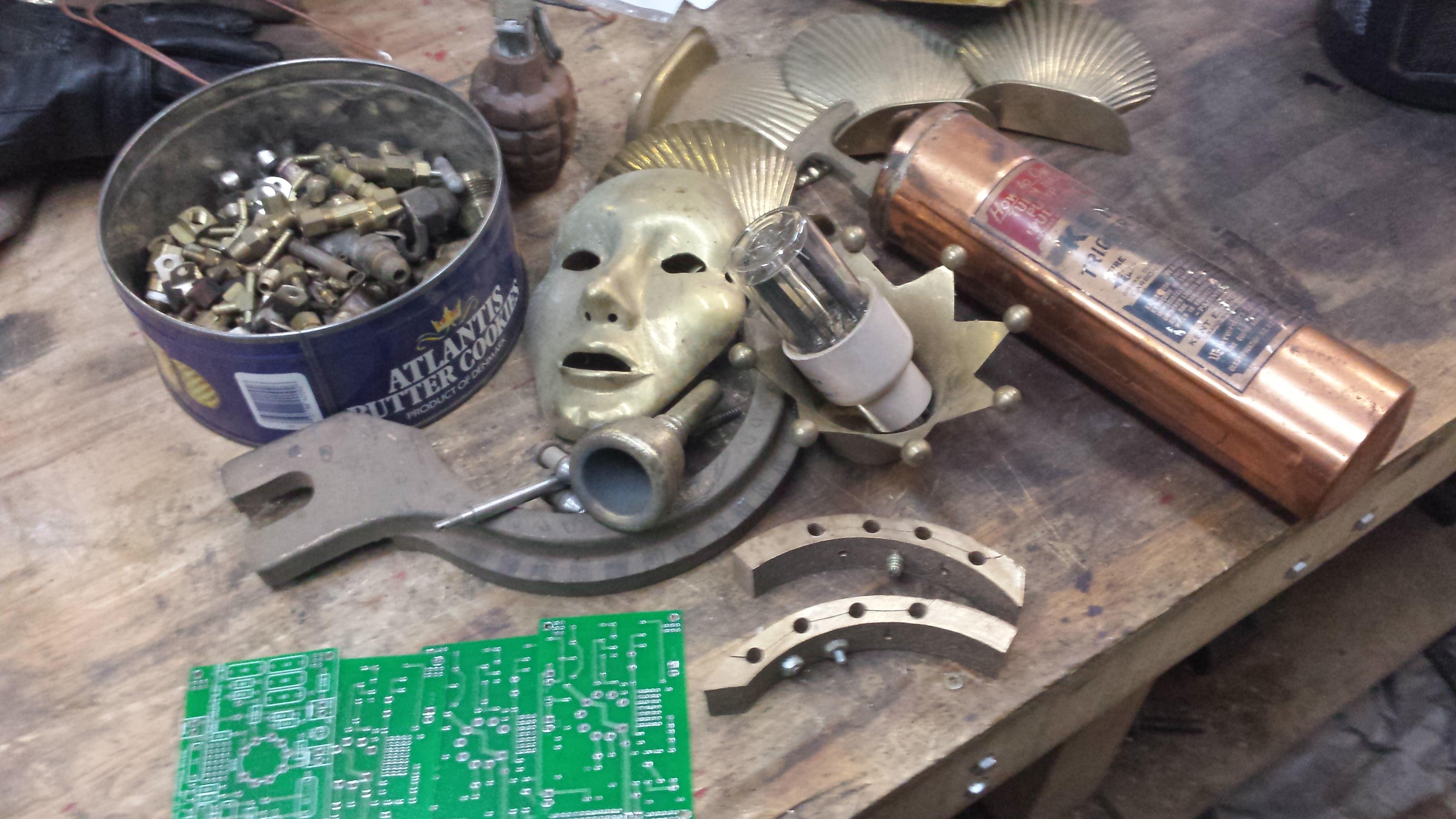

Be sure to add a trough on the right edge to catch the stray electrons.
That's what the crown is for😀
