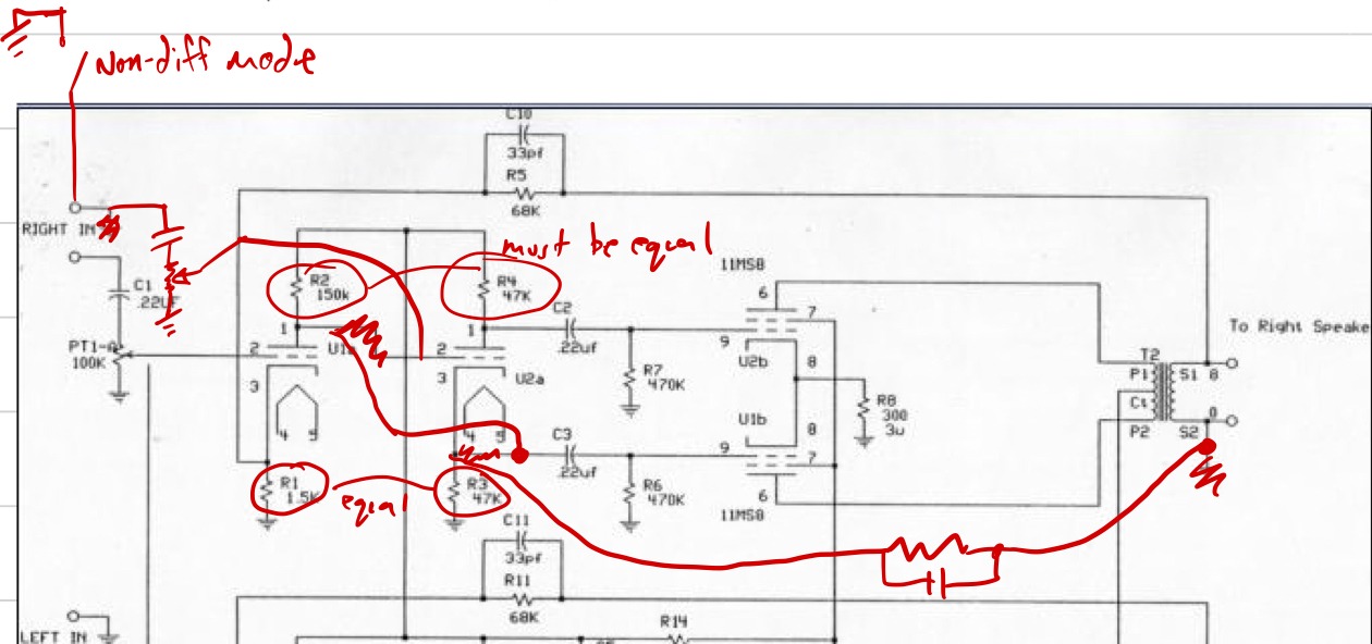

I have an old (and much beloved) K-12M tube amplifier - significantly upgraded from the original kit. I'm looking at my next set of modifications (adding a CCS to the cathode and an IR remote control) and was wondering if I could convert it to a balanced amplifier by changing the pre-amp wiring slightly. Here's my quick sketch on one channel - I'm picturing the + & - of the balanced line to be connected to the two points at "RIGHT IN".
(Pre-warning that I'm an electrical engineer who was schooled well after the days of tubes so I'm mashing some of my op-amp knowledge in here... likely poorly.) Wondering if someone could sanity check this for me - is this do-able and are my mad scribbles the way to do it? Would my pre-amplification losses, going from a 2-stage amp to a single differential stage, be worth the change or would it sacrifice too much? What would my R1/R3, and R2/R4 values be to set the gain as best as possible?

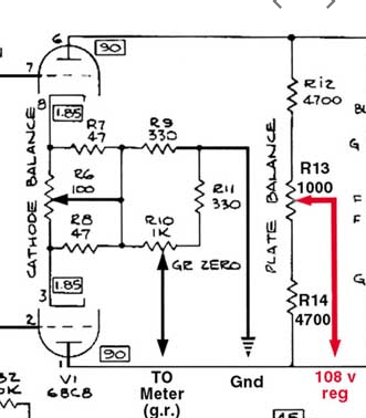

I don't know if a ccs will auto trim bias.
Because you have to set up trimming the bias on at least one tube so you can match another.
Was this built point to point or do you have to modify a PC board?
This is a sample of a triode stage that has manual balance. I don't know if you can get a ccs to work that way:
Yeah, except that's not what he's asking about. Anybody can add a balanced input interface via a transformer. 🙂
He's asking about converting his existing amplifier to a balanced topology. As shown, (with the red lining) the phase-splitter is re-purposed into another input tube.
I don't see any problem with this. It should work.

Would it work? Yes, I think so. The question is, and has already been posed by OP is will there be enough gain to make it all work.
The K-12M is about as perfect a testbed for this as you could ask for. It's worth trying. (Though I'd still just use a transformer, but probably because I've got some laying around...) :rofl:

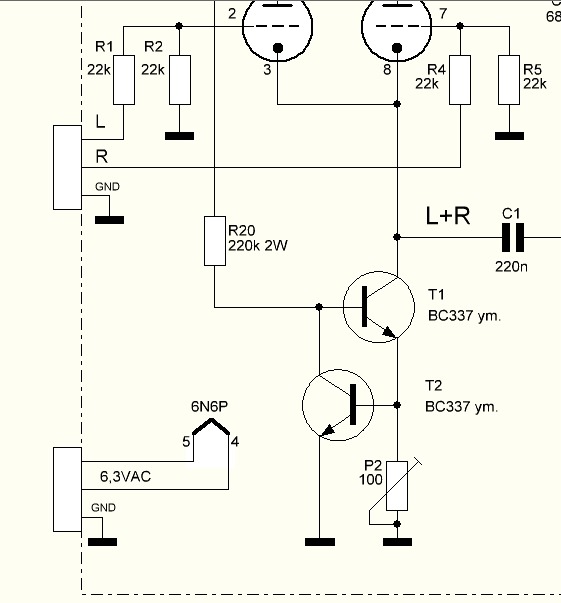

Based on the tests of 6N6P differential stage with LM317 ccs, I suggest to avoid that components. It is (audibly) noisy if operated at line level signals.
A simple NPN_NPN ccs has at least 6 dB lower noise level.

Seems like the OP is asking for a way to do balanced feedback in a power amp with single ended input. The split-load/cathodyne/concertina circuit makes it awkward because you have a 3 stage amp now without balanced paths. Without an input transformer to split the phase first it will be tricky. Assuming you don't want to use input transformer, you still need a phase splitter upfront. John Broskie suggested a balanced version of a Dynaco circuit without center tap on the OPT secondary, see picture below, which is routing the balanced feedback to the two cathodes and the two cathode resistors form a virtual center tap. It is still asking for phase splitter, though, like an input transformer or a split-load/cathodyne/concertina circuit upfront. But if you don't want to add input transformer nor extra tube, one way I can think of is to use a paraphase circuit like the Western Electric 124 but that can be a rather awkward circuit. There might be a circuit out there. It's a brain tease!
