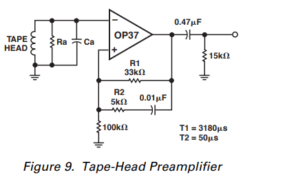

TI Spec sheet shows a preamp WITHOUT a cap. SO, no turn on / turn off transients to worry about? OPA627?

Thanks guys - not worried about output thumps (covering that elsewhere) but possible magnetization of tape head.
Newvirus - where did you get Fig 9 from - looks wrong - inputs backwards and no gain - 100Kohm to ground maybe should be 100ohms?
OP37 datasheet, Figs. 8, 9.where did you get Fig 9 from - looks wrong - inputs backwards and no gain
Yes, 100 ohms not 100k. Looks like ADI was in a hurry.

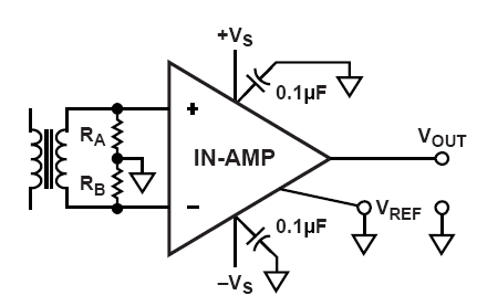

However, I recommend the instrumentation amplifier topology in which the bias current flows through the resistors, as the coil goes between the inputs (as opposed to input & ground).
