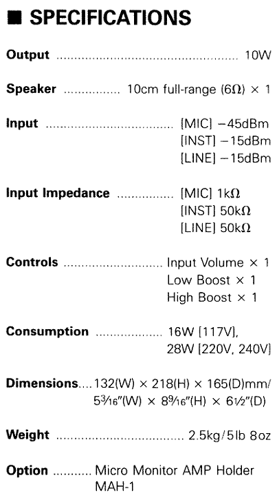

Just wondering if anyone can help. I have a pair of Roland MA12C monitors that have 3 inputs on the back. 2 are at line level and one is at mic level. Specs below.
Line input -15dBm at 50kohms
Mic input -45dBm at 1kohms
Is there anything I could run inline to feed a line level into that mic input? Or do you think it might be possible to mod the input itself to bring it to line level specs?

I have the impression that those numbers are sensitivity specs, indicating the minimum level to fully drive the loudspeakers. Are there also signal handling specifications, showing how much signal the microphone input can handle without clipping? Does the microphone input have a phantom supply and if so, is it easy to turn it on by mistake?
Nope. This is all you get.

As basic and old as this thing is, I wouldn't be surprised if it didn't even have electret bias and the (unbalanced) mic input were intended solely for karaoke type applications with a dynamic mic. Mic amplifier might be just an inverting opamp stage with a cheap and cheerful audio opamp, either 4558 class or TL07x. I think you can do the entire preamp section on one quad OP.
