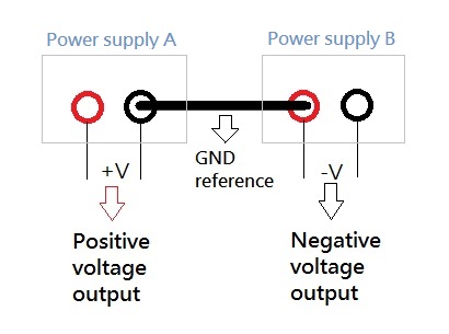

I found a picture that illustrates what I am trying to do from http://kb.bkprecision.com/questions.php?questionid=224. Any ideas?
Mmm. I understand what you're trying to do, and with something like a lab / bench PSU as shown above you can do this, as the grounds of the individual power supplies aren't linked - they're "floating".
However, because you're using a boost converter, unfortunately, you won't be able to link the positive of one to the negative of a second, to create a split rail supply. Effectively, you'll be shorting out the "negative" supply, when you try and connect it's positive to the ground rail.

Thanks. One last question before I drop this idea - if I use 2 separate switching supplies (like in they are connected to 2 separate wall sockets) which are then connected to 2 separate dc-dc converter can I do what is shown in the above figure? I am trying to use this exercise to understand the concept of -ve potential.
Thanks again for taking time to explain.
I just checked earthing and ground connections on an ATX PSU I have in bits here.
Unfortunately, the answer is still no. Negative on the ATX PSU is connected to the metal case, and to earth. This means the negative on each booster PSU is at the same potential, linked at the socket outlet earth, which then obviously means you'd short out the negative rail.

I have my LM3886s running from 2 AC adapters (wall warts) supply 12V (5A). As TheGabbleDuck pointed I could not use my computer PSU but 2 independent AC adapters did the trick. I boosted 12V using DC boost converter to +35V and -35V to power the LM3886s. The 2 ac adapters have no 3rd earth pin (only 2 pins). By connecting the +ve of one dc boost to -ve of another and using this point as my ground for my amp I was able to run the LM3886s just like the image in my earlier post.
