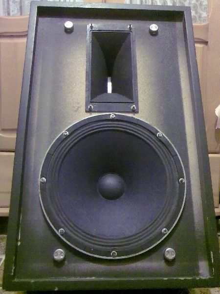

Hello again. Perhaps i didnt make myself completely clear for which i am sorry, English is not my native language. The speakers in question are the Gamma LA1231. An old model with an alluminum chasis, alnico magnet, light paper cone and accordian cloth surround. It is what we call a guitar bass speaker around were i live. It is by no means a subwoofer. The speaker's frequency response is 25-6000 hz. There is a plate on the back of the magnet stating it. But perhaps though it was because of the room gain that they managed to play so low in the sealed boxes, as the room was no more than 20 square meters. It has been years since they played in that configuration and i admit that the 25hz statement may have been exaggerated. Still though in their current boxes they cant reach the low frequencies they used to and by alot. The new ones definately wont go lower than 50 and the guy who designed the boxes told me so. The previous sealed ones are what the manufacturer offered the speakers with - a 2 way way system with an crossover frequency of 2500 hz, 2nd order for the bass, 4rth for the horn tweeter. Eventhough it doesnt look like the best setup, in reality the system played really nice. Here is a picture from the internet. The horn has those replacable alluminum type foils.
The new system is a 3 way with a crossover frequency of 800 hz for the bass speaker. I dont see why it would be a typo. I am currently out of town and i cant post a picture of the actual drivers i have but i can tell you that:
1. voice coils are changed
2. surround is changed to a hard, crude one with definate resonating capabilities and it has been impregnated
3. the cone hasnt been changed but the dust cap and the base of the cone (radius of 2-3 centimeters) have been impregnated as well

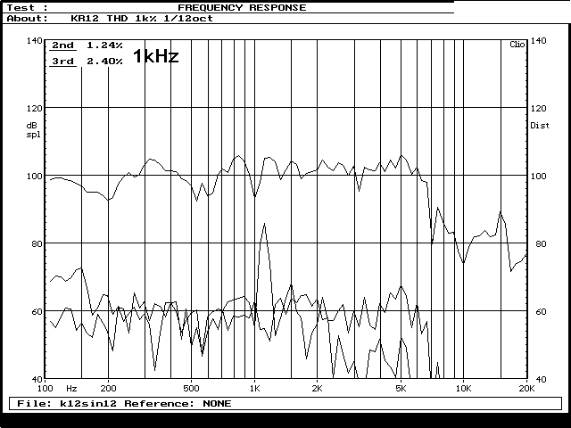

4. im posting the frequency responce of the new driver regarding the concerns about the port dimensions and crossover frequency. I have other measurements called MLS analysis and cumulative spectral decay. If needed, i can post them.
As for the choice of surround, i havent given it a thought yet as i first wanted to make sure that it's a worthwhile project to begin with. If anything, id like to reduce the vocal spectrum by 2ish decibels as my midrange drivers seem to be quite "tallented" at it by themselves. Again, im sorry if i've confused anyone. I dont really know much about audio and thought i'd ask the guys that do if anything could be done with these speakers.

your tube ratio is very different from what Small recommends which is roughly a ratio of 3:1 length to diameter. With your port large area mid range noise, (rear cone energy), coming out of the port will be much higher.
Do you think it is why my mids have a peak at the "A letter" of the vocal spectrum? I believe that's around 1k hz? Maybe there was a reason the port was designed the way it is?
