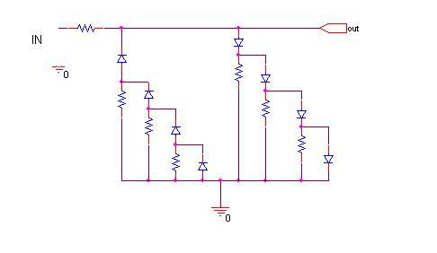

Hi
LED with GE in series will have GE-like soft turn-on. When they both clip their on-resistances add on. LED's on resistance is low, GE on-resistance dominates.
I like the compression and soft "turn on" characteristics of GE when gain is low, but I want to then have the crunch of LED's when the gain is raised up past just a subtle breakup point.
Everything depends on the circuit you use them in. Is it simple resistor-diode voltage divider?
If so, you could give four or five GE diodes (1n34?) in series to have soft cliping at 1.2-1.7V and this chain parallel with one LED (1.8-2.2V hard clipping).
Anyway this can be lots of experiment and fun.
Resistor-diode ladders may also play nice. This way you could tailor virtually any usable distortion curve, symetric or asymetric by changing values of resistors.
Wow! Thank you for your response. That is a real eye opener. The soldering iron is going to be busy this weekend!
Just a query though, I thought that when you parallel diodes the one with the lower threshold is the only one that will turn on. Therefore if I parallel a LED with a chain of GE's, if the GE's have lower clip voltage then the LED, the LED will never turn on anyway?
Best regards,
GrantsV
Hi
Basically you are right, but I think GE's have high enough on-resistance (soft clip) to raise voltage drop on them (english??) so that a LED can turn on.
