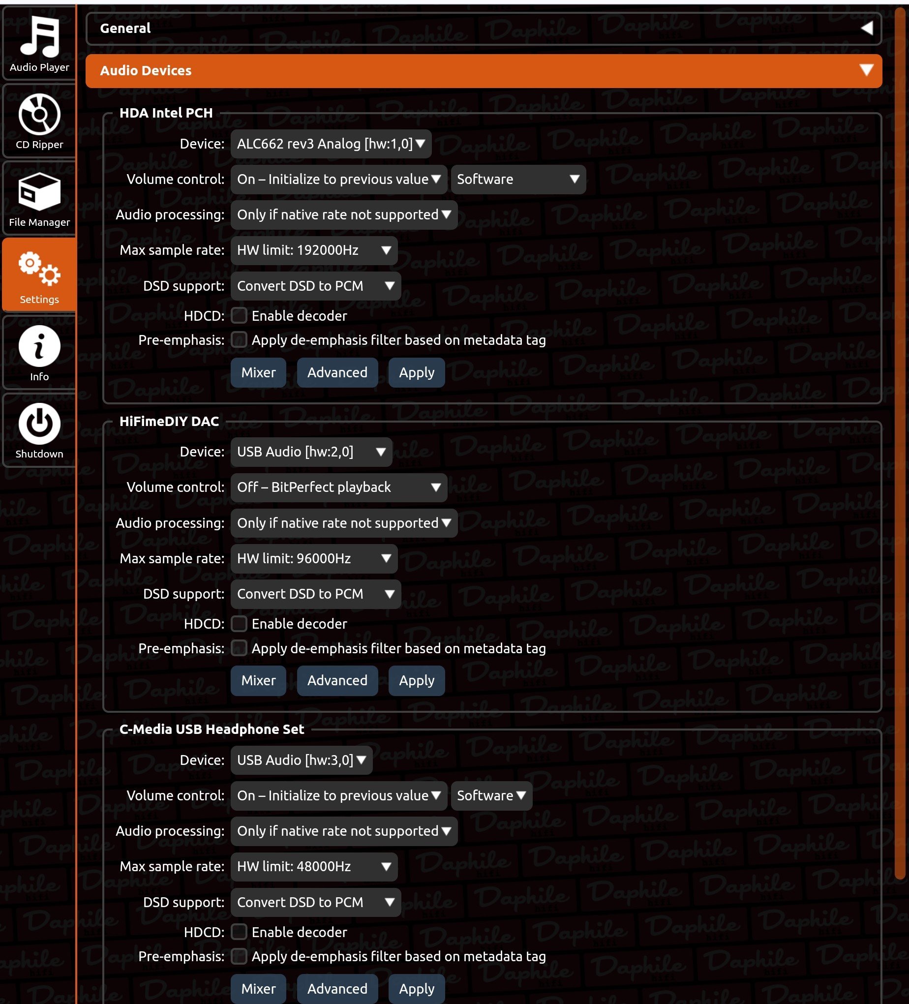

I tried an experiment, and not only can it output simultaneously via 2 USB ports. It can output 2 DIFFERENT songs!
I put song in the Playlist and play. Music comes out of headphones #1. Then remove song from the Playlist, add another song, and play. The new song comes out of headphones #2. Headphones #1 still play the other song.
Very odd.
On the screenshot, I'm using the HiFimeDIY DAC and C-Media headphone
Very odd.
That's technically easy - two players playing each to its audio device, each clocked by its respective audio device. But IIUC what you want is one player playing a single stream to two independently-clocked devices.not only can it output simultaneously via 2 USB ports. It can output 2 DIFFERENT songs
Well, then it looks like that's the way the Daphile player is programmed. Maybe it can be reconfigured, I do not know as I do not use Daphile.The new song comes out of headphones #2. Headphones #1 still play the other song.
