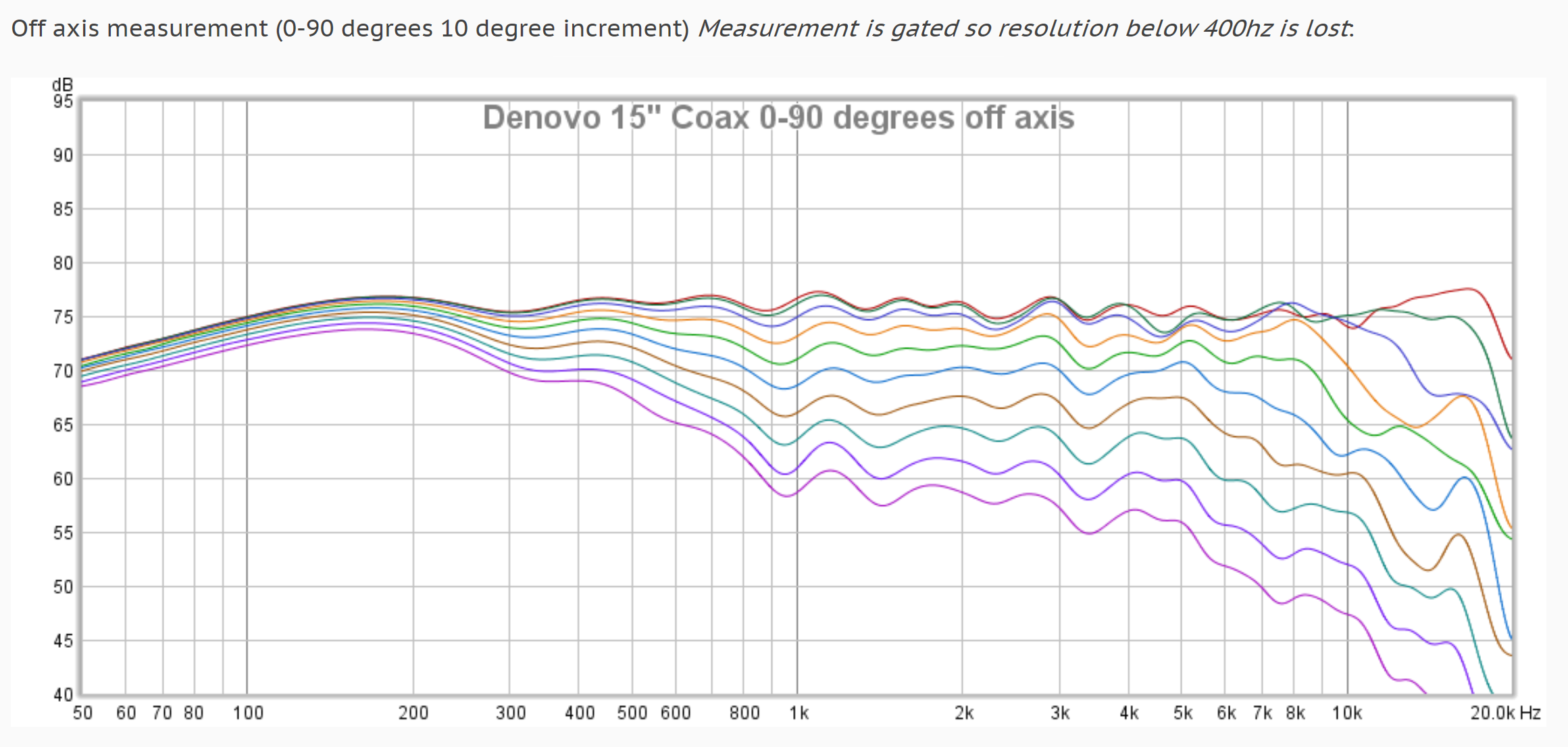

Am I correct that it could be EQ'd flat to 500 hz at 100db sensitivity in a home usage environment, based on the measurement graph? Glenn.

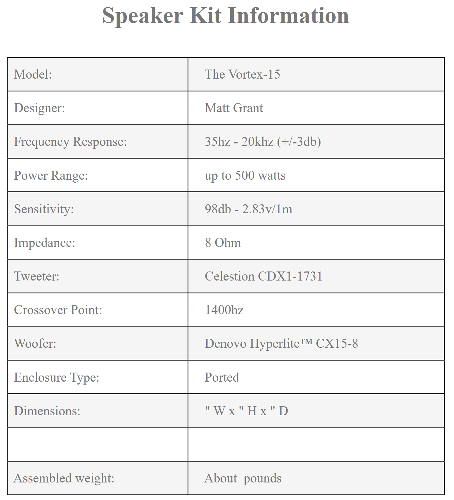

I've finally decided to move ahead with building a pair of these and ultimately couldn't resist going with the Vortex-15 instead of the 12. They will be a tight fit in my current space, but I figure these are drivers I'm going to want for the long haul so why compromise. For now they're going to be simple Duratexed MDF ~2.5cuft cabinets for use with my existing subwoofer array.
How do they get this kind of constant directivity below the crossover of 1400hz? Isn't that 15" starting to beam around 900hz?
Yes, and the beaming is designed to match the CD's directivity with the crossover 😉

I've mostly finished my Vortex-15 build. They are awesome speakers, although to anyone considering them I would probably recommend going with the spec 4cuft cabinets since the smaller ones I built result in a pretty sizable hump in the upper bass that makes them sound muddy. Not a big problem for me since I have a DSP in my signal chain for the sub crossover that can easily EQ it out. But it does somewhat limit their flexibility - I don't feel as though I have the option to use them with my AVR and its crude EQ, for example.
Did you go sealed or ported? I thought spec for sealed was 5ft^3 for flat response? Been having trouble finding a clear answer on that.
