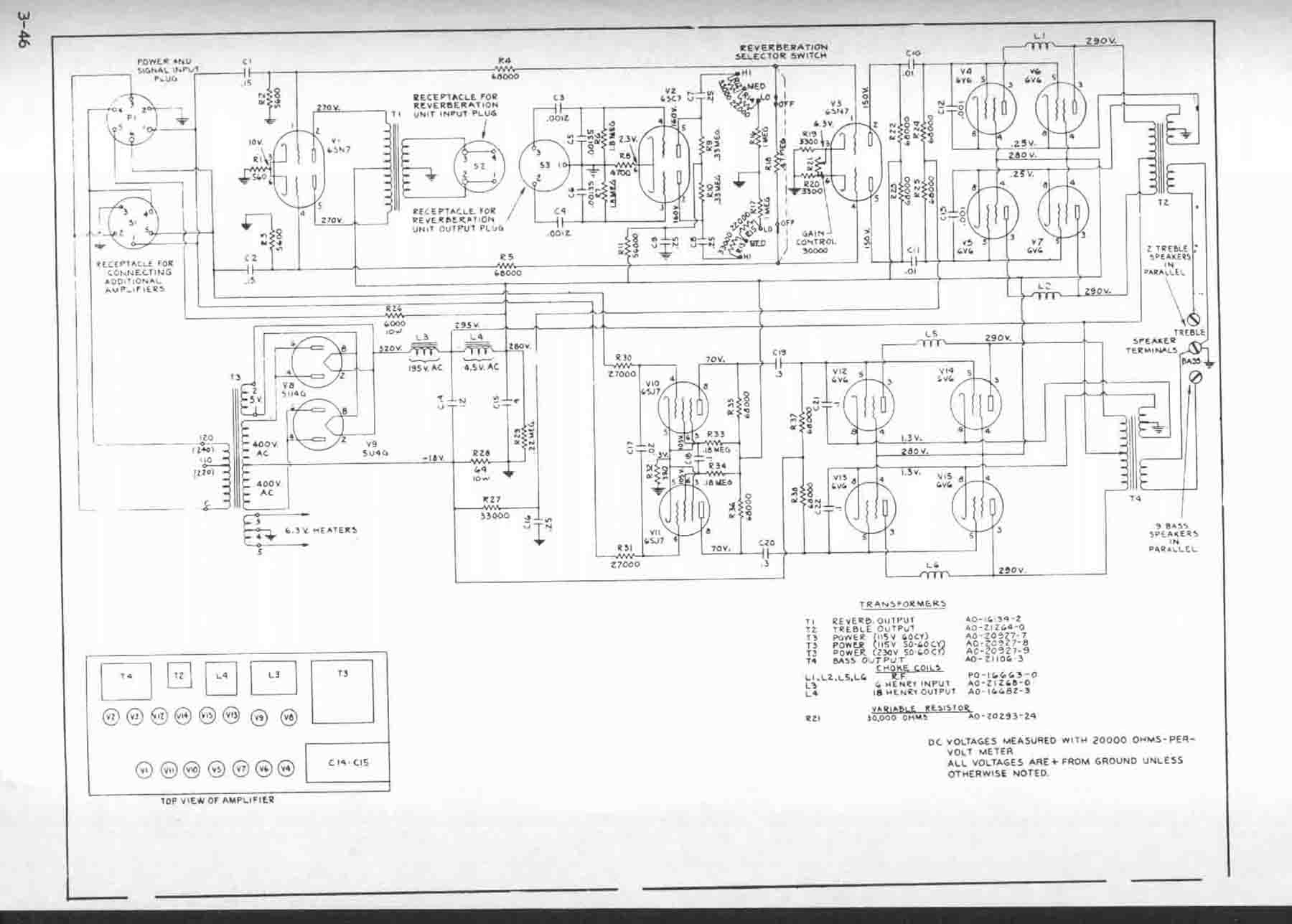

Among any other difficulties, it appears, at first, that the two Output Transfos are really differents.
You should plan to obtain two similar units.

Are you saying that this whould not make a good amp? What would I have to do or what modificationss should be done to make it worth while

Yeah, buy new OPTs. I'd rework the circuit to remove the reverb and extra amplification that goes with it. Otherwise, if it's got all the tubes and power supply there...

I guess this is nothing special to work with so I'll keep looking till I find something. I am just a beginner and was looking to learn as I go. I was hoping this was a good one to work with.
BTW can anybody guess where this amp came from?
sweet said:BTW can anybody guess where this amp came from?
I's guess that it came out of an organ. Mono but with a 12 or 15" Bass driver & a smaller mid/tweeter.

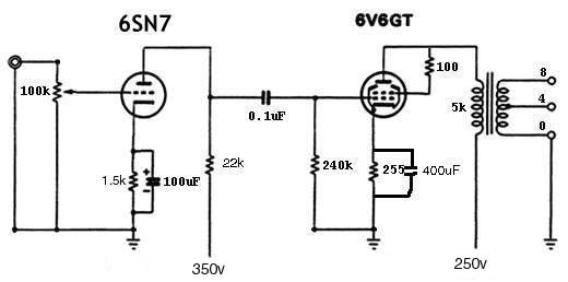

It looks to have a very decent choke input power supply (all those chokes make it a very special Frugal-phile(tm) amp, nost of the stuff i see doesn't even know what a choke is, and you've got 2!!) -- you might have to change some caps. From there the voltage is just right for a single-ended or push-pull 6V6, EL84 or 6AQ5 amp. Since the 6V6s are there already....
But, as mentioned you'd need a matching pair of OPTs to make a stereo amp. Single-ended would be easier as a starter project, you certainly wouldn't have a shortage of power supply.
The simpliest amp would use a pair of the 6V6 and 2 halves of the 6SN7s (either 1 tube or half each of 2 tubes -- the last also leaving you the versatility of playing with parallel, SRPP or Mu drivers). You could extend that into a parallel SE amp with 2 6V6 per side.
The Hammand 125ESE is a decent budget OPT, that being multi-tapped would give you the ability to play with things like that.
Something like the attached....

You are right it came from an organ...it came from a hammond HR 40 tone cabinet that had 9-8" speakers and 2-12" speakers.
Do you think I should just scavange parts and start from scratch.
if this is what I should do what would be the best I could build with this...along with 2 OPT's I would not scrimp on them so give me suggestions.
