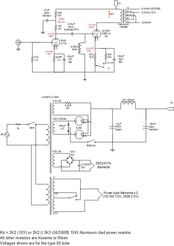

Ok, here is a simple amp ;)
This is my 10Y/50/300B amplifier using 5842/417A driver. It is *definitely not the best* and has much room for improvement. But this is a good start. I like this better than the Walton (but you can also see my JE Labs 300B on his site) and the Audio Note.
You have to take what I said with a drum of salt :D
The voltages shown is for the 5U4-G, but the B+ will be bumped up to 420V if you change the rectifier to 5AR4. You don't need to use the Lundahl, the are cheaper alternatives out there.
If at a later time you wanted to change the driver, then you already have a foundation for building block as mentioned above.
Your call...

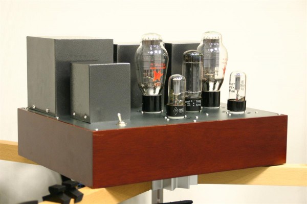

hi,
I suggest use single triode push 30B SE with most better, although the dynamic less than pentode or SRPP, But more detail & colourful but crystal sound.
I choose EC52 caps couple to 300B.
If IT wil choose E180CC IT( 15~20K:15~20K 1:1 IT) to 30b SE.
for reference.
this website in hong kong had 300B course & use my products.
newbie like more different brand tubes to exchange.
so I choose back to 6sn7. but my kit still use EC52-300B.
http://www.hififever.com/forum/viewtopic.php?t=802
this is a chinese website, pls see the link that many student use my kits.
kits was fully use potted trans , ebony chassis & double c-core OPT.
http://www.hififever.com/forum/viewtopic.php?t=783
pls see the output, 19H & 102ohm only.
thx
thomas
