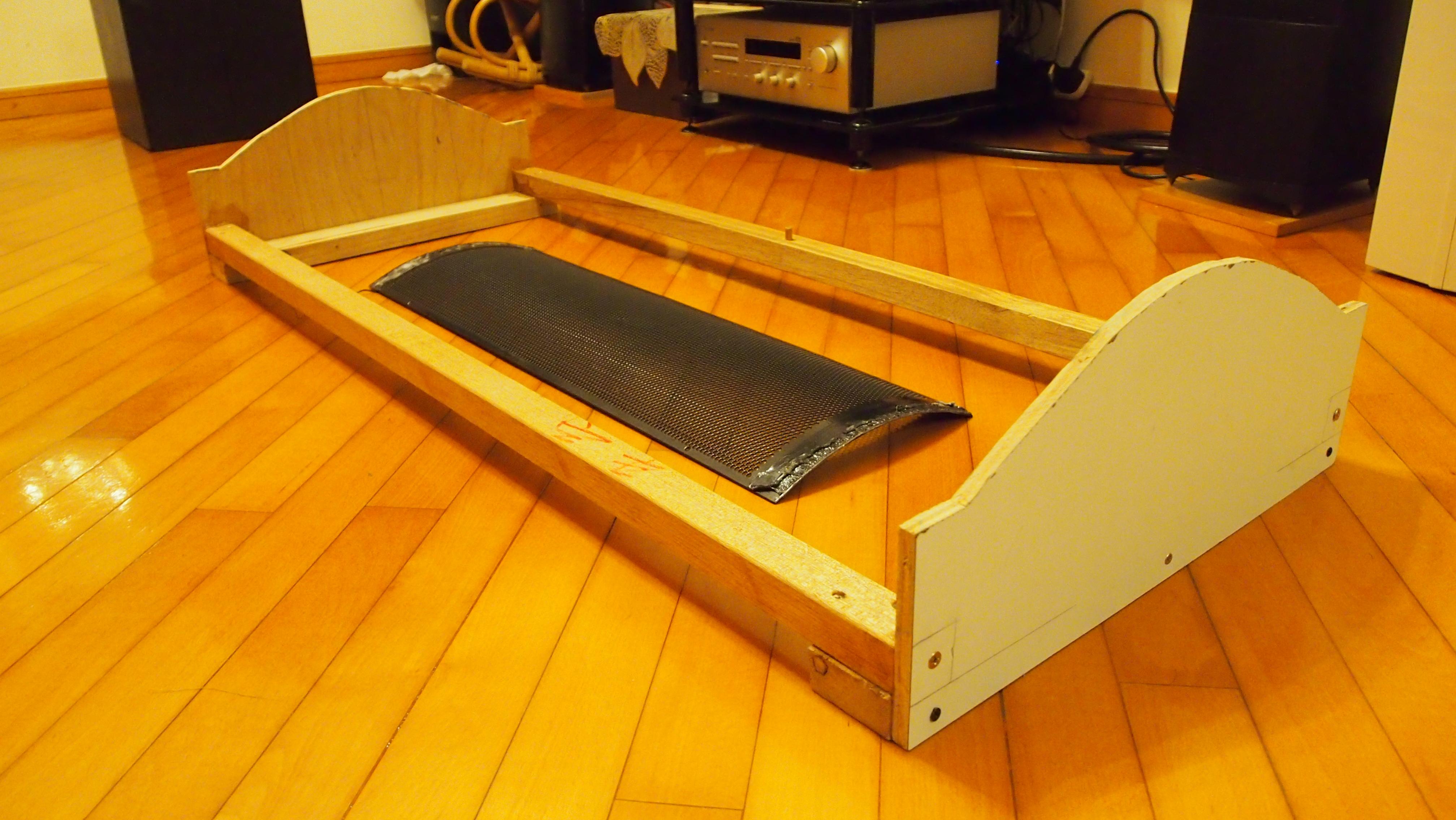

JIG

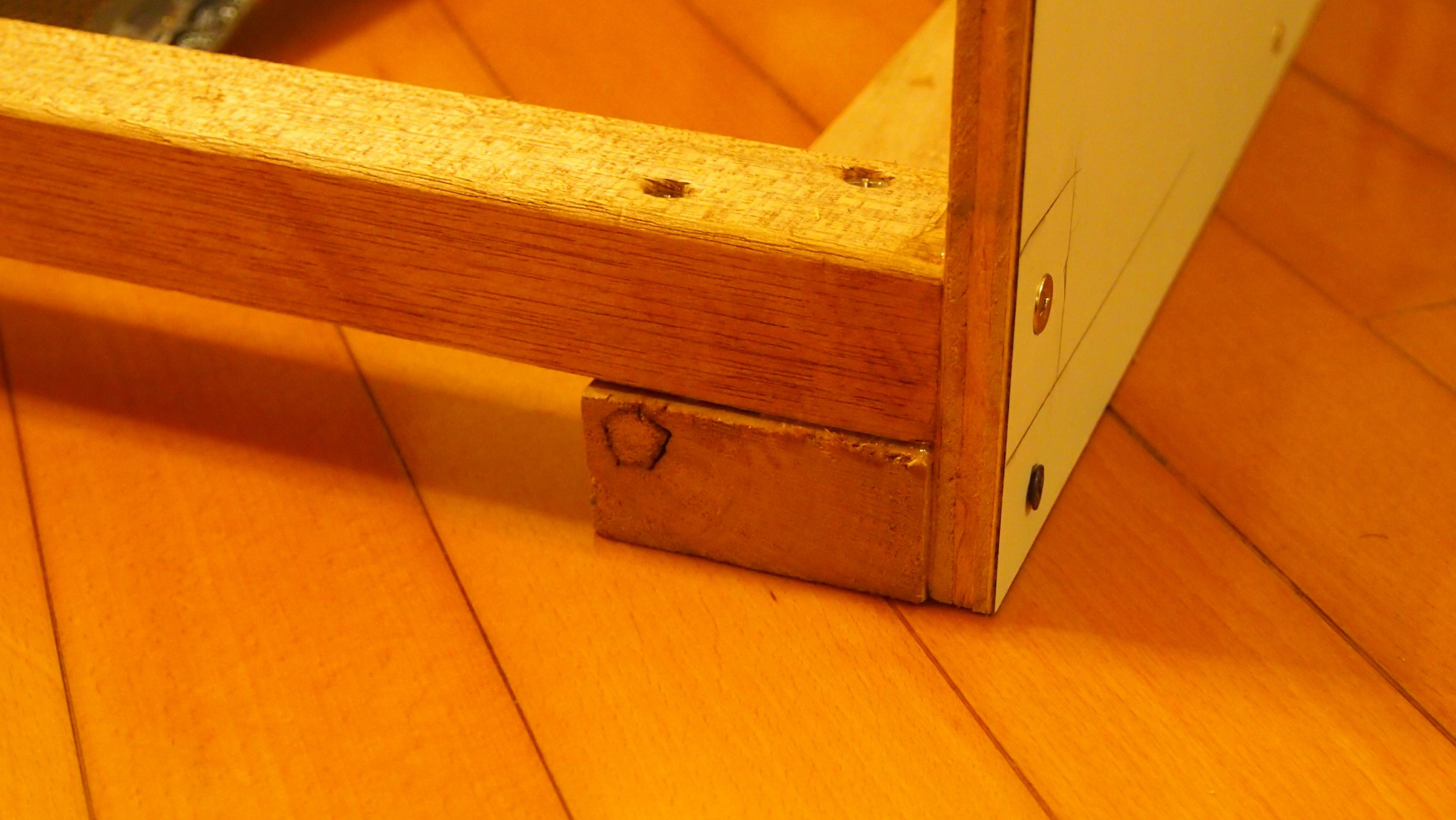

The head and footboards took time (didn' have a jigsaw so I cut it using a normal wood saw). The rest was a simple "glue and screw"! it seems stable with the extra screws. I put a single sided foam tape on the curved edges to protect the Mylar while stretching. I also put wood triangles to prevent the jig from flexing sideways (will put up the pics tomorrow)

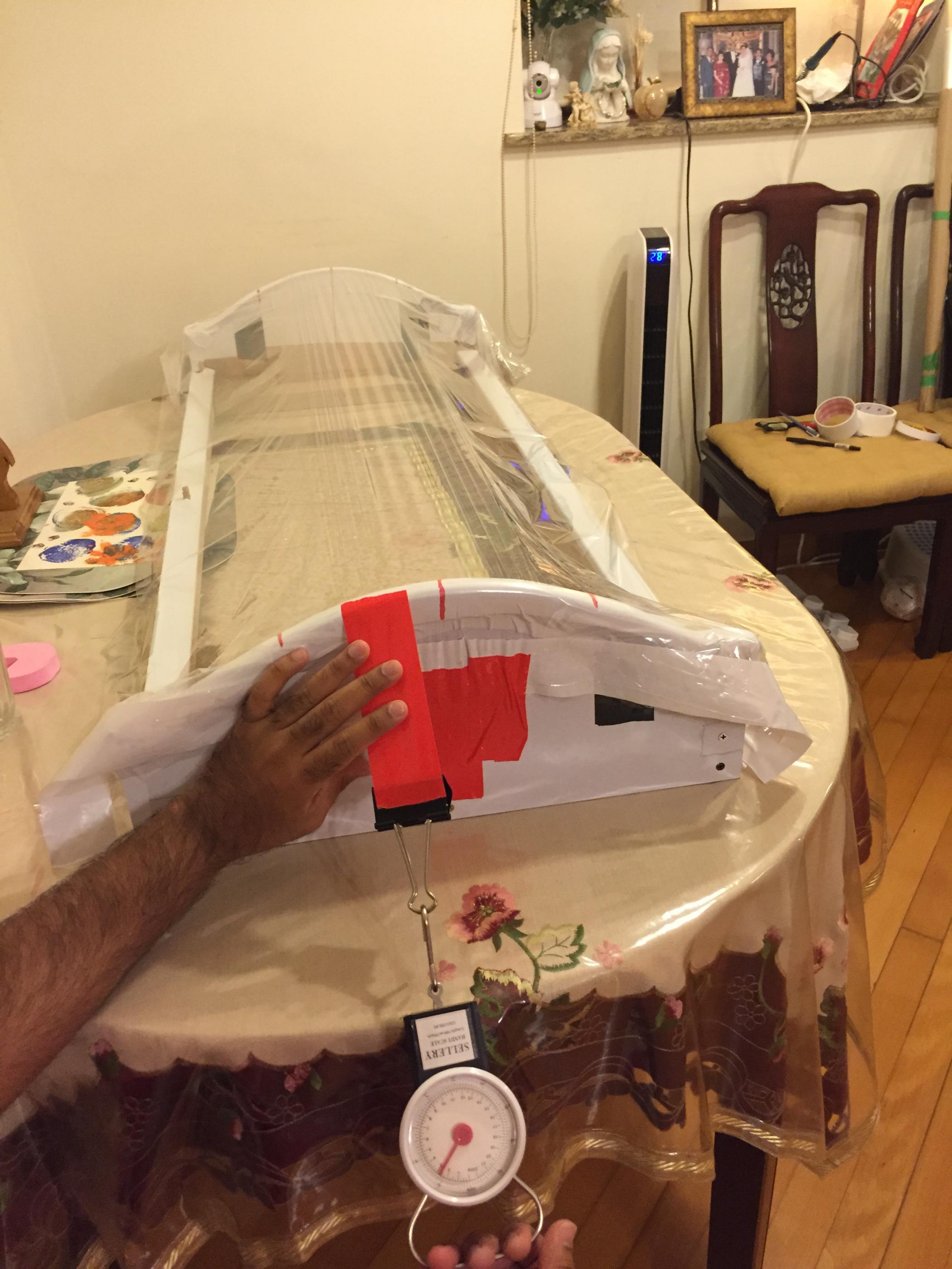

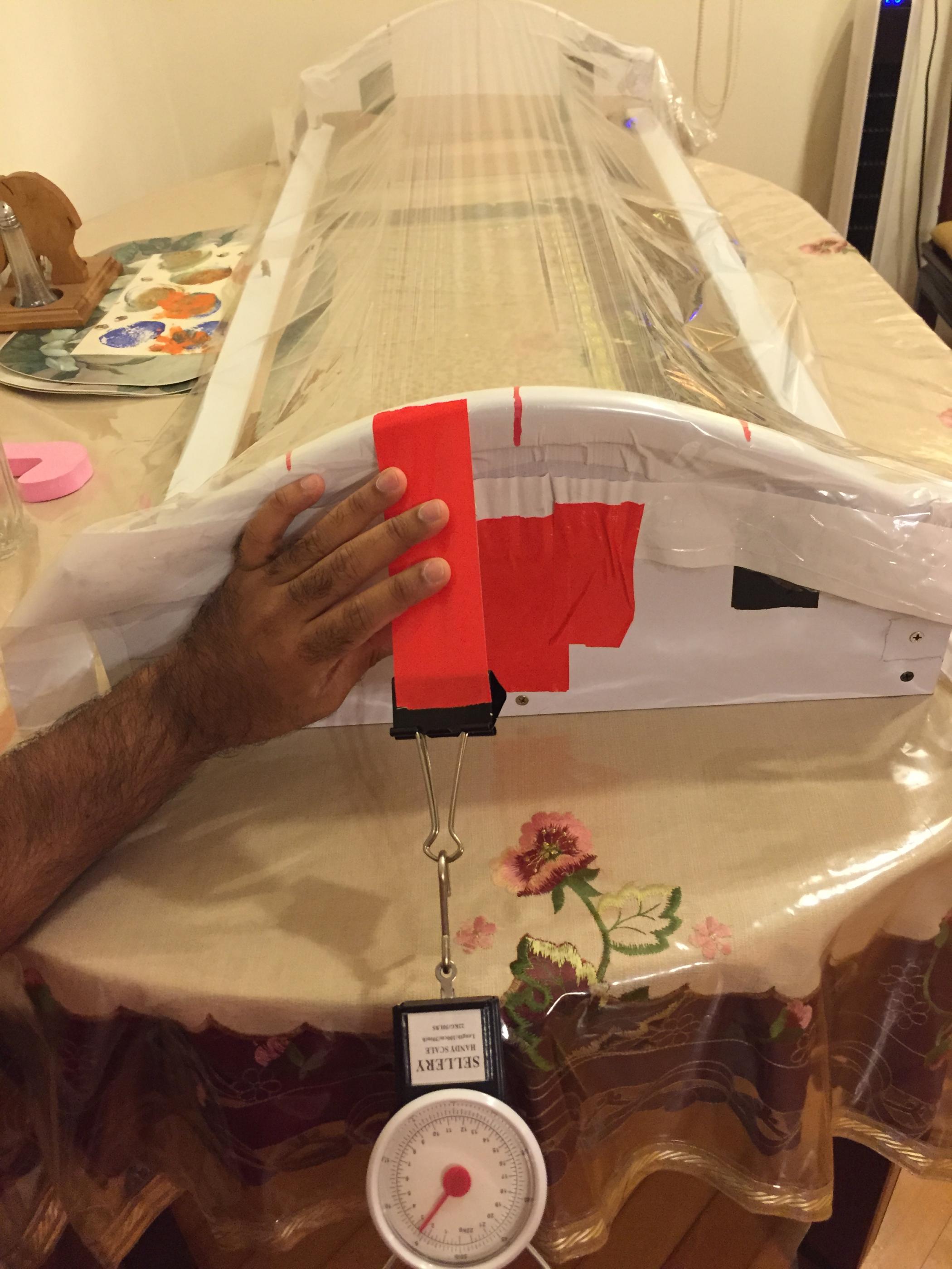

I used 3M duct tape. Widely available and can be torn easily by hand. I put some foam tape on the edge of the jig to prevent the film from snagging and tearing. I used a mechanical weighing scale rather than a digital one. Dont' use a digital one as you can't hold the tension without the digits going crazy!
Procedure:
1) Tape the breadth of the edges of the film to be tensioned before cutting it from the roll. Cut along the tape line as this will prevent the film from tearing and wastage. The film tears so easily!
2) First tape the middle of the film breadth to the middle of the jig and from the other end, do the same while applying tension of 2.5kgs.
NOTE: Don't tape the film to the foam on the edge of the curved portion of the jig, but rather on the flat surface below. In case there are any creases, you could always stretch the film breadth-ways along the foam edge before proceeding with the next tape tensioning.
3) Do the same starting to the right of that middle tape, then tension from the other side
4) Now do the same from the left of the middle tape and tension from the other side
5) Tension the film, taping in a hand-fan shape.
6) To fine tune the tensioned diaphragm, try and pull near the corners of the diaphragm with some tape and see if the small creases go away.
7) Finally tape the remaining loose film along the length of the jig to the jig itself. Do not pull hard as its the longitudinal tensioning that is important and not the breadth-ways tensioning.
