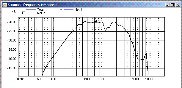

Ah I see. I would go with H. Just for you information I have made an open baffle actually with the W15CY001 used here that is just over 30cm wide. A sort of cross between C and E, measured result? an exact replica of what is written here.
I think I read and posted about dont mounting in the centre because I had looked here before and thought H would be best for my situation.
Here is my measurement of the W15 in a 30cm open baffle, with a 2nd order 300hz hp and 3rd order 3000hz lp.
