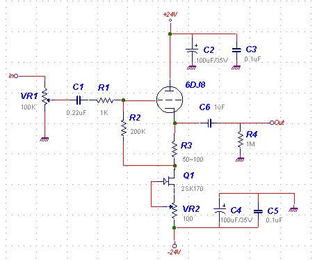

Can anyone recommend a good buffer circuit
For my first attempt at tube DIY I want to make a simple low voltage buffer for my cd Player. The DAC has a 2.4V p-p balanced output, although I can easily change this to a unbalanced o/p if required.
I want a good, simple, reliable circuit that will operate at no more than about +/-35V with a low input impendance and no output transformer.

Why not an SRPP with a 6GM8 / ECC86 ?
As per "Tube CAD", allows for about 10mA plate current, gain should be around 17 dB with no cathode bypass and output Z less than 2K.
Moreover, with symetrical supply, the output could easily be set at ground potential, eliminating the need for any output cap.
Yves.

If you're going to the bother of using tubes, go to the bother of using reasonable voltages for them. If you insist on limiting yourself to 30 volts, the tube choices are awfully slim- Nuvistors are logical, but darn hard to source, microphonic, and expensive.
A 100-200V supply isn't all that expensive or difficult.
buffer with ecc88 (6dj8)

I like tubes if I'm looking for voltage gain, especially for small input voltages, like phono preamps, or if the output needs large voltage swings at modest currents, like electrostatic headphone drivers.
If i'm looking for a buffer, with no voltage gain, some current gain, with line-level signal voltages and supply voltage less than 100V I find that transistors, especially jfet input and bipolar output, work well and have little sonic coloration if biased class A.
