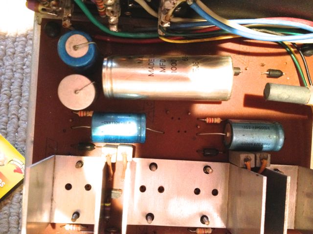

Used the old bulb tester and there is a short🙁 It is in the left channel, which is where the original problem was. The 2 left channel outputs were getting hot.
Could be one of the 3 transistors on that side which are just south of the outputs.
Not sure what to do now, since if it is one of those transistors I am not possessing the skills to identify it or find a suitable replacement. Assuming it is one of those transistors.

Have you turned the pot back the other way and tried again ? I'd be surprised if the transistors popped with a bulb tester in circuit. Its normal for the bulb to light as bias increases, it might just have saved you from really doing damage.

OK. I'd be surprised if they had failed. And if they are warm then they are not short circuit 🙂

Well I'm thinking that given the age of the amp, that its AC coupled to the speakers. So in that case a voltage measured on the end of an "open" large electrolytic would be normal and would be expected due to the high leakage of big caps. That's why I think you'll find the offset falls to zero when you connect a speaker.
For the bias you need to first of all see if there are any low value resistors either in the emitter of the output devices or maybe just a single one in the collector circuit... old amps... any configuration is likely to be seen. That resistor would allow you to monitor the current (by measuring voltage). If there is no resistor then you have to break the circuit somewhere to measure current directly.

What you are looking for (and it may not have it) is a resistor, probably 1 ohm or less, that is directly in the emitter or collector feeds of the outputs.

If there are any DC rail fuses then you could remove those and insert an ammeter and do it that way by turning the presets to increase the current a little (just say by 10ma per channel).

Look at it all closely. There has to be an easy point to measure this. I spotted some wire links I think ? See whether they feed the output transistors and whether they look like something that's meant to be opened and an ammeter inserted. The manufacturer won't mess around setting these up, there will be an easy way to get at it.
You are sure there are no really low value resistors around there ?

I can see 2 pairs of 100 ohm resistors just south of the heat-sinks as well as a pair of trim-pots. And between/close to (hint!) the heat-sinks there is a pair of 47 or 470 ohms.
It does appear that a few of these resistors are tied into the trims. I will have to check later.
