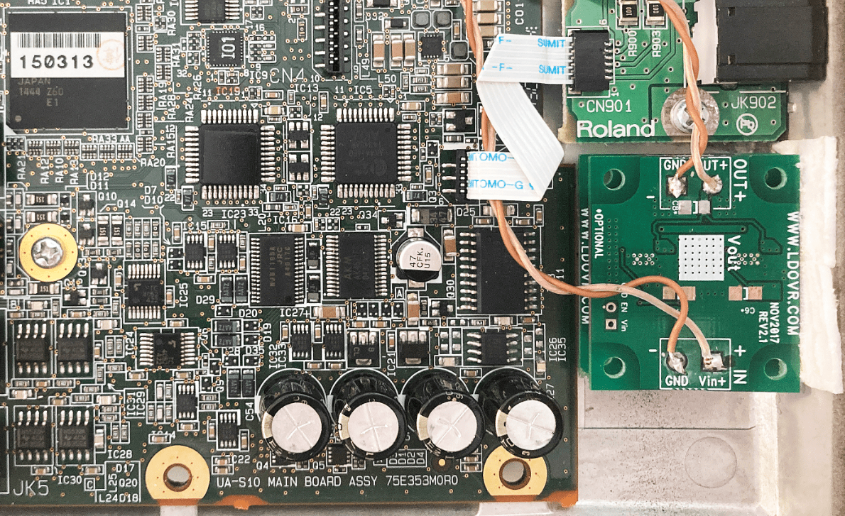

[Re: Dexa] Does anyone know what IC they're based on?
Check out the Vregs from LDOVR which are based on 2 different ICs:
https://www.ldovr.com/category-s/113.htm

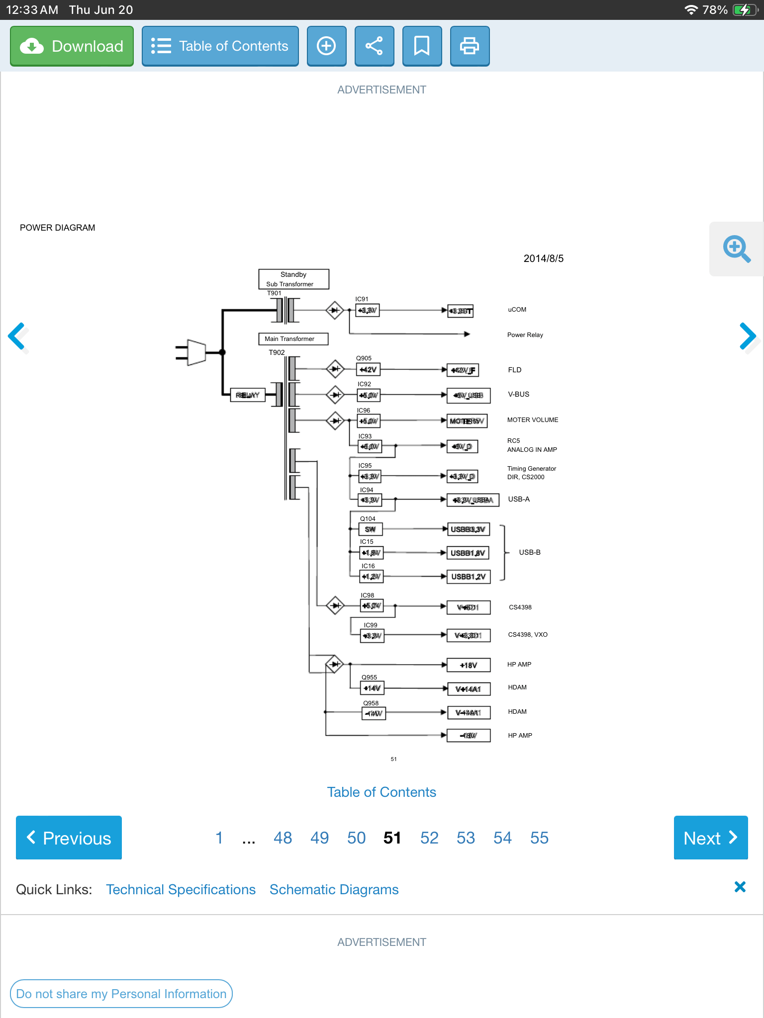

Can you see them in my screenshot in post #9?

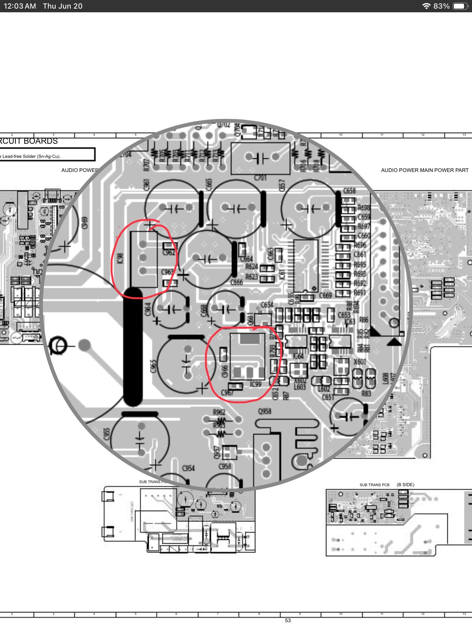

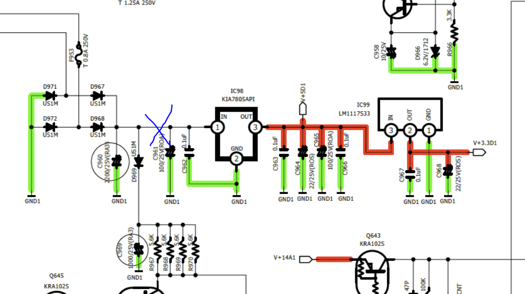

Here are the two voltage regulators mentioned , which I circled in red
IC99 and IC98
One is three pin and the other is 4 pin.
can I solder those low noise regulators onto the ones one the board circled so I don’t have to take them out?
IC99 and IC98
cheers
..... but you say I can connect more in parallel with the ones already on the board?
so I don’t have to unsolder the old ones?
NO, that's not what I said. I said you could use the two (new/additional/better spec-ed) voltage regs in parallel... in place of the typical TO220 voltage regs (or, you could add the additional very low-noise voltage regs where needed... )
Based on your responses, I strongly suggest that you get someone to do these mods for you.... exactly what you intended to do in the first place 🙂.
I thought I'd push you in the right direction... but maybe start with something easier... like one of the diyAudio Store FW clones.. or similar.

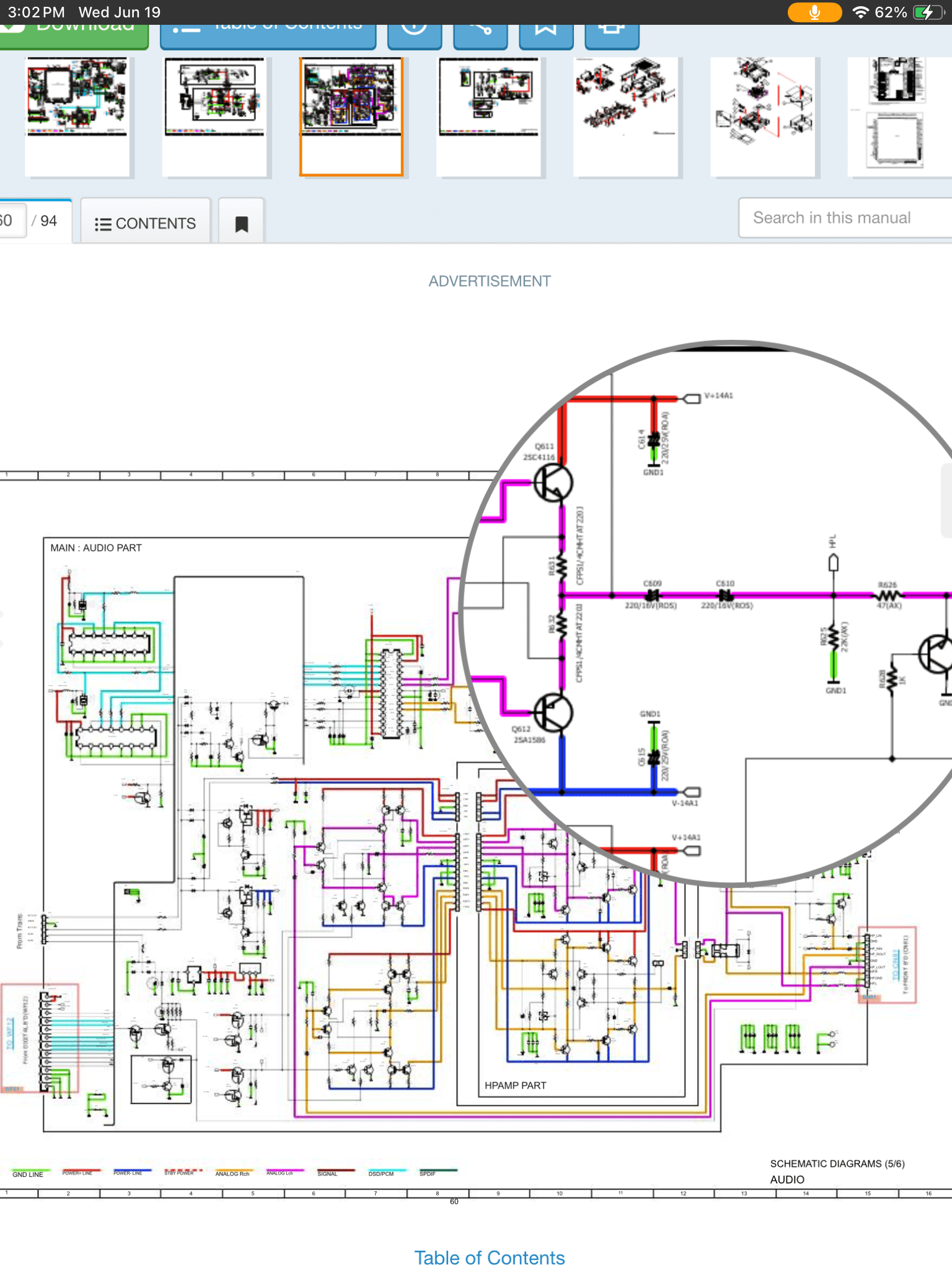

I don’t see any voltage regulators for the HP amp but two transistors.

They're there to block the DC offset at the output of the amp, which may be too high for headphones, so I wouldn't bypass them. As you can see they're two back-to-back elcos, which is fine when the DC they're blocking is very low (of the order of mV) or of unknown polarity, but it's a bit of a waste to put two caps in series (which halves the total capacitance) where a single bipolar cap would do. I'd replace them with a single Nichicon ES, which have been shown to have pretty much negligible distortion (here). I'd also go for a larger value, two 220u in series = 110u, which is fine for your high impedance headphones, but if you ever use it with low impedance ones, e.g. the typical 32ohm value, you'd get an F(-3dB) = 45Hz. I'd go with 470u or the highest value that fits in there.should I bypass the caps on the fixed outputs for both L and R channels?

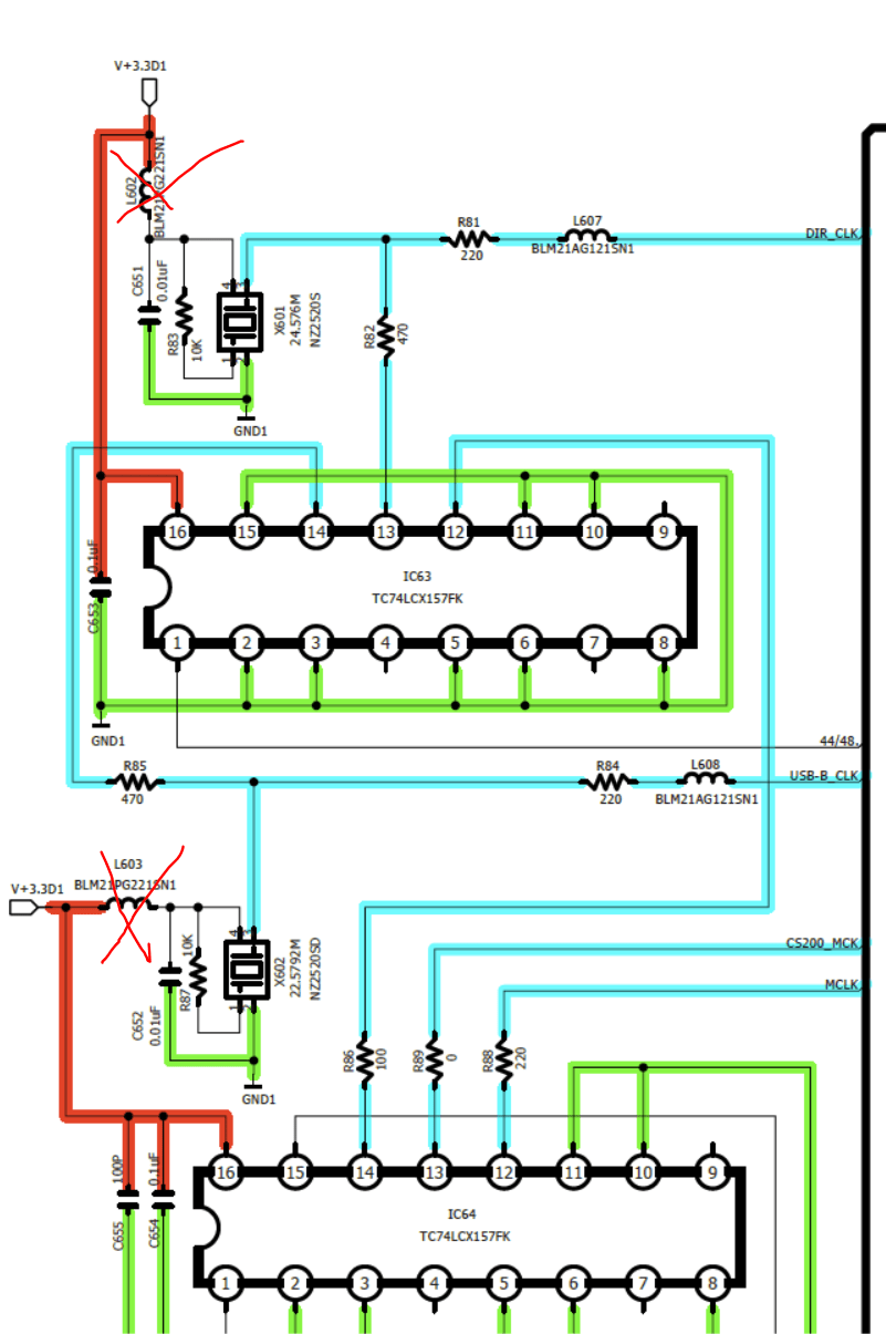

There are many places where you could install the low noise voltage regulators...
The two red crosses point to where the additional voltage regs (500mA will do plenty) should go... this will only cover the crystal oscillators' clock generation, and their clock signal distribution - a crucial element in any digital audio device.
The blue cross points to where the Vin (for the regulator PCBs) should be sourced from. The voltage drop across the regulators will be substantial, but the current draw is minimal, so all good... (plus, the high voltage drop will ensure a very low noise operation and excellent load regulation). These 2 voltage regs would completely isolate the most important digital section, from everything else that resides on that V+3.301 rail...
Then... that IC99 can also be replaced with a let's say... 2A LDOVR 3.3V LT3045 reg... just make sure that LDOVR voltage regs can work with only 1.7V drop across them...
Then, you can start looking at other voltage regs... those that supply the analog sections.... a sensible electronics engineer should be able to follow the above, I'd hope...
Good luck.

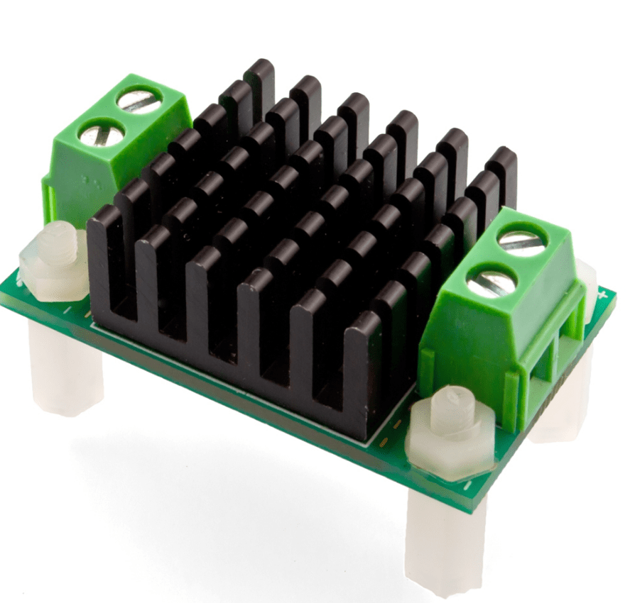

@Extreme_Boky
pardon. Should I get the voltage regs from here, like the ones in your initial pic?

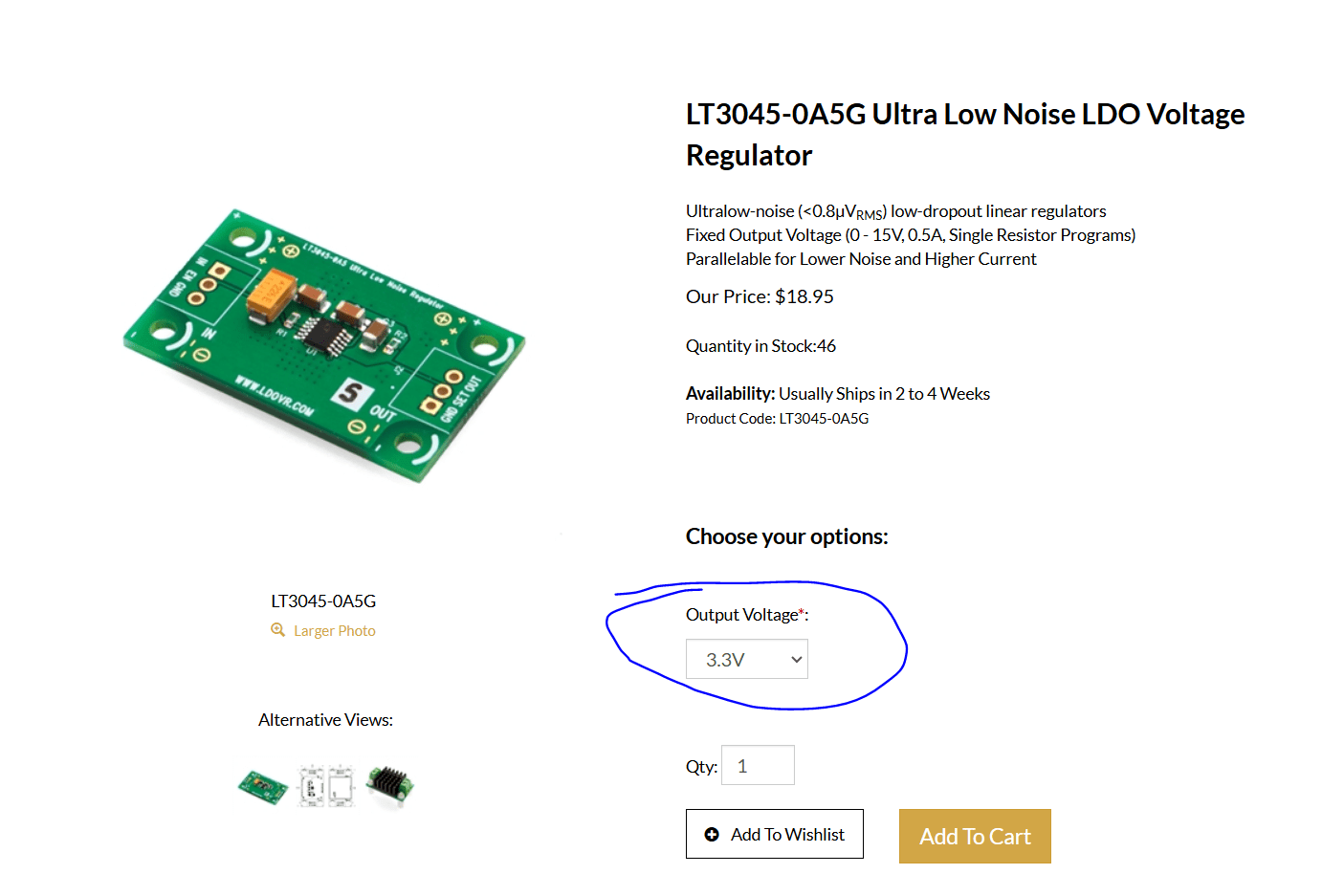

For the ones I suggested above in my previous reply (red crosses), get two of these; the voltage should be set by Ldovr to 3.3V (circled in blue below). I also checked the dropout voltage - it is less than 500mV (260mV only 🙂), so they'll do great.
https://www.ldovr.com/product-p/lt3045-0a5g.htm
NOTE: I strongly recommend that you leave this ordering with an engineer who's going to do the actual mods for you... He'll make sure that the voltage regulator PCBs will fit inside that smallish enclosure.
By the way, I obtained really good results when I was burning at least 6-7V across them. This can become a problem if you decide to run 300mA or more through them, but I just realised that Ldovr now provides the heatsinks for them - how cool is that..?
