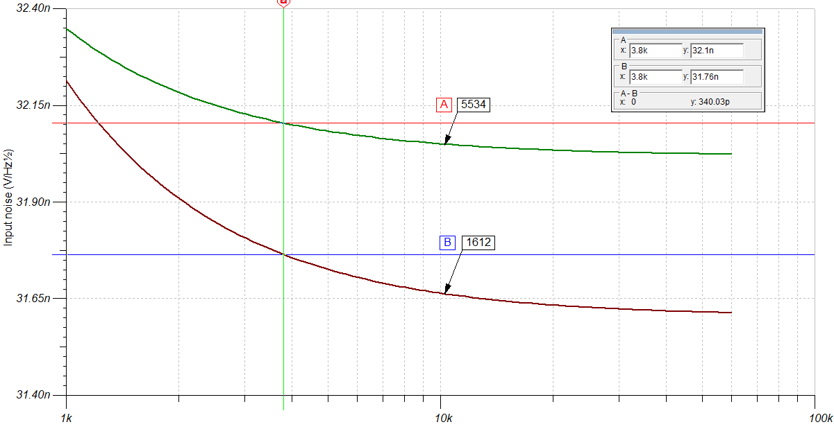

Yes I know, is interestingA simple rule of thumb is that if it is the total RIAA- and A-weighted noise you are interested in, you have to multiply the current noise by the cartridge impedance at 3852 Hz, about 12 kohm for a typical 500 mH MM cartridge, to compare it to the voltage noise. With 12 kohm:
NE5534A, 3.5 nV/√Hz and 4.8 nV/√Hz
OPA1612: 1.1 nV/√Hz and 20.4 nV/√Hz
Problem is TI wont work against itself so the data is correct.
Problem is this is ideal test conditions.
And rule of thumb equations are correct yes .
Problem is nobody bothers to measure it in real circuit conditions.
And compare same 2 op amps also in same conditions.
So to make yah feel better the expected input current noise of 20.4 nV expected from 1612 at 3852 Hz is actually more like 31.76nV
Unfortunately 5534 input current noise is not assumed 4.8 nV it is also 32.1nV
So 1612 actually a slightly better but basically the same. Guess when you scale the graphs 1612 could be expressed as way better.
Im not gonna debate the meaningless difference of 31.7 to 32.1
But overall noise from input to output, then distortion and numerous other factors. People just have a hard time
accepting modern engineering has surpassed old opamps.
So what exactly did you measure under what conditions and how? Source impedance, weighting?
By the way, my rule of thumb is based on the calculations in "Noise and moving-magnet cartridges", Electronics World October 2003, pages 38...43, https://worldradiohistory.com/UK/Wireless-World/00s/Electronics-World-2003-10-S-OCR.pdf Mind you, Electronics World drew one of the sections of the gain switch in the wrong state in figure 5 and I mixed up the terms spectral density and power spectral density.

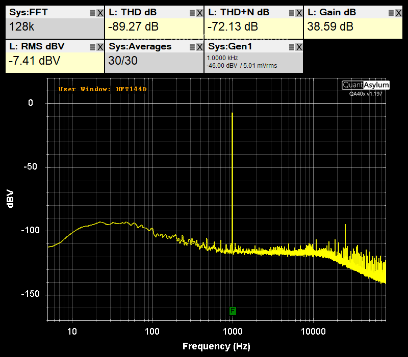

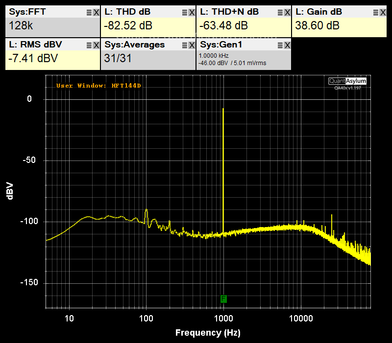

Not the case, here's my measurements for OPA1612 v. NE5534A with 500mH (800 ohms ESR) as the source impedance simulating a real MM cartridge:Problem is nobody bothers to measure it in real circuit conditions.
OPA1612:
Note the big hump across the whole HF part of the audio spectrum - current noise hits 500mH, big rise in noise, basically hiss.
NE5534A:
Perhaps 12dB better at the top end, definitely quieter from about 500Hz upwards. It is difficult using discrete inductors to get this measurement because they act as magnetic loop antennas, this spectrum was recorded mobile, laptop powered, about 1/4 mile from nearest power line / building and still it picks up some interference (more visible than the 1612 case as its not so masked by the chip itself).
Lets redo those noise calculations:
500mH+800R at 3852Hz is 800R + 12.1k reactive = 12.1k impedance.
With 1.7pA/√Hz that's 20.6nV/√Hz, so we expect the 1612 to have about 21nV
With 0.4pA/√Hz that's 4.85nV/Hz, so the 5534A should have total voltage noise of 6nV/√Hz, so should be about 11dB quieter at 3852Hz. That agrees with the plots pretty well.
At 10kHz the figures are 31.5k reactive, 1612: 53nV, 5534A: 13nV, so 5534A should be 12dB quieter, again in agreement with the plots.
Interestingly the 500mH (made from 5 100mH inductors on a small breadboard), seems to be resonant with stray capacitance of the cables at around 16kHz, not unlike a real cartridge.
BTW a good JFET opamp like OPA1652 performs better than the NE5534A at top end, but only just - there's still some hump, probably due to LC resonance and the 47k load resistor's current noise.

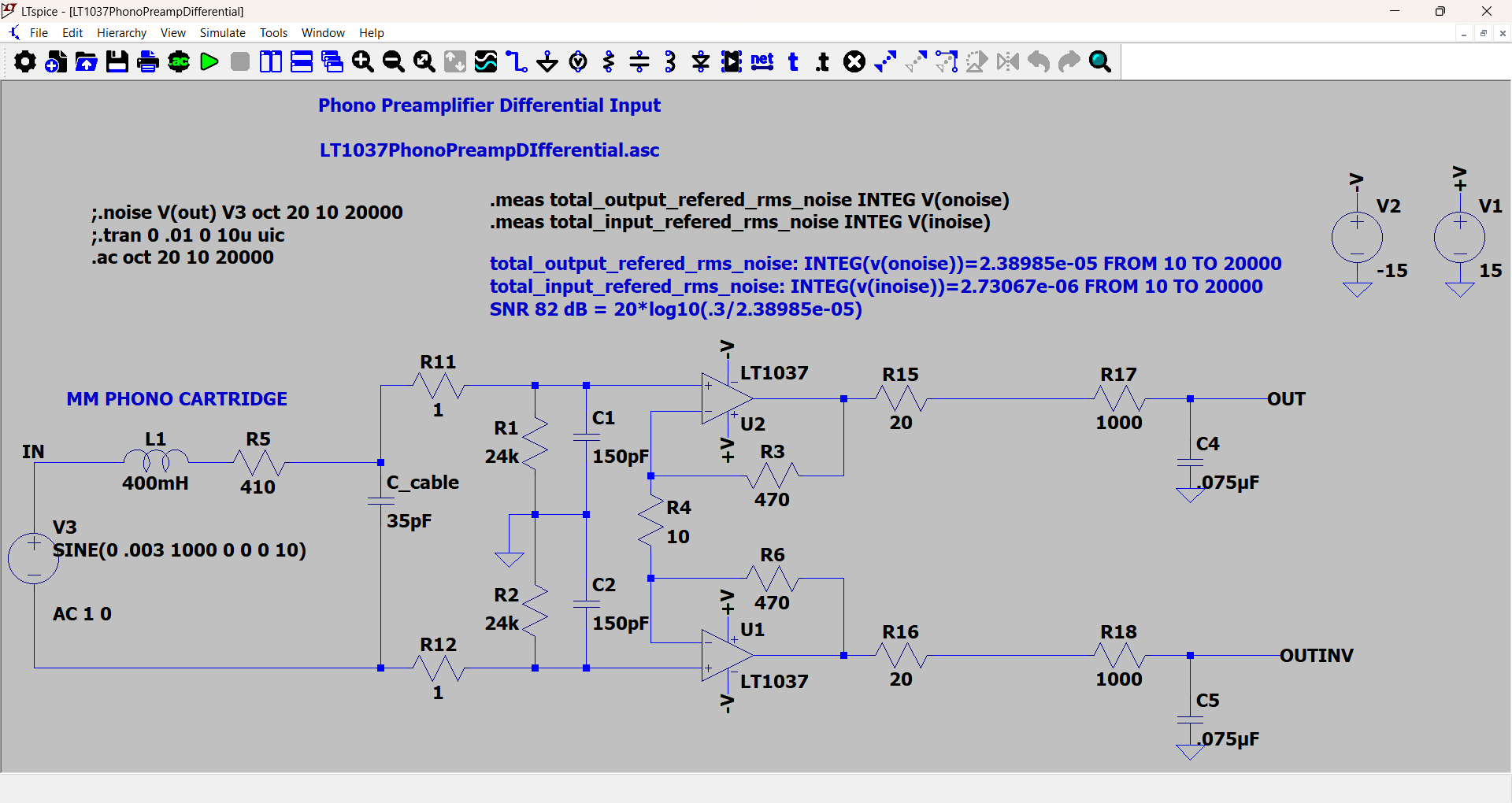

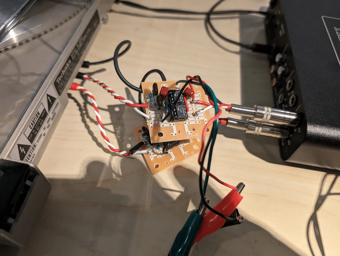

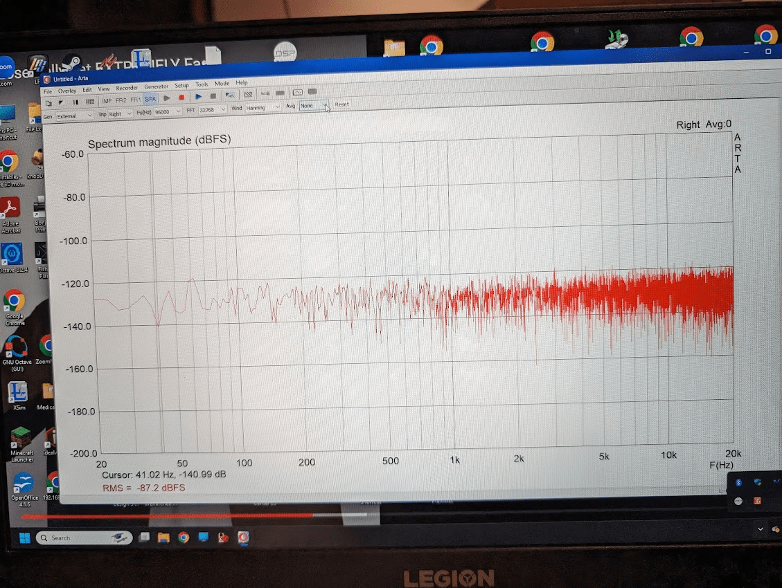

Last week I cobbled together a pretty good differential input flat response phono preamp to use with the balanced line level inputs of my USB interface. I'm applying the RIAA EQ digitally. I found the low current noise LT1037 works well and it is in the 8 Pin DIP package. The 60 Hz line noise comes in right at the noise floor of the preamp, so it really works well. The added spice directives calculate the input and output noise levels and they are found in the output log file. CRTL L on LTSpice opens it. I pasted the example values in blue and calculated the approximate SNR based on the expected output of 3 mV from the cartridge. I use it with the Stereo Lab software from pspatialaudio.com to "rip" records to digital. The RIAA EQ can also be applied using equalizeAPO or other means of DSP filters to play them in real time. I built the schematic below without the 1 and 20 ohm resistors. It actually has a simple RC output, R17 and C4 , network just for the spice model, that produces the RIAA lowpass roll off to get the noise figure a bit closer to what would be there with the EQ added. I attached the spice models for this and a more complex version that actually includes the differencing. The noise measurement was performed with the configuration shown in my basement with the turntable plugged in, using the bench power supply and the laptop running from battery. I forgot to put the 0.5 uF power supply bypass caps in the schematic. With phono cartridge distortion in the .1% to 10% range, preamp distortion isn' t the major challenge.

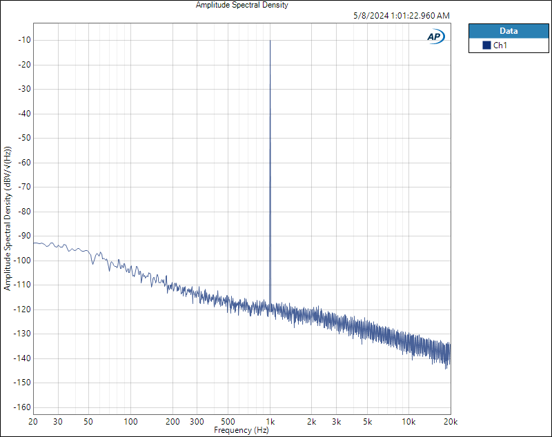

Yes real people do measure real circuits. See the plot attached of 3 OPA1656 in a Bugle clone by Audiowind A-300 ($40 on line)
A AT91 MM cartridge is in the mail to measure the real circuit with a real MM cartridge.
