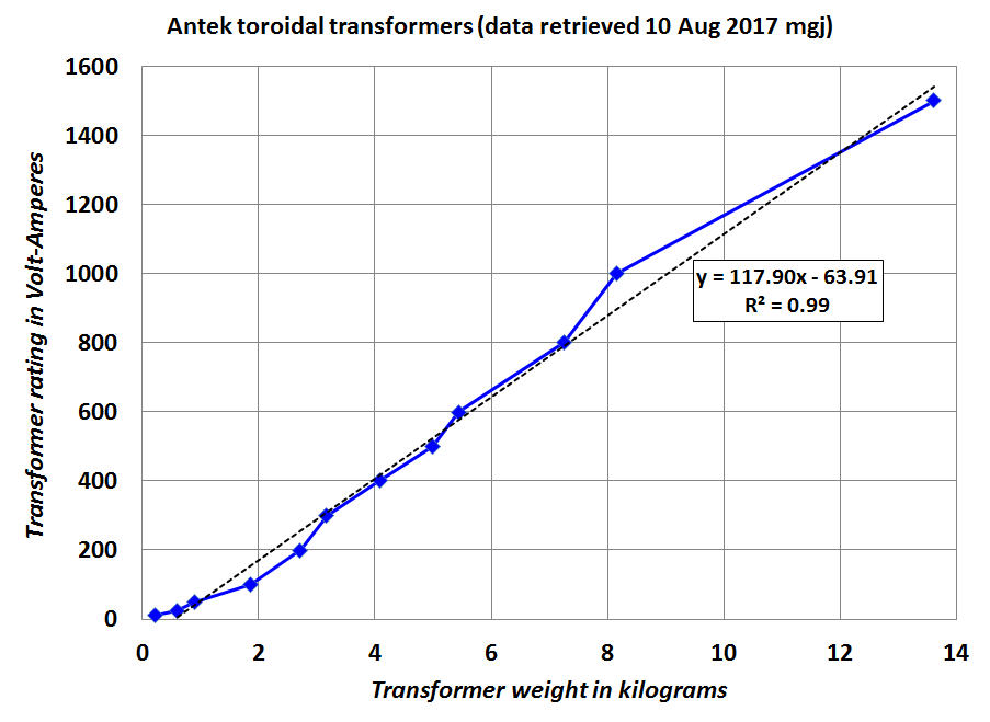

I recall that Bob Cordell's power amplifier book suggested that one way to estimate the Volt-Ampere capability of a transformer is: weigh it! He gave a rule of thumb value
such-and-such number of volt-amps, per kilogram.
Sorry I don't know the page number; a super motivated individual might quickly read through all sections that discuss power supplies, and find it.
Anybody who wants to learn more, can visit transformer manufacturer's websites and find data for VA ratings and weights. Then simply type the data into Excel and find out whether or not the data exhibits a straight line relationship.
To show that I'm not a lazy person (this morning!), I did so on the website of Antek Inc. My results are below.
Those who distrust linear regression can, of course, eyeball-interpolate between entries in their data table.
