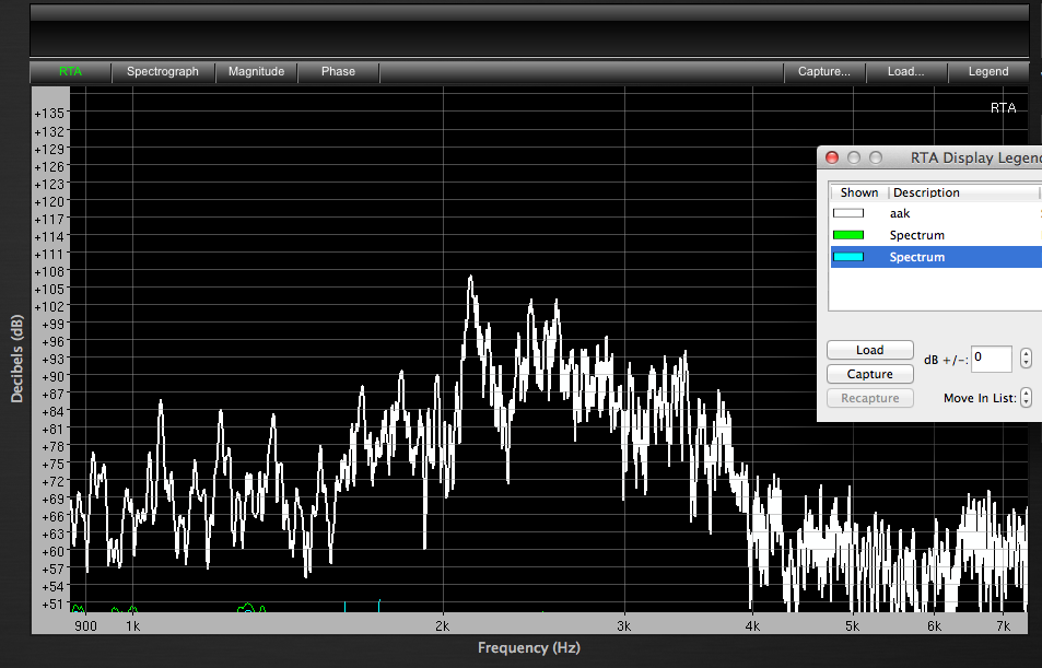

I would (as you already did) guess you're hearing an emphasis 500-1000Hz, based on the "ack" description.
I see more 2.25 to 3.5K "ack" but maybe I pronounced it wrong for my test 😉.
Ha, that's the spectral content of you saying "ack"? Brilliant. The strong upper mid content is what defines the consonants, and I was interpreting the hard AAAAA sound as the key, as in "back rattle blat clatter crack". I have no idea if the spectral content of people saying "AAAAA" (not to be confused with "AHHHH") looks like a lot of 500-1k, I just know speakers sound a bit clatter-ey to me with that.
